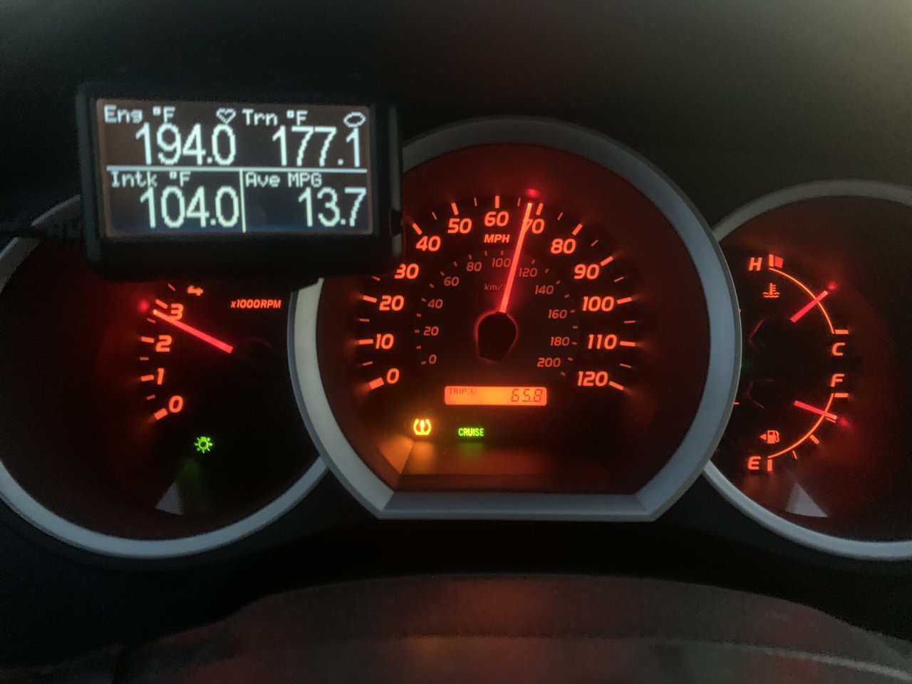

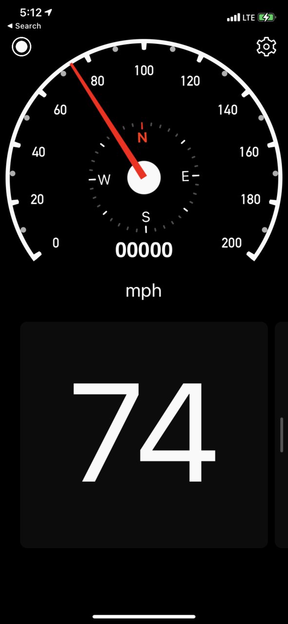

    Gotta love this. 74MPH on the satellite gps app and not even 3k RPMs on 35’s. That’s full of camping gear and going up the I-17. 4.0 v6 5spd AT

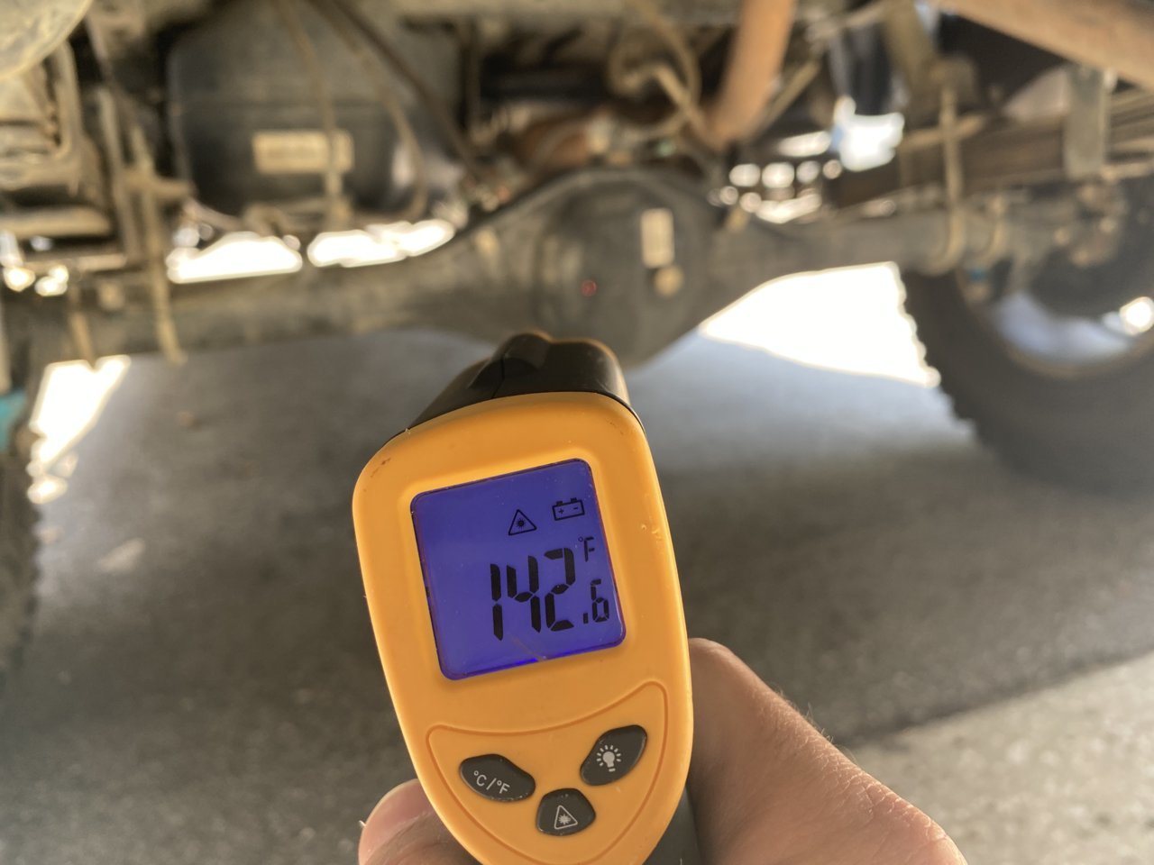

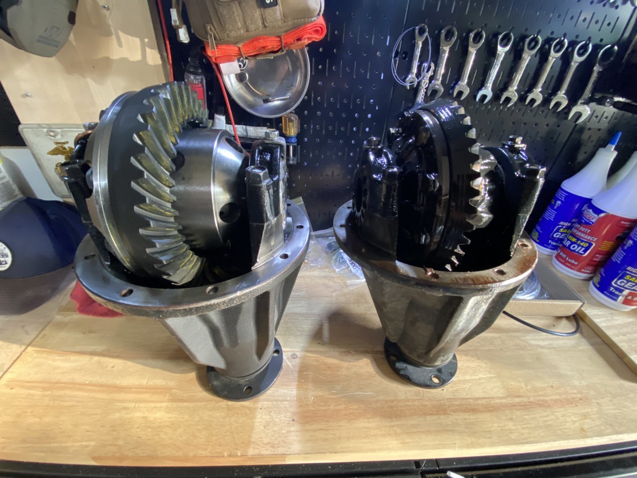

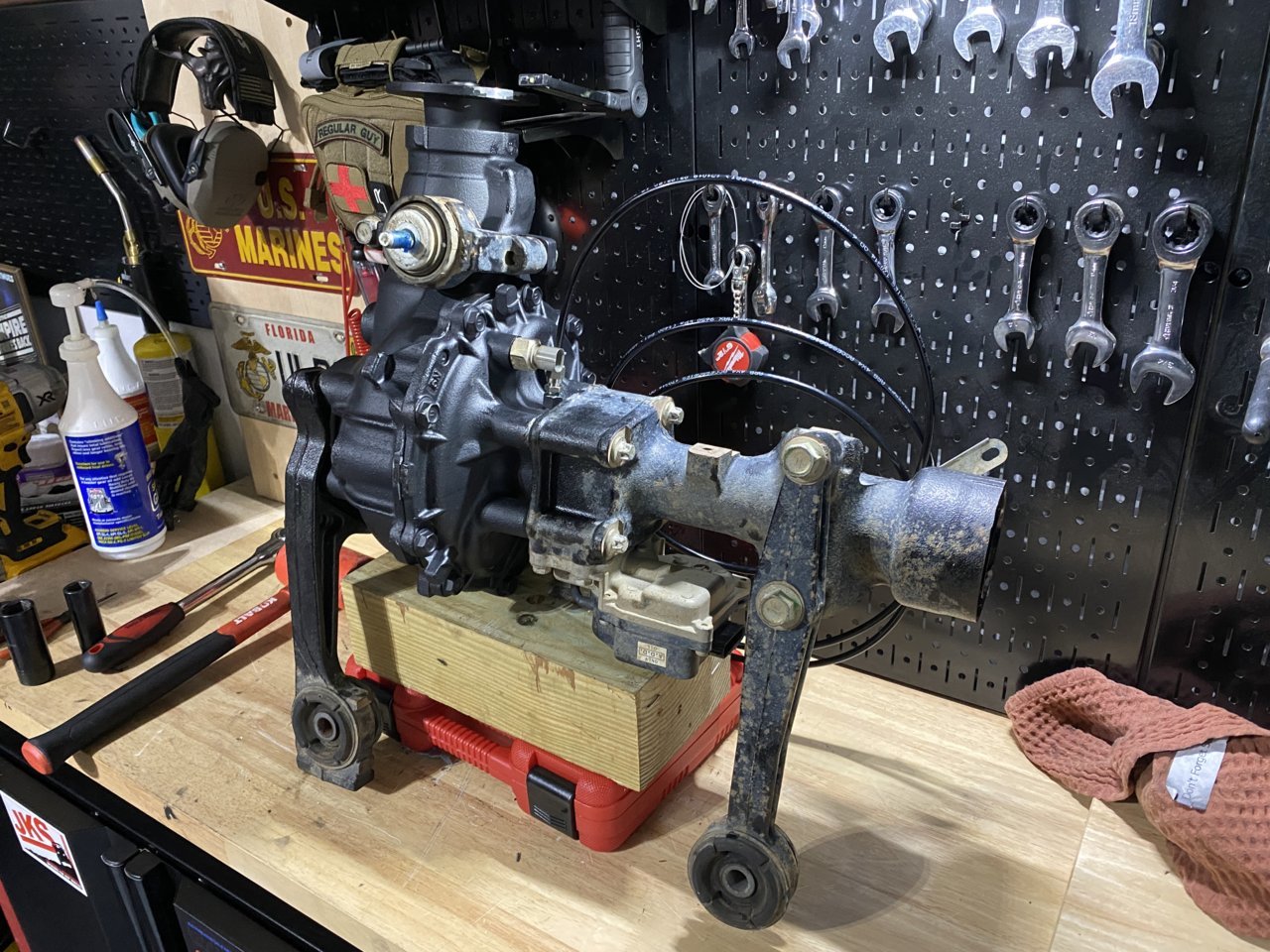

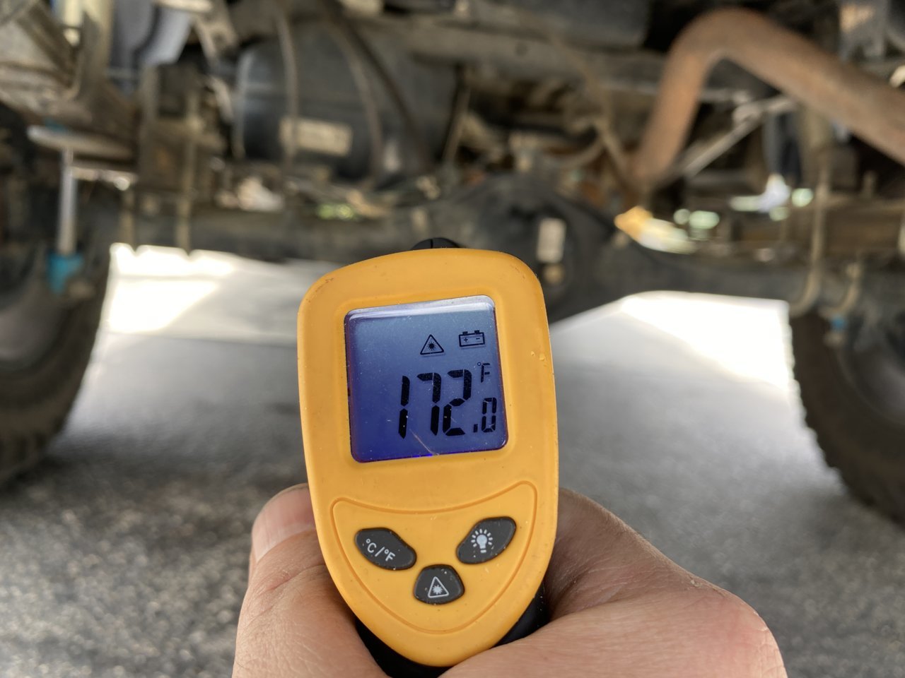

    I just finished my install of 5.29s this weekend. Took my first drive to the gas station which was within 5 miles, about a 4 minute drive with traffic. Initial thoughts were why did I wait so long, it feels like nice clean shifts right through the lower gears. I also took a quick temp reading at the diff. It came back at 142. I plan to do a follow up video after the ECGS 500 mile break procedures where I will be monitoring temps in comparison to what I was getting stock which was between 98 to the 140s. I also realize I'm getting the temp from the exterior and with a less than professional laser measure, but it is something to compare. So far the highest I have seen while running errands on Saturday was 172. Here are a couple pics, cause you know everything is better with pics. The front diff was so much worse than the rear.
    First reading geared at the gas station.
    2nd reading geared after errands some highway with stop and go driving.
    Random install pics. I will have videos of the instals up on the channel soon. There is a ton of footage and editing to go through.

    I just switched to 4.88. I'm on my fourth heat cycle. My last trip was about 16 miles of highway and I was getting 179*f with my laser deal. I wish I had thought to measure normal temps before swapping, but I would guess it's all good below whatever temp starts damaging the oil..... Whatever that is

    You are holding that temp sensor too far away IMO. It does not measure temperature with the laser. The laser is just a pointer to help you determine what you are looking at. There should be a diagram on the side of the temp gun, or in the manual, that tells you how big an area it is averaging, from how far away. This is sometimes called the ‘measurement cone’. If that gun is beyond its “measurement cone” you are averaging everything in the field of view and we’ll get a lower temp reading as a result. If you know this all already, I digress. I have a Fluke version and it would be measuring a 2 foot wide circle at the distance it appears you are at.
