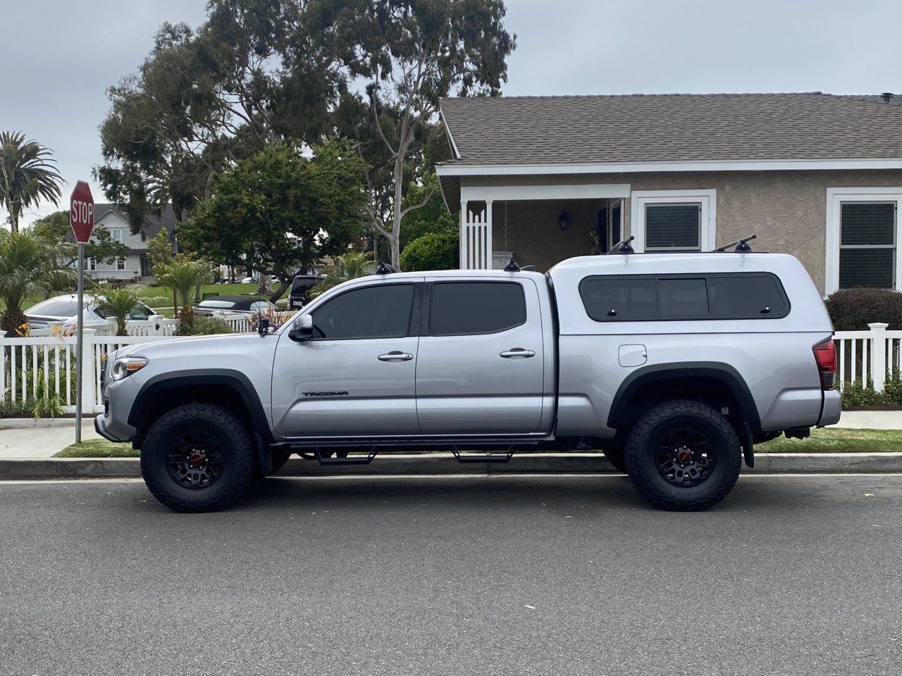

  15. Jun 3, 2021 at 6:32 PM
    #3495
    Bajasurfer4X4
    Bajasurfer4X4 Member
    Jun 3, 2021
    #367573
    6
    Justin
    2019 TRD Off Road Double Cab
    33' K02, 3' Bilstein 5100 lift, High Topper Snug Top
    2019 TRD OR - Looking for advice on what gears to Run 5:29 or 4:88? Mostly a daily driver but do a few big trips a year fully loaded stacked with surfboards and a RTT, Also do some road tripping open highway driving unloaded and would still like be able to cruise 80MPH + and not loose too much top end. I have a 3' lift w/ 285/75/16 KO2 , gas Mileage around 13 MPG unless I drive conservative. Feedback appreciated!
    ForestRnR and flacoloco like this.
  16. Jun 3, 2021 at 8:00 PM
    #3496
    technicoloraudio
    technicoloraudio Well-Known Member
    Mar 29, 2021
    #361004
    72
    Evan
    Cary, NC
    MBM 2021 TRD DCSB Sport
    Fox Performance Elite 2.5's with 650lb eibach springs and deaver stage III's, URD Y-pipe, Desert Does It all around, ARB Twin, RCI aluminum skid plates, Westcott sliders, UpTop Alpha roof rack, SSO slimline plate front bumper, BAMF hgih clearance rear bumper, hella gummy bears (strictly Haribos, none of that weak-ass Trolli bullshit).
    What are the downsides of regearing before upgrading to larger tires? I’m in a 2021 DCSB with sliders, full skids, bed rack, incoming roof rack, and few other weighty items on order (RTT/bumper/winch). My daily commute is short, and my intention is to do a lot of weekend beach camping/fishing (weeeeeighhht).
    I live relatively close to ECGS, so I reached out to them about regear and front and rear locker install (seemed to be the most cost effective to do it all at once), and they told me they could get it done much earlier than I expected (much to my wallet’s chagrin). I kind of assumed it would be a while, and more of that heavy stuff would be on the truck by the time I did it, but if there’s no reason to wait I might move forward with it.
  17. Jun 4, 2021 at 3:42 AM
    #3497
    Texoma
    Texoma IG: Triple C Chop Shop
    Feb 1, 2011
    #50374
    18,966
    Chris(Topher)
    Lago Vista, TX
    10 Taco 4x4
    A bunch a cool stickers, a bada ass MetalMiller Tx Longhorns grill emblem painted Hemi Orange, JBA long tube headers with o2 sims, Diff breather mod, Red LED interior lights, Fancy head unit that plays ipod n movies, Also DIY install factory stuff like, factory cruise control, factory intermittent wipers, OME nitro struts with 886x springs and toy tec top plate, JBA high caster UCA's for better alignmnet and dey beefier too, Old Man Emu Dakar leaf springs in da rear with the gear, U bolt flipper, Ivan Stewart TRD rims with 33" K Bro 2's, some bad ass weather tech floor liners so I don't muck up my interior, an ATO shackle flipper for mo travel in da rear wit the gear, also super shiny Fox 2.0 shocks back there too, all sorts of steal armor for bouncing off of the rocks like demello sliders, AP front skid, trans skid, n transfer skid, demello gas tank skid, and a tough as nails ARB bumper with warn 8k winch, I'm sure there's more
    It'll be fine
    Bumble Bee Tuna likes this.
  18. Jun 4, 2021 at 3:52 AM
    #3498
    jbjones85
    jbjones85 Well-Known Member
    Mar 28, 2021
    #360855
    83
    Josh
    Newburyport, MA
    I have similar thoughts ( in Raleigh myself). Will eventually end up on 33 or 34 tires but also tow a travel trailer so was thinking of gears before lift /tires. Talked to the guys at ecgs and they said 5.29 given the end goals but said top end will be limited with stock tires during the process. I heard that the kdmax tune can help with that setting but can not confirm as I have not reached out to them directly.
