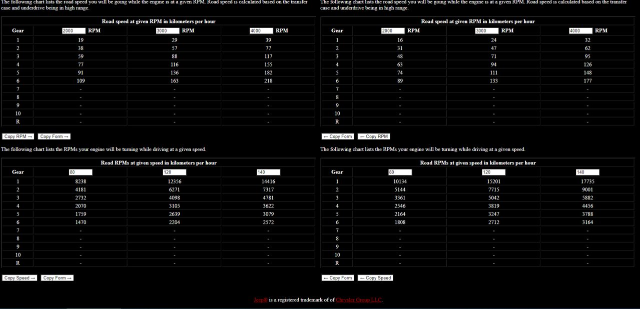

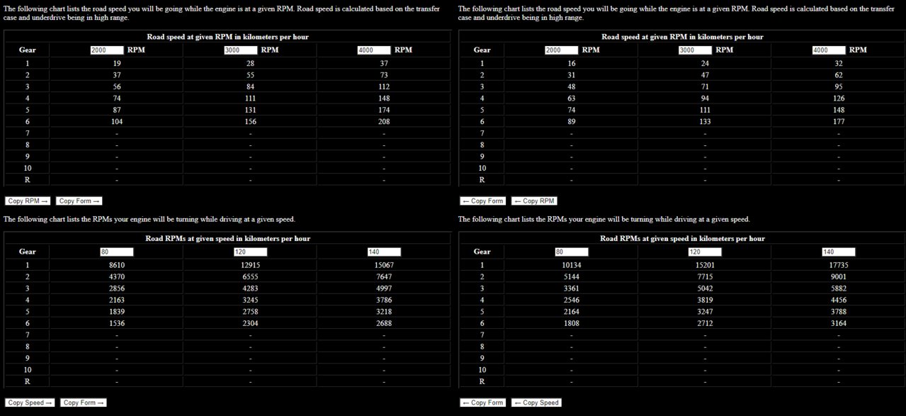

    -Bilstein 5100's EXT + 886 OME coils -Bilstein 7100 14"SB shocks -Camburg Uni ball UCA's -BAMF leaf hanger & shackle -BAMF shock relocation kit -Dakar HD leafs -U-bolt flip kit/super bumps -TRD PRO SEMA rims + 255/80/17 Ridge Grapplers -Cali Raised Led 32" hidden light bar & switch panel - Backflip tonneau -Demello tube sliders -Mobtown skid -TRD Pro grill -Custom bed rack -OVT 2.0 SFOB Tune -2WD Low mod -Kicker CS Speakers
    Hey Everyone, there is so much info here and obviously most relates to the A/T guys based on the masses. I seen a few posts stating the 5.29 gearing to too low for the M/T crowd. I did the calculation (KPH sorry down south)with stock 4.3 to 5.29 on 35's and the RPM's don't seem that excessive, especially when you consider the 3.5L engine makes most of its power/torque above 2500-3000 rpm anyways. I understand why highway driving might take a MPG hit but other then that is the 5.29's on a MT that out to lunch? below are 2 graphs showing 4.3 to 5.29 gears both on 35's and my current setup 33's to 35's.
    4.30 Gears to 5.29 Gears on 35's
    4.30 Gears on 33's to 5.29 Gears on 35's
    RELEASE THE HOUNDS.
    Any first hand experience from the MT crowd might be appreciated.
