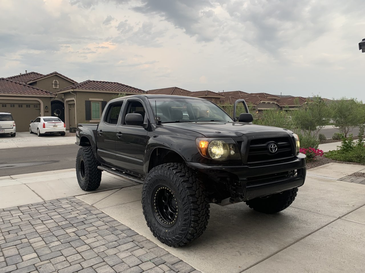

    My 5:29 have been pushing my POS around town with newly mounted 37’s on beadlocks and the truck isn’t cumbersome or a pain to drive. With my 4.0 and 5spd AT the truck actually doesn’t really miss a beat around town. Averaging about 14.3 city mpg, so stoked on these gears.

    Damn 37s look mean. Love it

    Love it!!! Proper.
