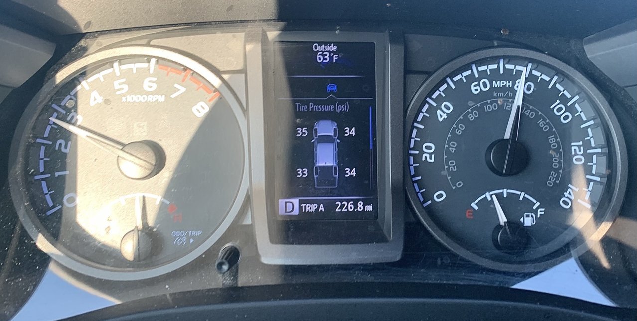

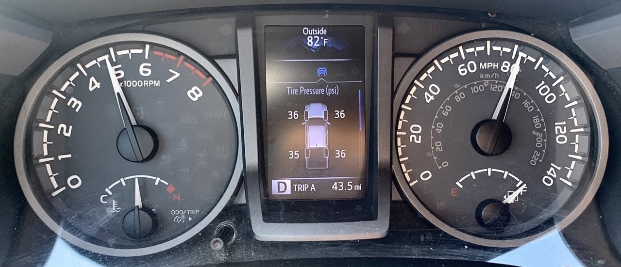

    How can i overcome this 80mph limit?
    5.29+33s.

    Push down on the accelerator

    Pedal all the way to floor = around 83mph

    2021 TRD OR
    Does it feel like it cuts engine power when it reaches this speed?

    Yes sir.

    Probably a governor in the ECU tune. Did you get it tuned to accomodate 5.29s+33s?
    Do you know the gear and approximate RPM youre at when you hit this speed? Could also be a gear limit since youre on 5.29s+33s

    No aftermarket tune. I did get Toyota TSB-0062-18 few years ago.

    Might want another opinion, but it sounds ECU-related, which means you just need a tune for your new gears;)
    Can't say for sure without a data connection to your truck

    You need a tune to exceed that speed limiter. And the tune has to actually have that modified. Are you in Colorado? I could flash for you.
