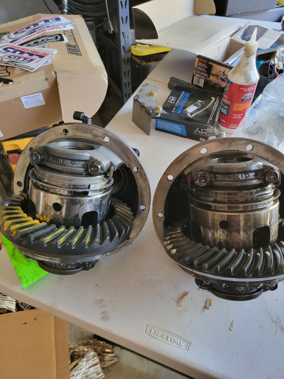

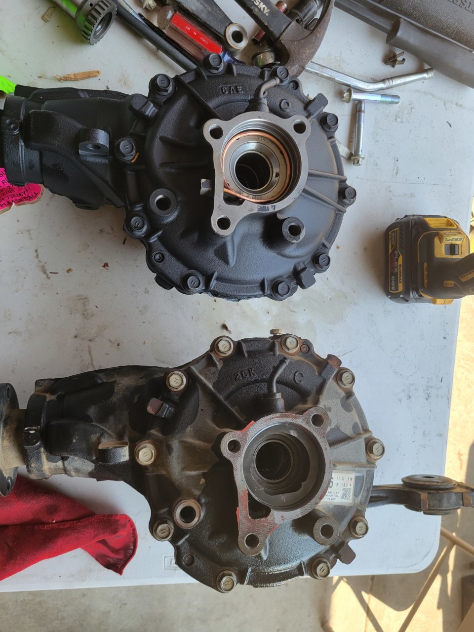

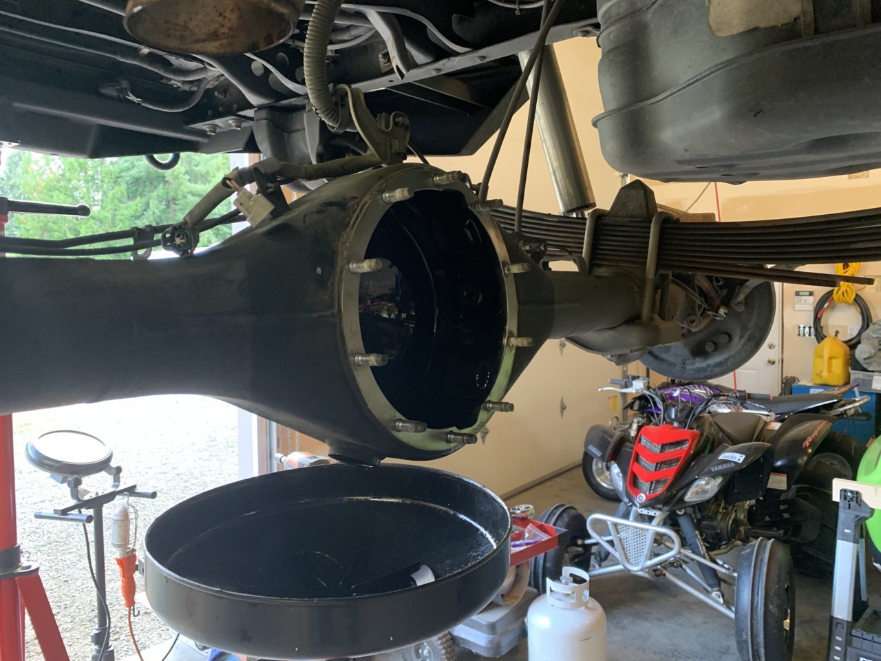

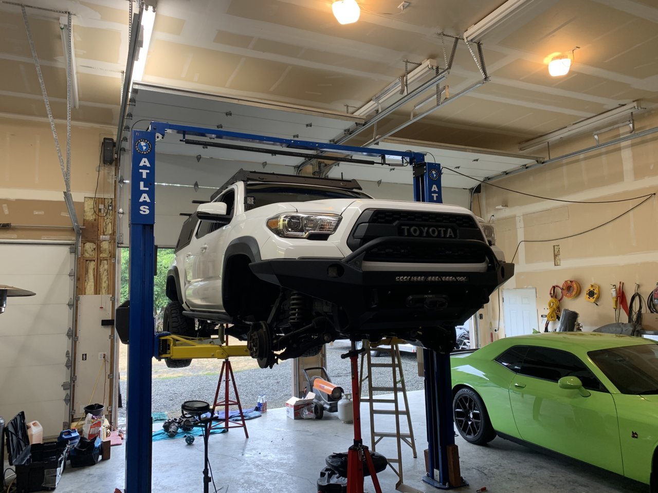

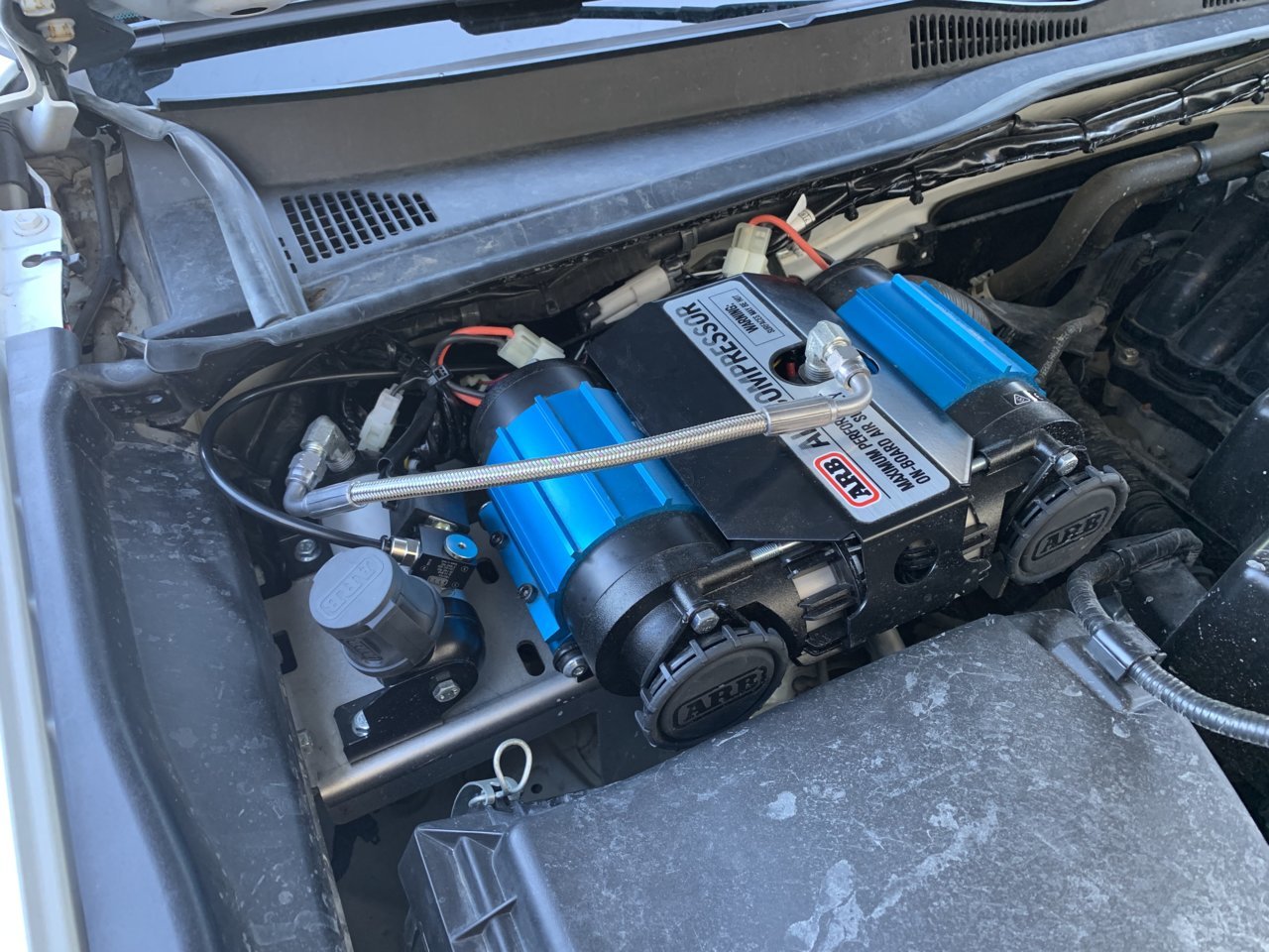

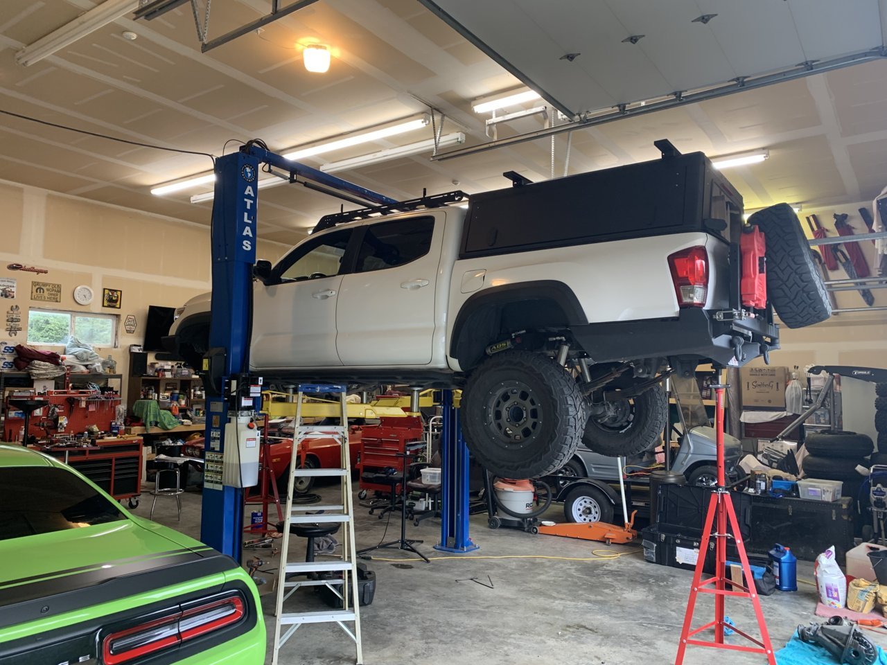

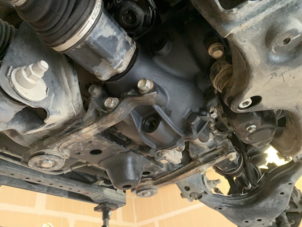

    I finally had a chance to get everything from ECGS installed. Went with an ARB locker up front. Took around 6 hrs total, so not to bad. Definitely helped that my friend has a lift! Pretty happy with how it drives now. Just need to get through the break in period so I can really see how it does.

    Very nice, jealous of the garage space.

    This. The camo moving blanket, toys, lift........ahahhahahaha but mostly the ARB port cover!

    Nice man. I still have over a month of waiting left before mine will be done at Mule. I'll have to check your rig out sometime once you break it in. I'm up next to Lake Wilderness.
