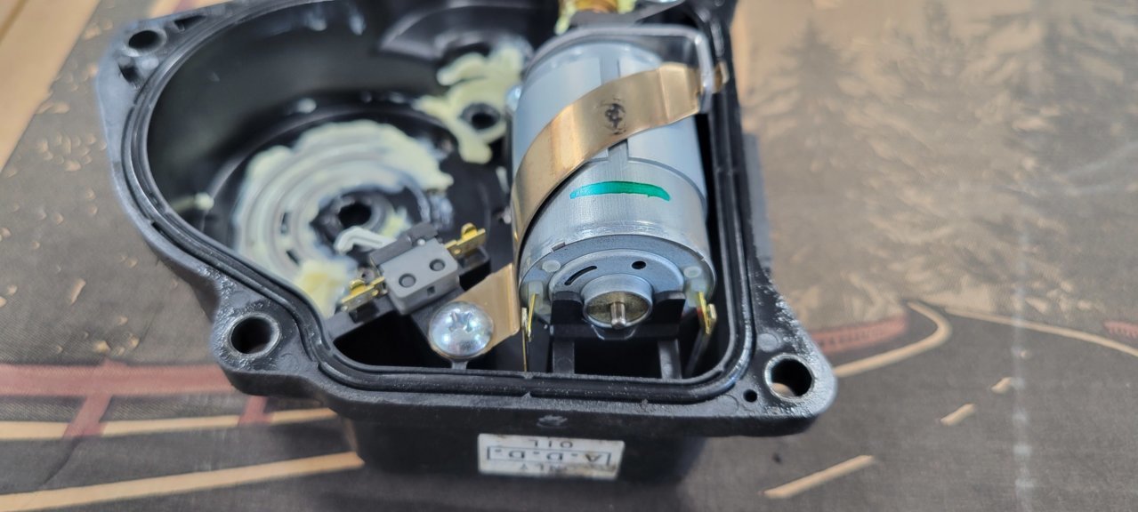

    HELP! I"m having 5.29's installed on my 2016. It's been in the shop for a week now and the rental car is getting expensive. I took it to a place that specializes in differentials and gears and they have done dozens of these changeovers and came with high recommendations. However, they have hit a snag. The tech is getting a "2WD to 4WD shift failure" message on the dash notifcations. Which means something in the electronics won't allow it to be shifted into 4WD. They are currently baffled at the solution. Anyone here ever encounter this? I can't afford the rental much longer. Just my luck! :(

    If it wasn't doing it before, then it can only be related to them removing the front diff. There is a wire connector going to the ADD actuator and another going to the diff temp sensor. I would check those connections 1st, make sure they're plugged in all the way. If that doesn't resolve it, there may be a broken wire. Have them pull the harness and ohm it out.

    They more than likely forgot to unconnect a wire and stretched somewhere. Either that or they forgot to plug it back in, which seems unlikely. They need to check it with a multimeter to see if it's getting proper power. Also there is a vaccum line running to it that needs to be connected.

    It's not vac, just a breather. It wouldn't make a difference to the 4wd engagement. It will however make a difference once shit starts getting wet. I think that it's most likely they didn't disconnect the harness and they stretched a wire. Pretty common with the speed sensor lines to do that, and I imagine the lines going to the ADD are probably just as fragile.

    It was inside the ADD. One of the metal contacts for the motor had become disconnected. Couldn't tell visually but you could slip a piece of paper in between the tabs. Resoldered and back on the road. Thanks everyone. I hope this discovery saves someone else the headache

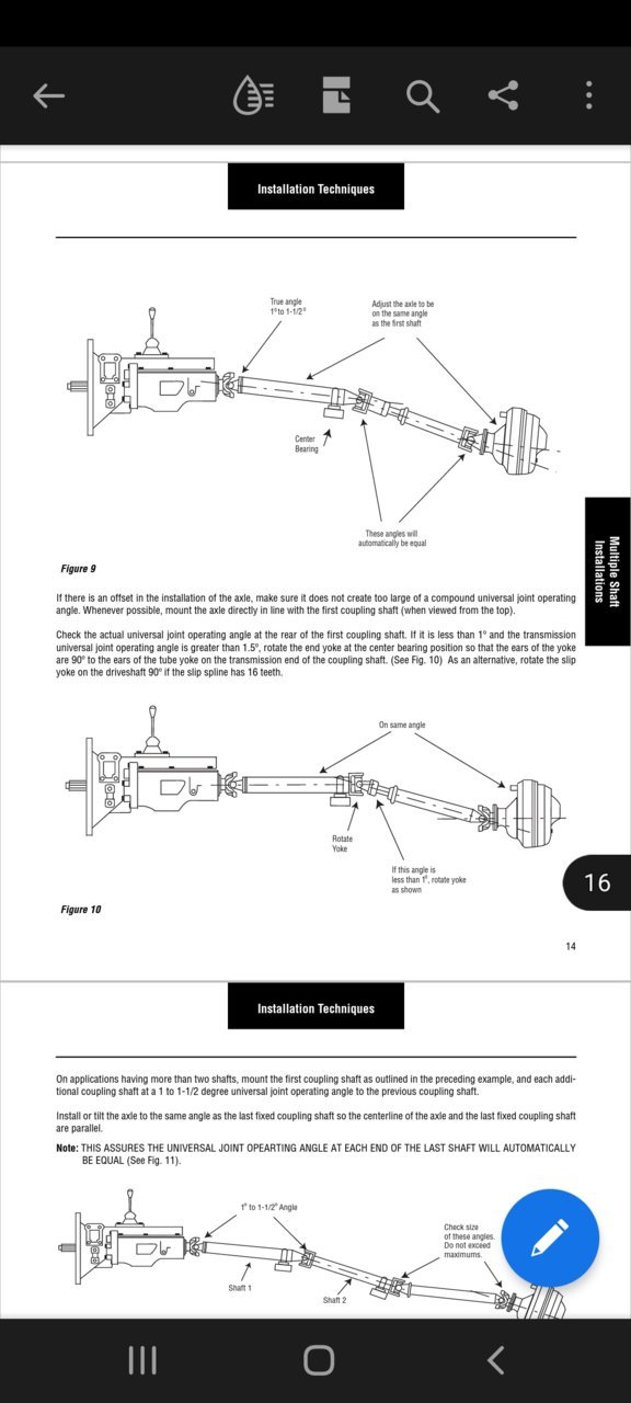

    I have that going on too. It didn’t happen when I first had the gears, it came about after my lift. I am guessing that it’s my pinion angle.
    I don’t t think it’s the gears making the noise but more of a harmonic sound when your angles get a bit out of whack.
    I am going to do some measurements, maybe order some shims and will report back.
    skeletron[QUOTED] likes this.

    #50374
    18,966
    Chris(Topher)
    Lago Vista, TX
    10 Taco 4x4
    A bunch a cool stickers, a bada ass MetalMiller Tx Longhorns grill emblem painted Hemi Orange, JBA long tube headers with o2 sims, Diff breather mod, Red LED interior lights, Fancy head unit that plays ipod n movies, Also DIY install factory stuff like, factory cruise control, factory intermittent wipers, OME nitro struts with 886x springs and toy tec top plate, JBA high caster UCA's for better alignmnet and dey beefier too, Old Man Emu Dakar leaf springs in da rear with the gear, U bolt flipper, Ivan Stewart TRD rims with 33" K Bro 2's, some bad ass weather tech floor liners so I don't muck up my interior, an ATO shackle flipper for mo travel in da rear wit the gear, also super shiny Fox 2.0 shocks back there too, all sorts of steal armor for bouncing off of the rocks like demello sliders, AP front skid, trans skid, n transfer skid, demello gas tank skid, and a tough as nails ARB bumper with warn 8k winch, I'm sure there's more

    That's interesting. I had the lift on before the 5.29s and there weren't any harmonic sounds at that point
