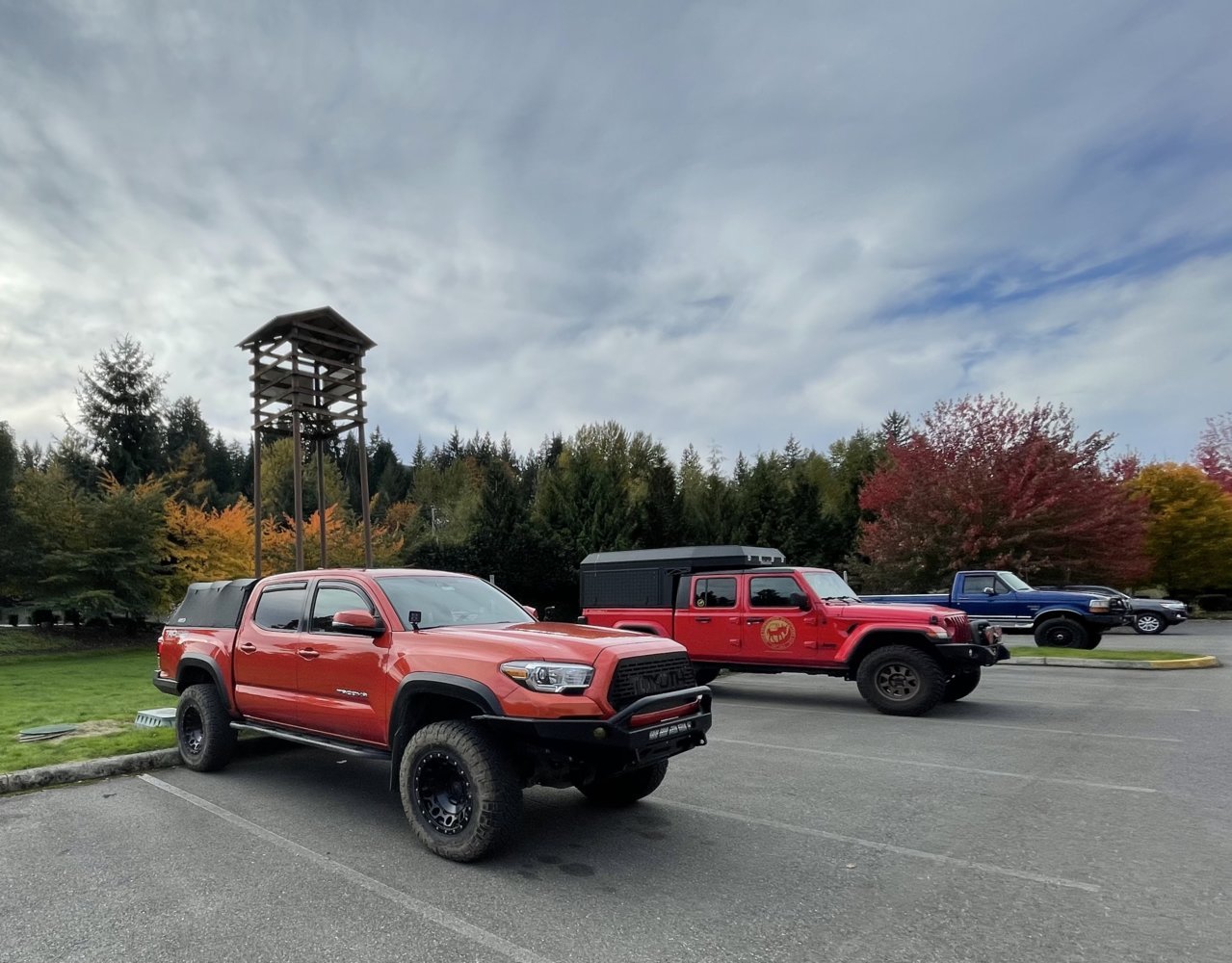

    Picked up my truck today. Nitro gears, no howling or whining so far. But I haven't gone past 60mph as I'm still breaking them in. Big difference going up hills so far. That being said, anyone on 5.29s and 37s here? Does it feel like it was before regearing?
