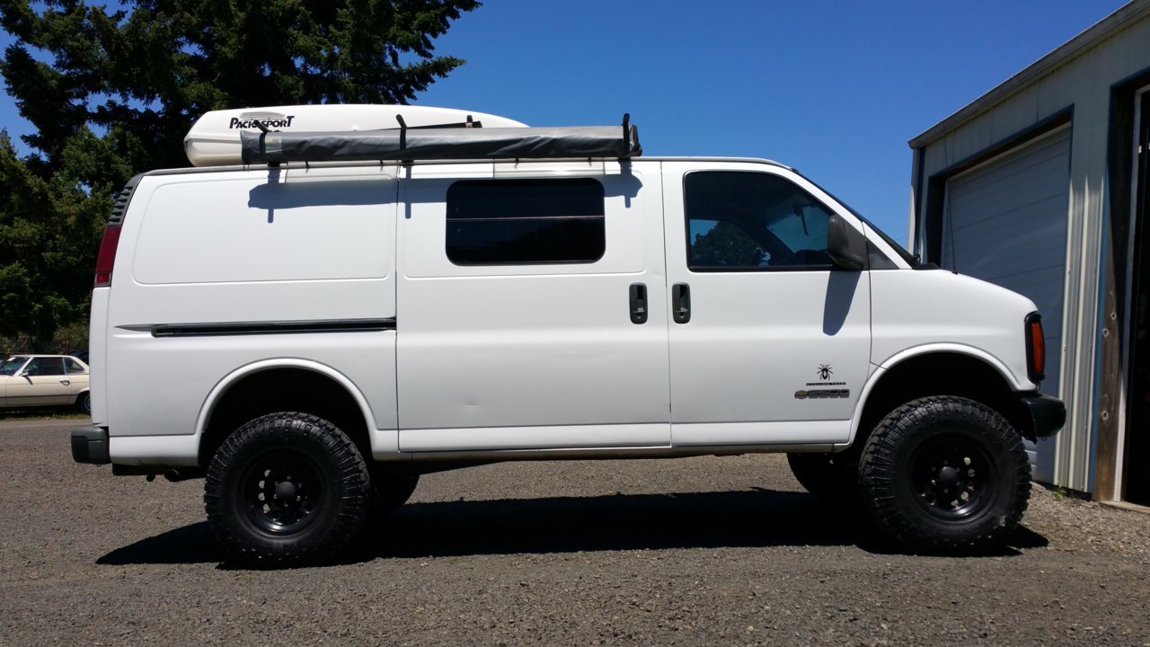

    I was dealing with a problem child a few years back. Not a Toyota but a 1997 Chevy Express Van 2WD that I lifted 6" with 35" Dura-Tracs. My savior was downloading this app on my phone. It allowed me to check 3 angles. Once the App showed me 3 green figures I got it dialed. The App is called "TREMEC Tool Box" I unbolted my u-bolts and tried different shims plus raised and lowered my tranny about 15 times until I got it completely dialed in. What a pain in the Ass. Prior to me doing it I called about 10 Transmission shops and Off-Road shops and no Van5.jpg
    one was willing to take it on to make it smooth. Good luck.

    Exactly. Takes time to dial it in. I put a scope on the diff and TCase. Noise isn’t coming from there…definitely all the angles combined are making a “tuning fork” of sorts. My buddy that owns an LC is playing with shims for me.
    Love the van bro! Killer. I’ve had a sportsmobile.

    Good luck in finding it. Too bad it takes so much damn trial and error. We wanted a Sportsmobile but didn’t have enough money at the time so I built this and put a locker in the rear. Did ok but was a bit sketchy driving over snow/ice covered mountain passes. The Taco loves sketchy mountain passes.

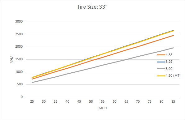

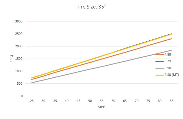

    This thread has so much valuable information! OP has put some excellent data points. While numbers tell the actual story, I understand better in graphs. So given the same information provided by OP and the RPM Calculator available on Nitro Gears website, I created these two graphs: one for a 33" tire and one for 35" tire. Each graph compares RPM values for the following:
    1. Automatic with 3.90 Gears (Stock)
    2. Automatic with 4.88 Gears
    3. Automatic with 5.29 Gears
    5. Manual with 4.30 Gears (Stock)
    At first glance, you would expect the RPM numbers for the MT truck with 4.30 Gears to be somewhere between #1 and #2 but due to the different final drive ratios on the 5th and 6th gear between the AT and the MT, the RPMs line up almost exactly with #3!
    In fact it is so close, you can barely see the Blue line for 5.29 in the graphs below.
    So basically a 5.29 geared AT truck is the same as a stock MT truck!! :eek:
    My takeaway from this exercise - that even with 5.29 on 33" tires on the Automatic, I'll still be in the same ball park RPM figures what Toyota thinks is suitable with the Manual Transmission truck. Am I wrong?

    Your are correct. My truck does not scream RPMs with 33s. Drives much better than it did without gears.
