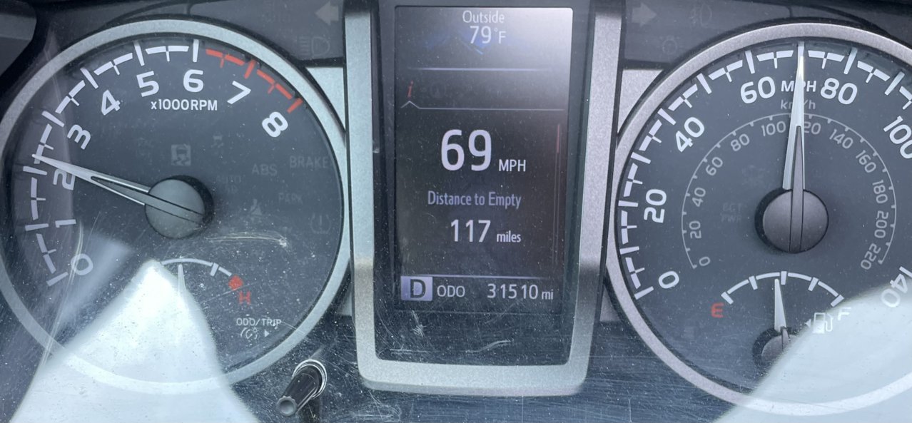

    I'm not sure what your expectations are but I'm pulling about 2200RPM @ 70MPH. That seems more reasonable gearing than stock gears/tires to me since this brick in the wind needs a few extra RPM to push it at highway speeds. Before regearing, 6th gear was basically only useful going downhill.
