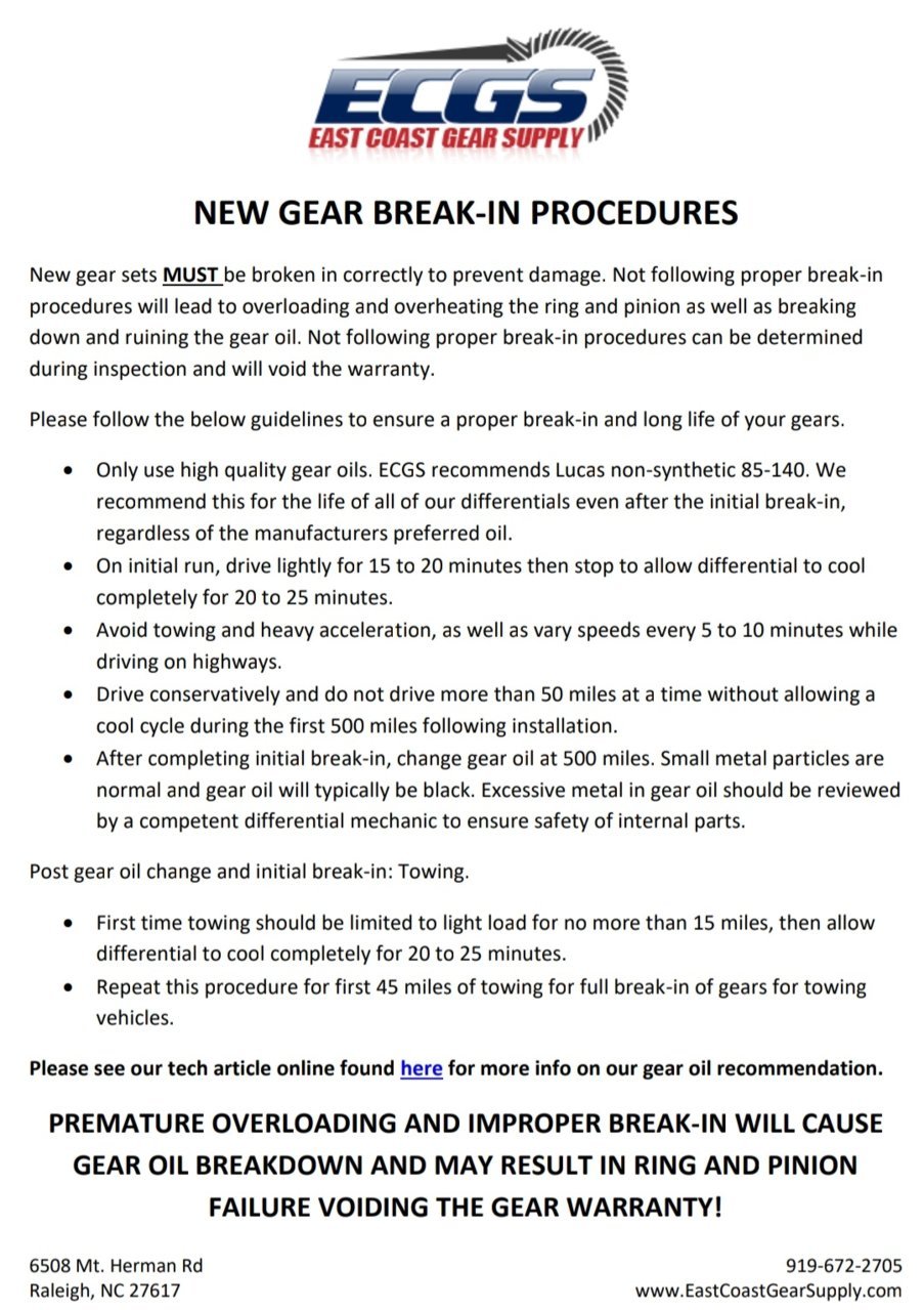

    What're folks thoughts on REM polishing for skipping breakins? SDHQ and my local shop are 6+ weeks out with REM polishing but ECGS can ship today, I'd just have to suffer the break in. The break in is a little rough since my truck isn't my daily driver -- it's only ever used to wheel and shuttle mountain bikes to some out of the way trailheads. But ECGS told me they don't think REM helps and I should break it in anyways. If I really should be breaking it in anyway I'll bite the bullet and order from ECGS, I guess.

    The break in procedure is no big deal. I vote no REM polishing.

    I did REM polishing because gear legend ZUK sold me on it. It did not affect my lead or turnaround time & IIRC “it can really strengthen and smooth out the gear contact”. I personally would never skip a break-in even though I was told I could. Break in will be over before you know it and only takes a minute to flush the rear diff. It’s one of the easiest tasks in all of Tacoma mods. My vote would be for rem polishing because of increased strength and durability

    My truck is also my DD and also mtb shuttle truck at times. Break in isn’t a big deal, man. Just vary the speeds you drive and take it easy - don’t sit at certain speeds too long. Basically - stay off freeway interstates or whatever. It’s fine

    I'm all about "increased strength and durability", but when ECGS tells me it doesn't do anything (they said the same for cryo) AND they're putting their money where their mouth is with a 5 year warranty, I'll skip it.

    I think this is where I've landed. I'll suck it up and do the breakin and skip the REM/cryo.
    Thanks all!

    Pretty sure the only restrictions I saw on the warranty were completing the break in period and tires limited to 35"
