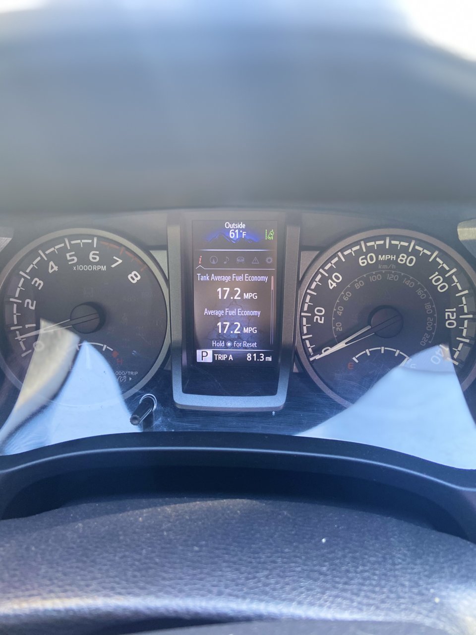

    Ok, been on the 5.29’s for almost 800 miles. Got my flush done today. As of now, I’m seeing +\- 4mpg increase over stock on fallen wildpeaks 285/75-17.
    no gear hunting. Smooth, linear excelleration. Stays in 6th almost all the time. Can excelrate nicely in 6, pass in 5th. Barely ever sees 4th on the highway.
    shout out to Stellar Built in Sacramento. Full service install, included all lubricants, 500 mile flush, inspection and refill. 2 day turnaround and great service as always.
    taken today.

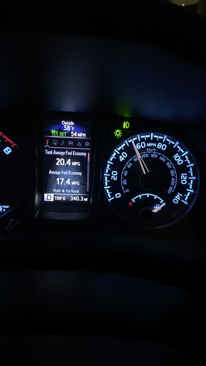

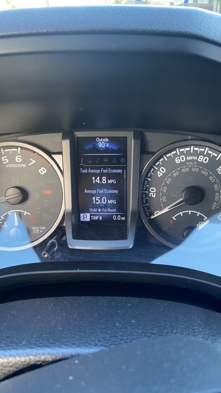

    I should have taken a pic before the the regear, but I was always hovering in the mid 14mpg to low 15mpg. So overall, its 3-4 mpg better. When I take my drive up to and back from sacramento, it tops out around 18.5-19 mpg with the constant cruise control function set somewhere between 65-70. I do have a KD Max tune, but have not had it retuned yet for the gears, tires and cai. I run mid grade all the time, but have the option to run the shit 87 here in california a the tune will adjust overtime for the octane change. All in all, the reger should pay for itself in gas in about 18mos.
    Its was steep price, no doubt, but even with the non-updated KD Max tune, there is 0 gear hunting, even when I use the adaptive cruise, which puts the truck into the OEM tune. it stays in 6th most of the time, and can easily pull up a hill in 5th now. I love it, this is how the truck should have driven from the start.
    just found this pic from about a week before I had the regear.
    This was from the drive home the very first night. Of course this was the break in period, I was keeping it most at 55mph. And the I confirmed with a GPS tracker, my speedo off by -3. So 52mph = 55mph.
