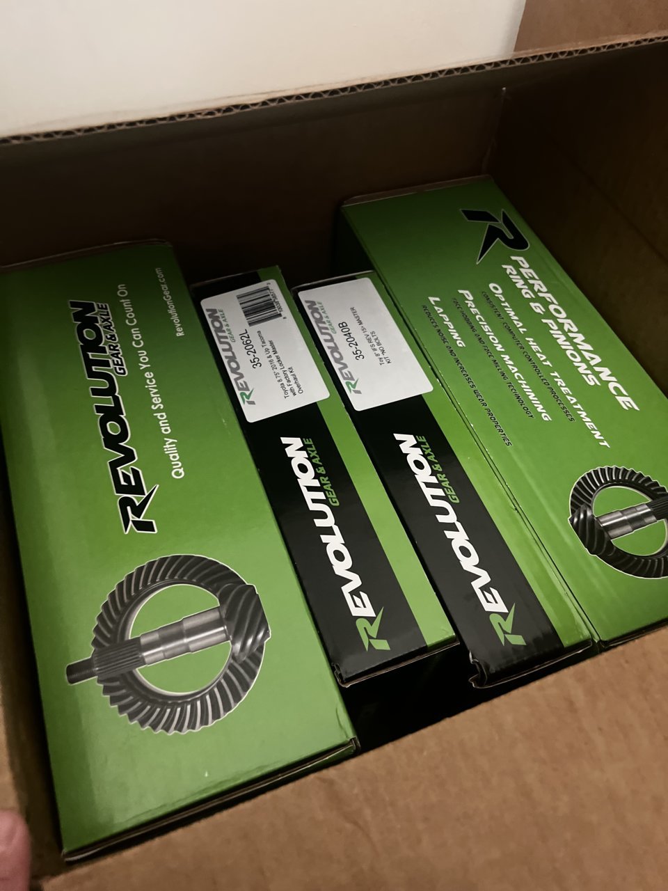

    #94017
    1,397
    These arrived today. Not installing until spring time but they were in stock and on sale for Black Friday. Had to pull the trigger. Now I have to keep an eye out for an Eaton for a good price. Will drop them off for REM and Cryo when I have time after the holidays.

    Give ECGS a call..

    It's a good idea to call ECGS and speak to them directly. They will walk you through the process, they are not pushy and will give advice on which direction to go. They are a reputable shop with a long history. I have the clamshell installs from ECGS front and rear on my YT channel so you can see the process if you'd like. Its not terrible, the front diff is more complicated/ time consuming but nothing ridiculous. Rear diff is maybe a 2-3 hour job the first time you take it off.
