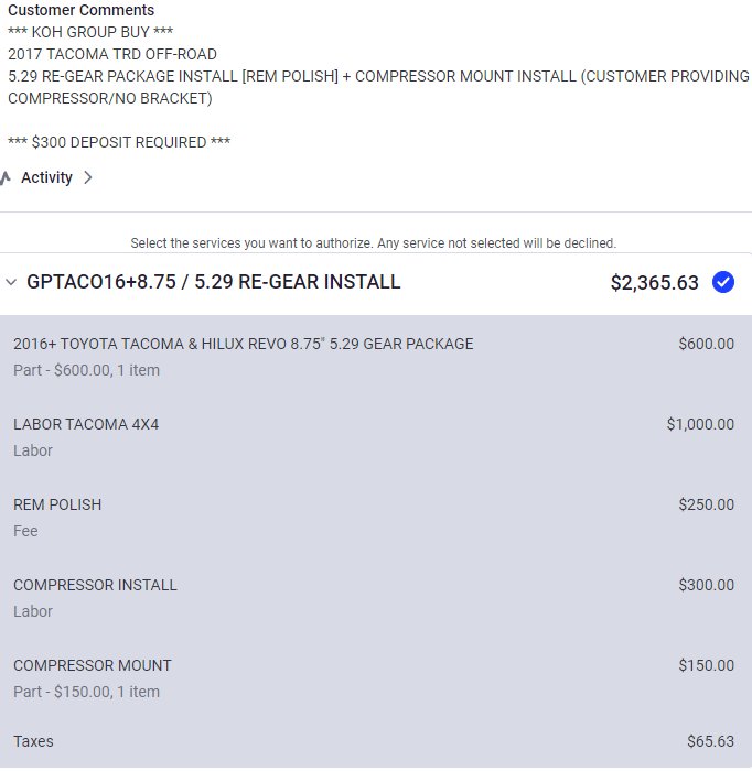

    The price was too good to pass up with the group buy. This includes a REM polish and having my ARB twin compressor mounted. Hoping all goes well.... I will report back if that is not the case.

    Interesting. definitely a good deal but I question what you are actually getting, the R&P alone is $600 so my guess is they are going to use reuse your old shims, bolts, and bearings.
    The Minikits run about $900 so maybe they got a deal on those but I personally would want the bearings replaced as well.

    Just got word from them-- the install kit gets new shims and they reuse the ring gear bolts. Going to get a quote for the bearings

    I just verified that the install kit includes new bearings + shims but I guess they assumed I knew that-- which I guess I should have (?)

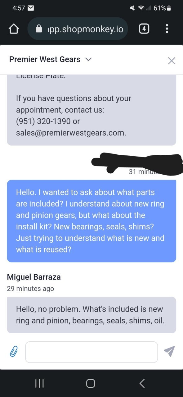

    Reading this last page of comments has made me slightly concerned. I have an install appointment in a couple weeks. Your comments made me reach out. Here is what they said. Not 100% sure I believe it.
