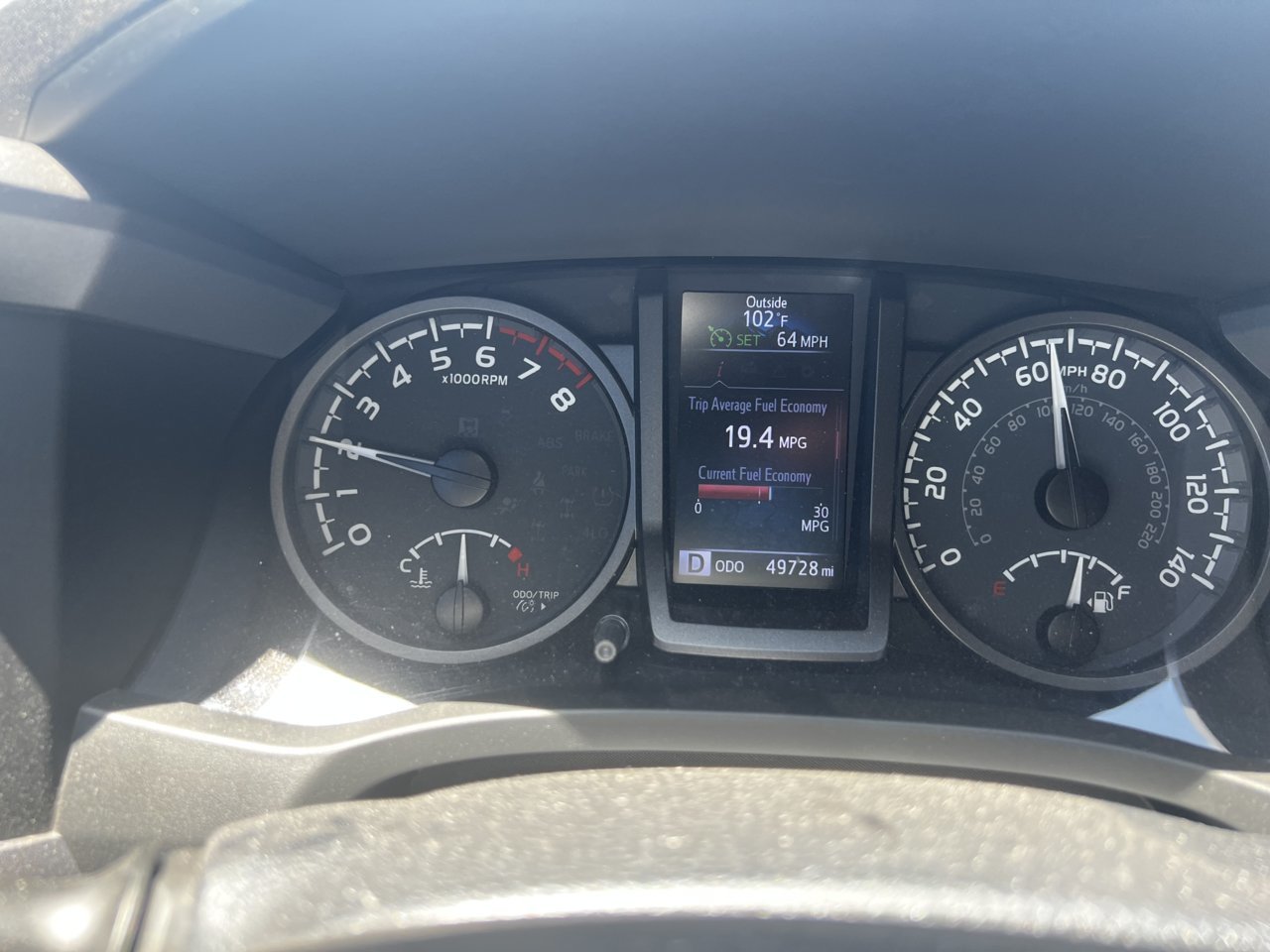

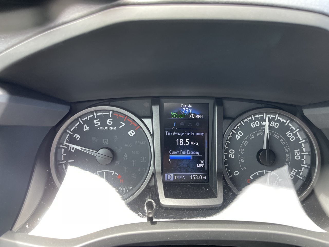

    Just an update v6 dc 4x4. 32” (mounted size) 285/70/17 on 8.5” wheel
    No real weight onboard
    5.29. 2267 rpm @ 70 mph.

    Just a spec post. See post 329 for my equipment. Here’s a pic for verification.

    thanks - saw some of your specs with wheel size above, but sorry if i missed this elsewhere, but did you recalibrate your speedometer for the the 285 wheels? not that is may make a huge difference on the RPMs but it would be good to know since if not, i think your RPMs would be even lower than in the pic at true 70 mph...

    Yes recalibrated, took a few times but it’s spot on now. The recal made a big diff believe it or not…. Mpg went back up shifting is super smooth and in the correct spots. MPH was 3-4 off. True rpm’s at 70 is 2267 per my scangauge 2
    the pic makes it look funny. The needle looks past the 70 mph but it wasn’t from my vantage point and gps had me dead on 70.
    I never do over 75 so I’m happy. The truck running in low 2000 rpm’s gets good mpg. It doesn’t go down it maintains or goes up a smidge on longer trips. My taco stays around 18-ish mpg

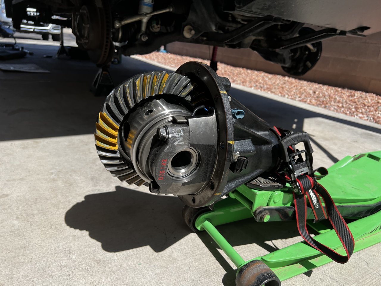

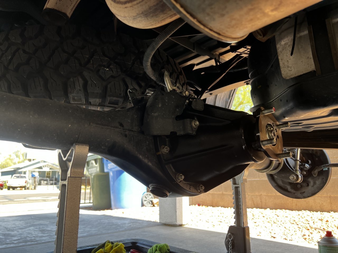

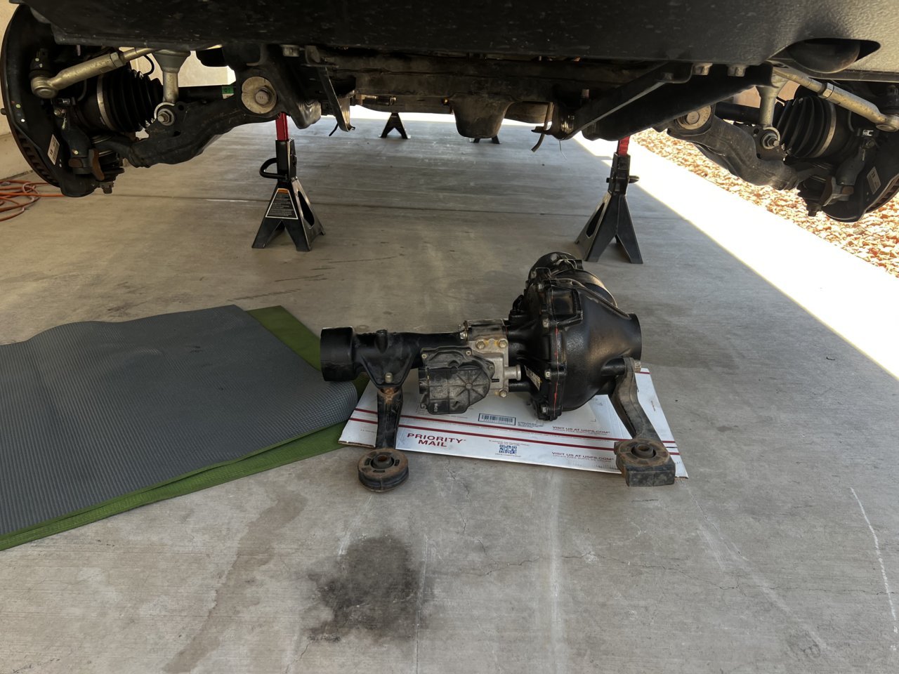

    Revolution 5.29’s. I got REM and Cryo treatment so no break-in period. Zuk setup the gears and I got the diffs reinstalled yesterday. Truck drives amazing and it was well worth it. I’m on 35” skinnies and speedometer is corrected for reference.

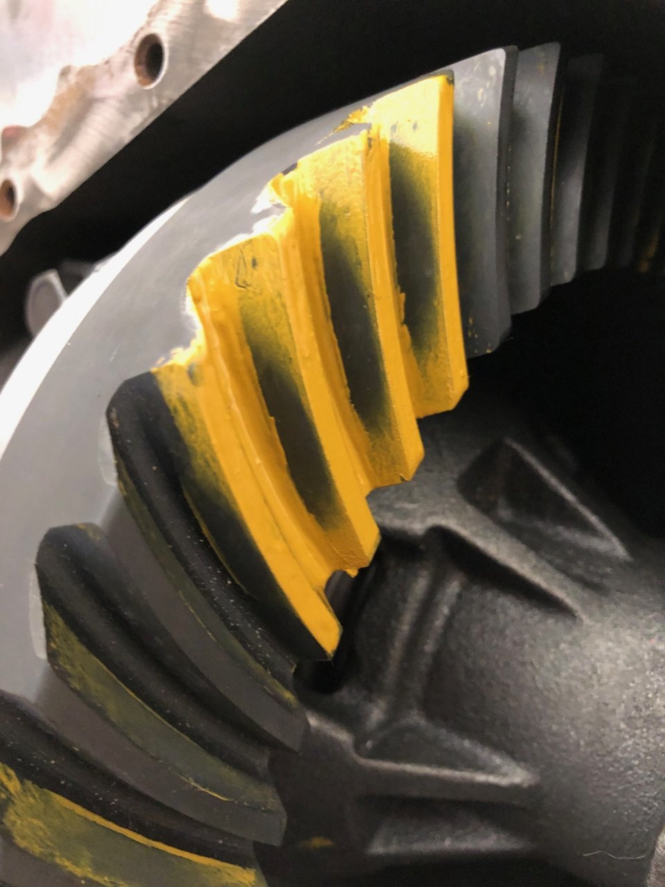

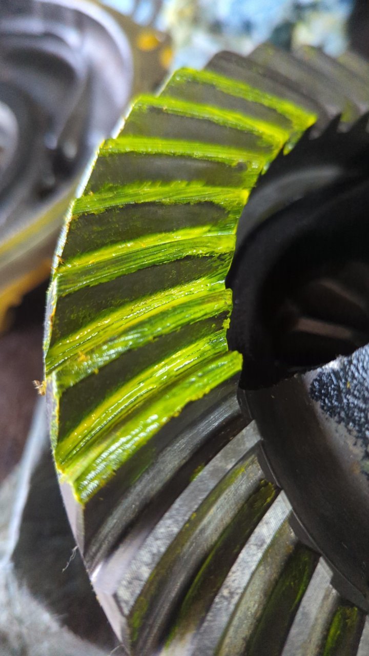

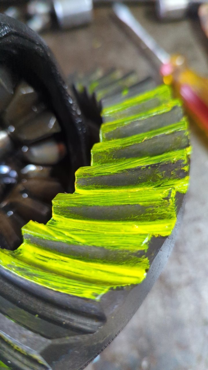

    Looking for some advise on this pattern.
    The gears are brand new

    Its hard to see, make sure you are adding resistance when rotating the R&P for a clean touch. I would say you to try to go a deeper but hard to tell with how it came out.

    Might need to thin out the marking compound with some gear oil as well.

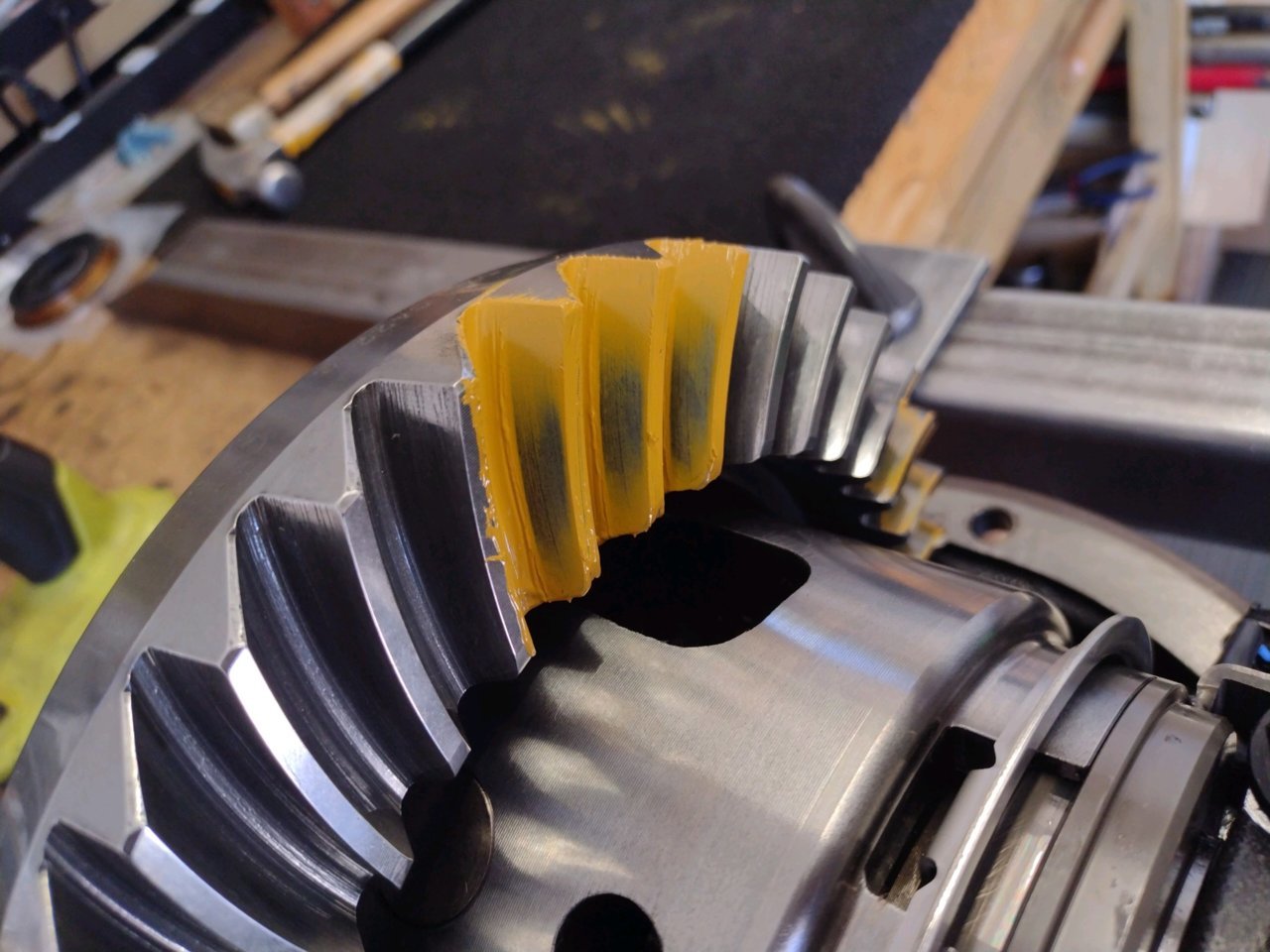

    Heres a photo of my 14bt that I did for my Jeep, this is more just a reference to the contrast between the gear and paint. You want a clear pattern to assess.

    Thanks for that pic. I was hoping to see a small oval like yours instead the whole tooth is wiped.
    I'm putting a.hammer handle in where the axle shaft house in to make some.resistance.
    I'll try again when time permits. Thank you guys. The making compound it just paint. So little came in the rebuild kit I was going to use it when I was close.
    All the bearings in there are set up ones don't know if that matters. I don't know if there is an order to put everything together I still haven't looked at pinion depth or back lash. Tomarrow is another day.

    Pattern marking is pretty much the last step which is annoying because if it's off you have to sometimes go all the way back to the beginning. That said this is is after you have thew new bearings, pinion preload, backlash etc completed.

    I'll look up some instructions. Thanks. I jumped the gun
