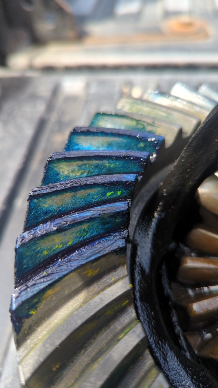

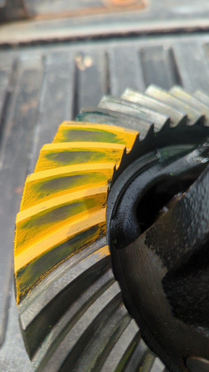

    Trying again with some better gear marking compound.

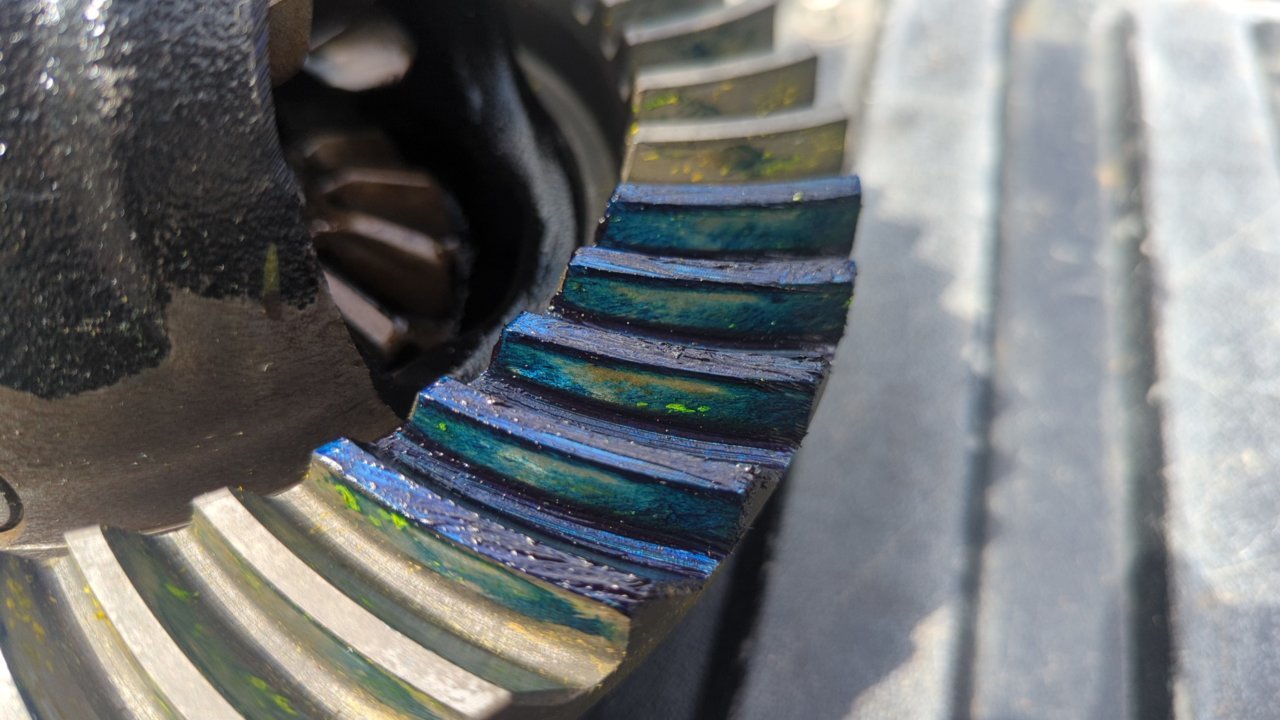

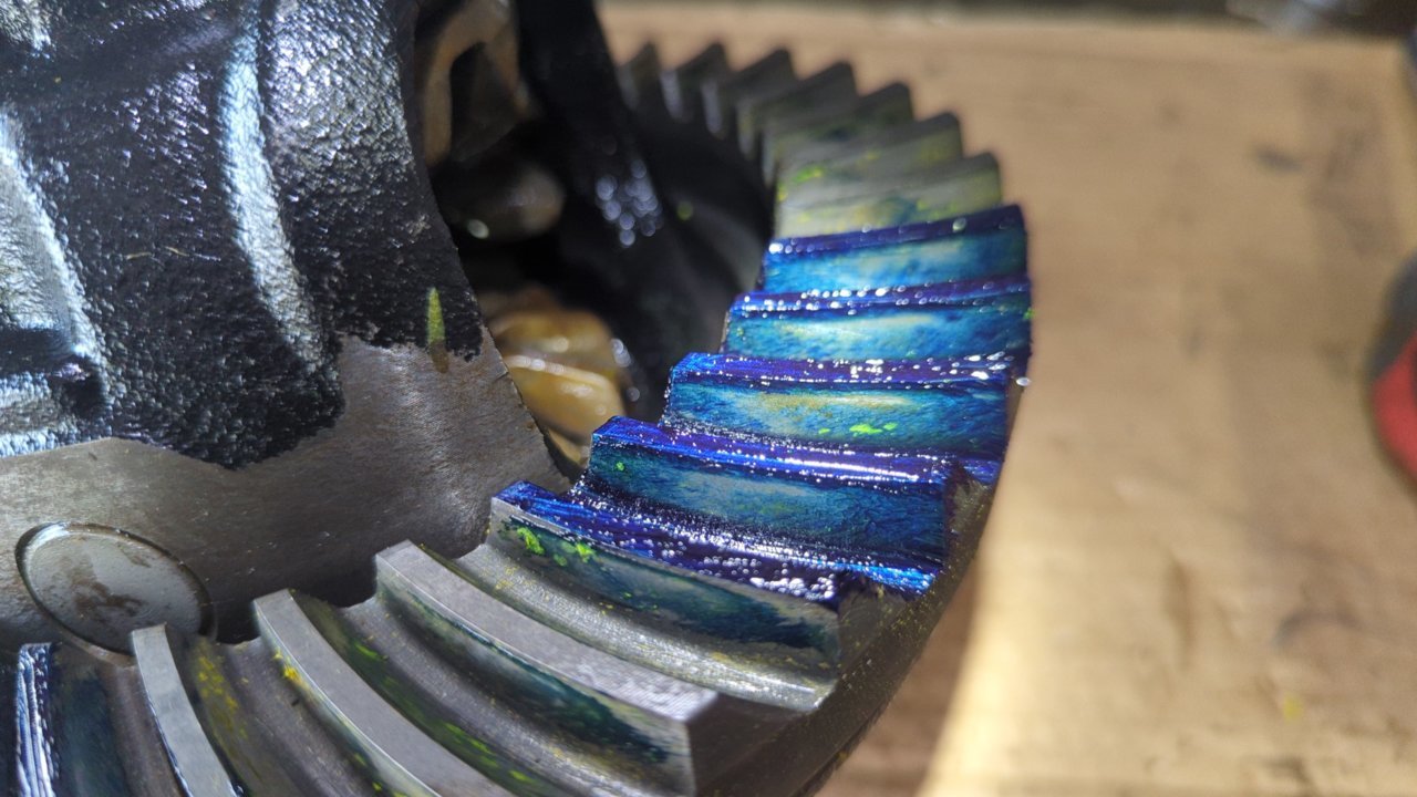

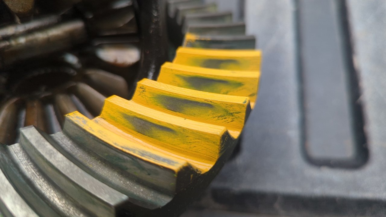

    Another try.

    I assume it’s the 8.4” diff. What size is your pinion shim? What is backlash? How much preload on pinion, and how much preload on carrier?

    The pinion shim is .070 I think
    It's an 8" front clamshell from an FJ cruiser
    Backlash don't know how yet I have not done that yet. I have the original crush sleeve in there now and I just tightened it up
    As for carrier preload. I'm at a complete loss there.

    Pretty much gotta have backlash in spec or close before you can run a pattern, otherwise if you get a good pattern but the backlash is out, you'll screw up the pattern by getting the backlash right.

    For aftermarket gear sets like nitro and Yukon I typically see 0.072” pinion shim. Throw the original crush sleeve in the trash, it’s one time use only, you’ll need a new one. You’ll need to follow the guidelines for preload for new and used bearings, at least get it close. New bearings I put 12-15”#’s for pattern check and 5-8”#’ on the carrier to pattern check. Backlash needs to be between 6-8 thousandths for pattern check. Once all of those are met, then you can apply paint. The lid must be torqued to spec to run a paint check. If you can’t do any of that, then hand it off to someone who can so you don’t destroy your diff.

    so a new chush sleeve did come in the install kit
    question hear is how to check carrier bearing preload with a clamshell type diff?
    backlash looks like a need a special attatchment for the dial indicator
    i was putting 4 bolts in with a 3/8 impact but good to know and will do it that way
    absolutely great advise. thank you.
