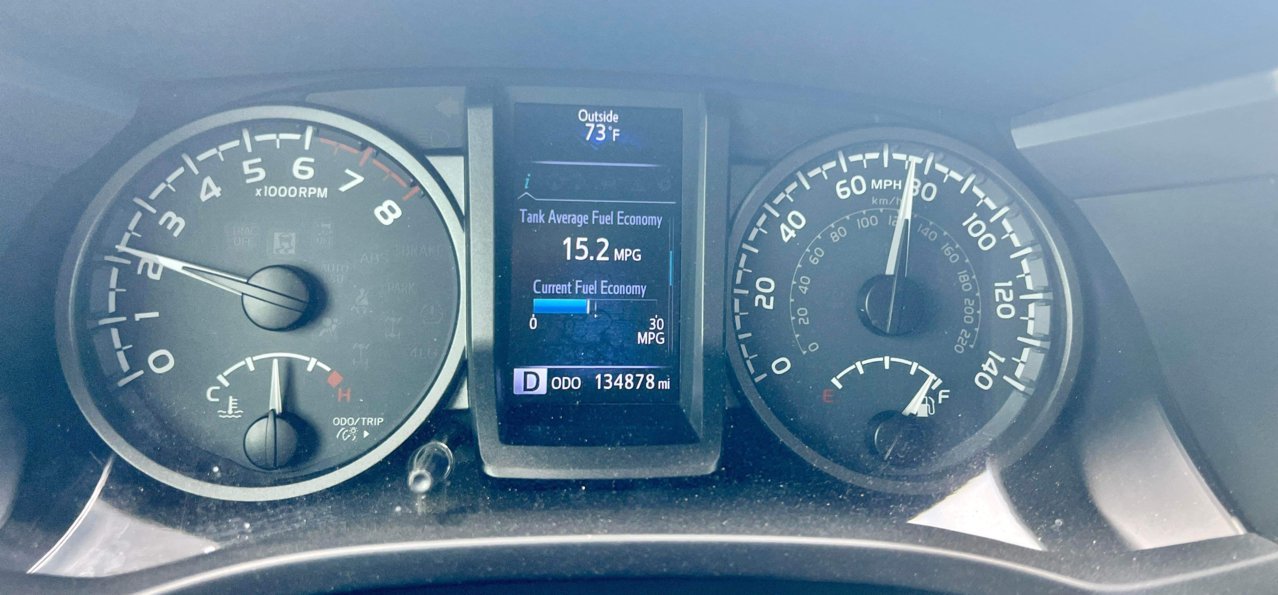

    Quick update on the 5.29 with 37s. Not a huge difference in street or highway from 35s to 37s driving wise. A bit slower feeling and a bit more floaty, but nothing crazy. Taking off from red lights she keeps up with traffic and shifts under 3000 rpms unless I'm getting after it. Highway cruising at 75 to 80ish is in the 2000-2300 rpms. No complaints so far, not my daily but she gets driven almost every day. This pic is flat highway cruising maintaining speed, foot just on the gas. Speedo is a little off, it's closer to 78-79. This is 5.29, 37s with the OTT tune. I'm sure all of this will change in the mountains.
