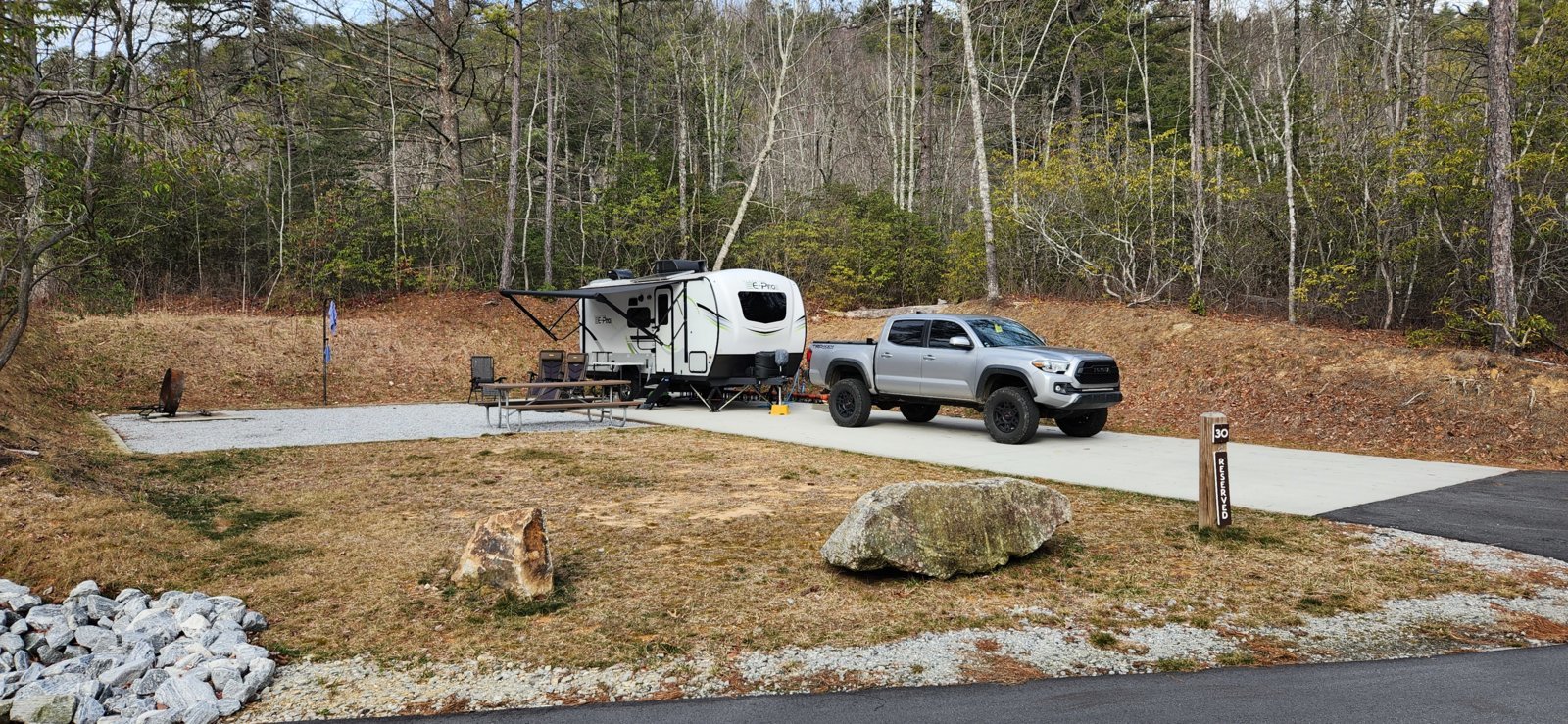

    I tow this about once a month. I have 5.29's and 33's but hoping to get the OTT tune this weekend. Camper is an E-Pro 20bhs.

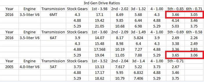

    With stock gears and 275/70R17, the numbers are as follows:
    50-80
    3rd - 3154-5031
    4th - 2110-3376
    5.29 and 33’s:
    50-80
    3rd - 4169-6671
    4th - 2798-4477
    5th - 1931-3089
    4th would be similar to your current 3rd gear but not quite as low.

    4.88 would bring those numbers to:
    50-80
    3rd - 3846-6154
    4th - 2581-4130
    5th - 1781-2850
    bone stock would have been:
    3rd - 3299-5278
    4th - 2214-3543
    5th - 1528-2444
    The only concern I’d have with 4.88 is if 4th is enough of an improvement over stock to keep you from going to 3rd. Otherwise you’ll be in 3rd at even higher rpm than you are now. Depends on how much it needs 3rd currently I guess. I’m not sure how much better 4th would need to be to stay in it.

    All I use is the grimmjeeper calculator. Your transmission is the Toyota AC60F. Stock ratio is 3.909. Don’t put in your nominal tire, put in about an inch smaller for real world. 33’s are usually 31.7”-32”.

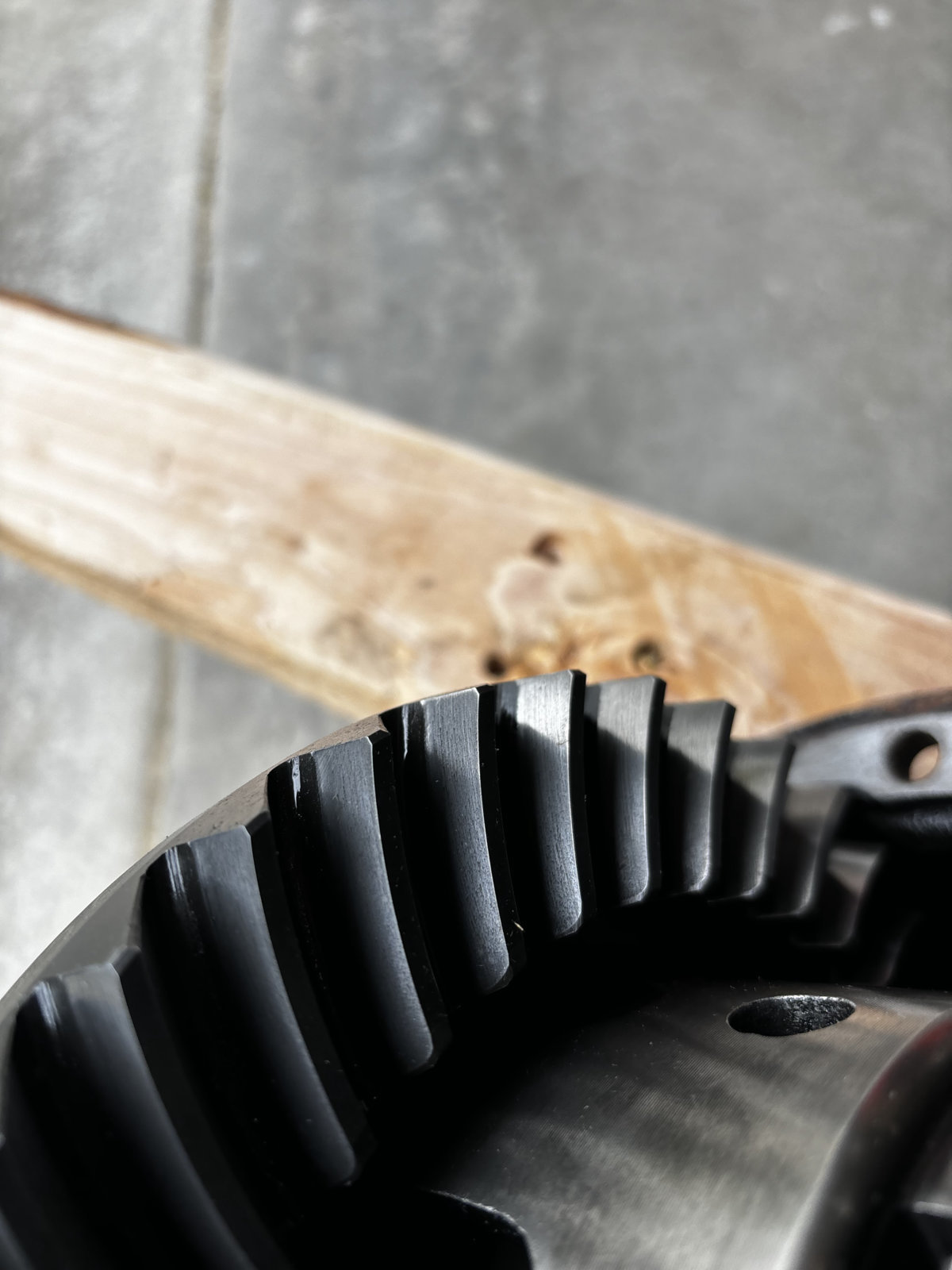

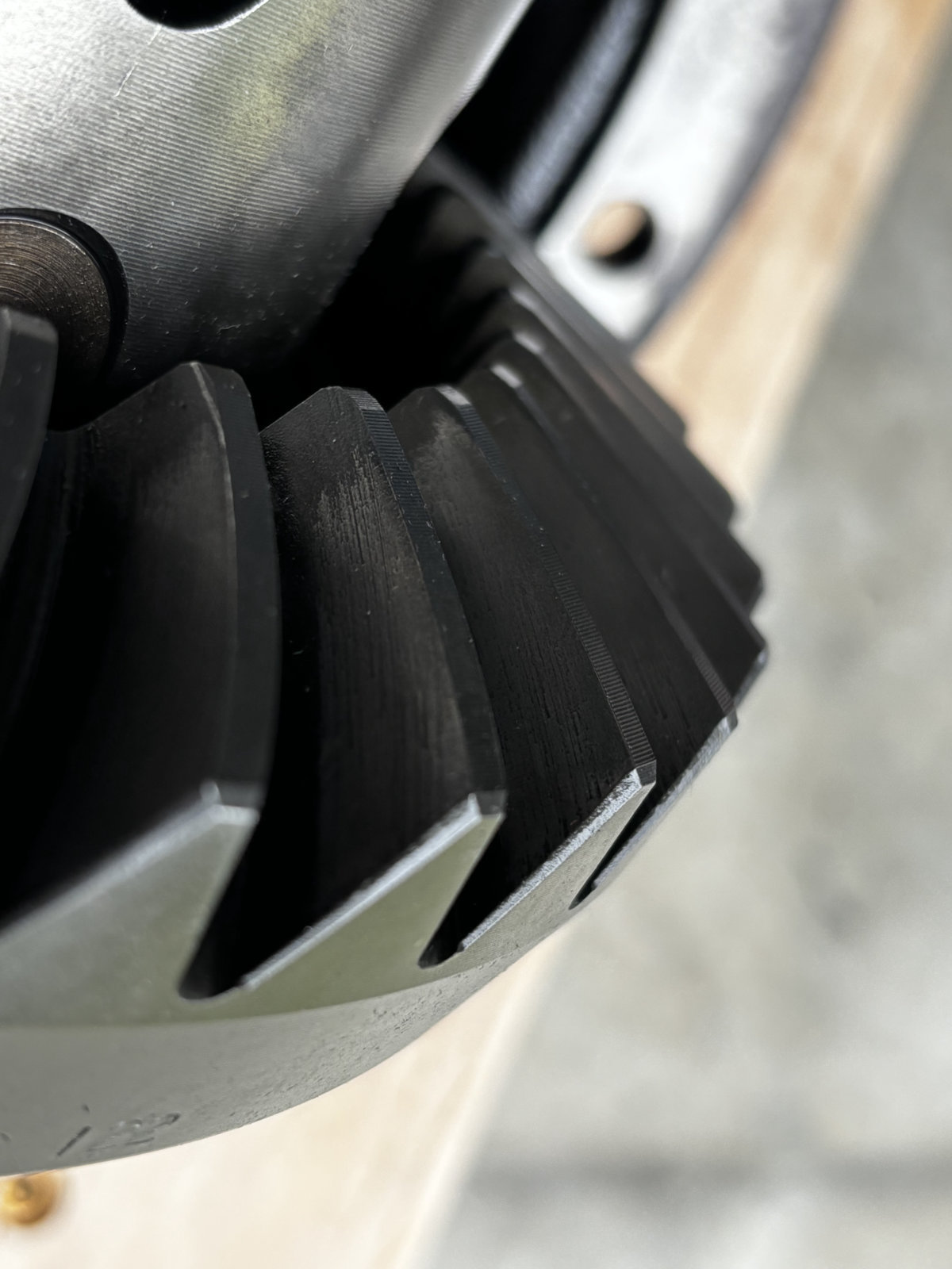

    Tearing down the yota to replace my nitro 5.29s after one year. Shop set backlash at .001 leaving no room for oil. Gears look like they have 100k miles at 10k of mixed driving. Gears whine and howl like a banshee especially on decel. I replaced the bearings and set the backlash to .008 but that did not good as the gears are wore in with a bad pattern and will have to be replaced. The Nitro shop in Cashmere, WA that did the install (same one featured on Tacoma Beast's youtube channel) is the shop that messed it up. They are closed for good so I am SOL and on my own to get the gears replaced at my cost. So pissed since summer is starting and mountains are calling.
    As for performance and my take on 5.29s here are my thoughts. First they make 35s feel like stock tires. I went from WA down through western Utah into Nevada across the Pony Express, then up through Tahoe and back home to Oak Harbor, WA. Power was never an issue with the 5.29s. Passing a gas station is an issue. Could've been the piss poor setup from the aforementioned shop, but the best I could get on my trip was 14.5 MPG and yes that is adjusted for the tire size. I don't commute to work so this isn't a killer for me and I'd much rather have the power. That said I don't like running so high in the RPMs in states with high speed limits as I cruise from one off road spot to another. Actually thinking about stepping up to a long travel 6" lift and 39s to offset the 5.29s a bit more.
    Honestly for the price I should've just done a third member swap through ECGS.
