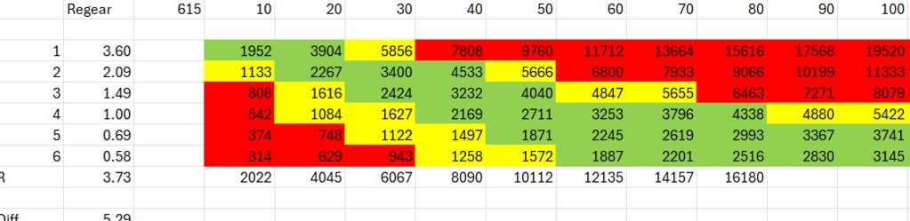

    TenBeers
    TenBeers Well-Known Member
    Jun 5, 2009
    #18067
    7,685
    Rich
    Bentonville, AR
    2018 TRD Pro Cavalry Blue
    Yeah.
    It's the tire size that makes the speedo off. What size tires are you running? AT or MT?
    I threw together a spreadsheet to calculate RPM at certain speeds in each gear (Freedom Units). The "615" is rotations per mile for current tire size, which I am running 285/75R16. Based on real-world measurements, it's pretty spot-on. I just did a brief highway run at 70 and it was right at 2200 RPM.

    Yeah, I'm not sure I would even want to ever go more than 83mph in this brick anyway, lol. I don't think the ECM takes MPH into account, but I could be wrong. It's more about RPM, TPS, and calculated load that determines when it will actually shift. Anyone that wants to chime in with real details that doesn't want to sell me a tune, I'd be happy to listen to, but I haven't seen a clear explanation of how the stock system works and how a "tune" makes a huge difference.
    The limitations seem to mainly be physical -- with stock gearing and tire size, the stock tune is a bit crappy and results in gear hunting due to crossing the load calculation threshold too often, but it's right on the edge. A tune can help with this. But start changing leverage ratios (bigger tires) and adding weight, no amount of tune will overcome that. There are physical limitations of available power vs leverage. You can change available power through supercharging, or change leverage through gearing.
    Anyway, just did another few runs and the stock tune behaves great. For me, 5.29's was the answer I needed. The ECM doesn't know I changed the gearing, it's looking at other inputs.
