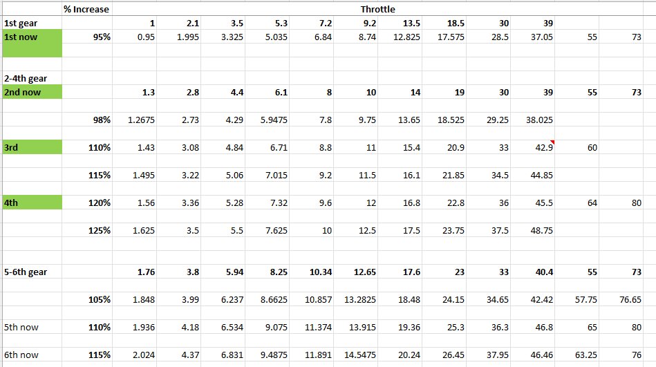

    It took me about 4 tries to get it right. I took the stock tune throttle inputs and then increased by say 5-10% for each gear. I've pasted a snippet below of some old values. I have it so a normal steady increase would need say 20% push into the pedal and hold it. Once you get to the speed you want, I could lift up to say 10% and maintain speed. It worked flawlessly at highway speed since you didn't need have your foot halfway into the pedal to maintain speed since it's increased about 35% more pedal input (6th gear vs 1st) at the same position as you'd have the pedal in 1st gear since each gear increased. When going up a steep hill at 65 and the truck downshifts to 4th, instead of it accelerating (with same pedal position) up to 75mph, it would literally hold 65 since 4th gear had less throttle input. Also the percentage of throttle between 4th and 5th was the most since that's the biggest jump in RPM for all gears. Now with the blackhawk tune when my truck downshifts to 4th up a hill at 65mph it does speed up and I have to lift off the pedal to maintain speed. Then it downshifts to 5th and I have to give it more throttle (That's the only time it's really annoying though, it seems to have increased throttle or it just holds higher rpms for in town type driving where I can keep my foot in the same spot as it upshifts and accelerates).
    One thing to note about how you get annoyed with in in 6th at 35mph, with increased throttle, it actually wasn't noticeable compared to stock tune where you just don't have enough throttle and have to give it more gas to try and maintain that speed. Also, it holds gears slightly longer since each gear has more throttle. Anyway, the tune makes for a great driving experience not going into 5th gear until 36 mph the majority of the time. It's always behind some prius doing 33mph in a 40mph speed limit area and you're sitting around 2000 rpm with the mpg bar at 15-22mpg vs 25-30mpg or so if it would go to 5th. (I have a gear lock tune so I can technically mitigate this by forcing it into 5th, but that gets annoying and I have an auto for a reason. I drove a manual 2000 tacoma for 11 years).
    It sounds like you should give the tune a try if you don't have access to modifying the stock tune. Overall the tune is more enjoyable to drive compared to my modified stock tune.

    How'd your throttle changes affect cruise? Did it help it not be so aggressive trying to maintain speed? (actually, I don't think we can change cruise values, I recall seeing something from OTT stating throttle and shift schedules are different when using cruise and can't be accessed?)
    I do have VFTuner, and currently on the OTT 5.29 tune. Overall I like the tune, but there are things I would like to try and improve on and the guys at OTT are only willing to do so much, so I've been thinking of trying some different tunes out there to see if I like anything more.

    Dang, I've wanted to try OTT but the cost of it compared to my cheap upgrade fee from KDMAX to Blackhawk is why I went that route.
    So OTT tune will go to 6th at low speeds like 35 mph? What improvements did you notice over stock? They have a thread where they dyno'd all the tunes and it shows OTT making the most torque. But it's comparing against the old blackhawk tune. Also they did 3 runs on the dyno for all tunes and took the best. The stock tune actually put out the most torque at low RPM's (like 2000rpm on a throw-away run they did because that run had less HP up top than the one they used to compare all the tunes). Also about a year ago they promised on a forum to give users the tune to try for free like KDMAX would do and then pay if you actually like it and by the time I got around to asking for it a couple months later they no longer honored that so I got a bad taste in my mouth from that experience.
    I didn't do anything to cruise control and every tune I've tried doesn't really make CC really any better than stock from what I can tell. I've done several iterations of the KDMAX tunes. Those tunes drive well too but I noticed a loss in torque. It's more linear power than stock but relies on heavy amounts of added throttle for the FEEL of more torque, but then you realize over time it's all throttle. When you go to give it more throttle it was just dead and was lazy to downshift as it wanted to hold that gear instead of a quick downshift into the power band if you were at a lower RPM. But it did drive really well on highway. Customer service was all time and Kreg is the man. He is the only tuner that was responsive and would do custom edits for anyone and have it back in an hour!
    Blackhawk is a fairly similar feeling tune to KDMAX but with actual torque gains and more natural/predictable throttle inputs. KDMAX did have some really good upper end power from 4k rpm to redline. But you're rarely at those RPMs and Blackhawk puts the power where you need it most of the time.
    Anyway since you have VFTuner, I can send you my stock tune and see what you think. I'd love to hear your opinion on it against your current OTT tune.
