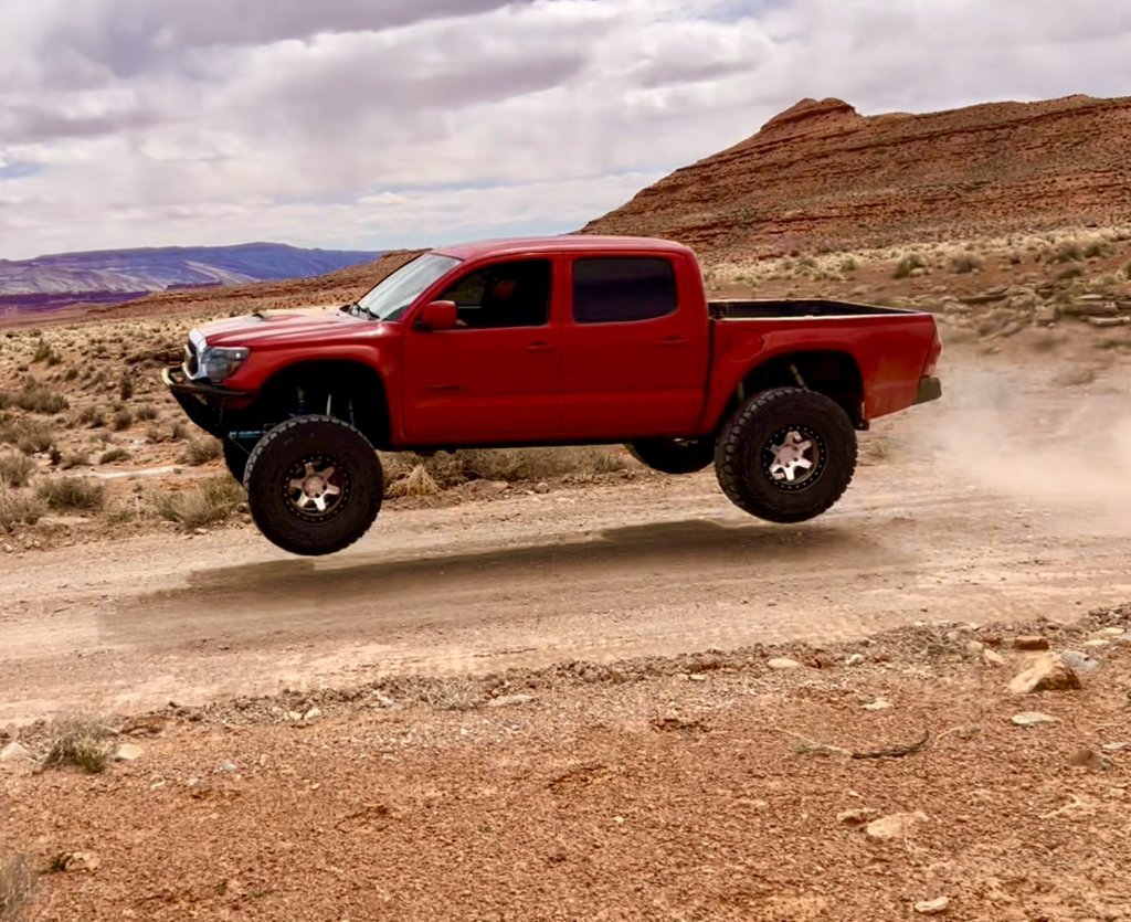

    04 DLBC x4 S/C 97 2X 04 DBLC 4X S/C
    Some and some more
    xxTacocaTxx and Dtax like this.
