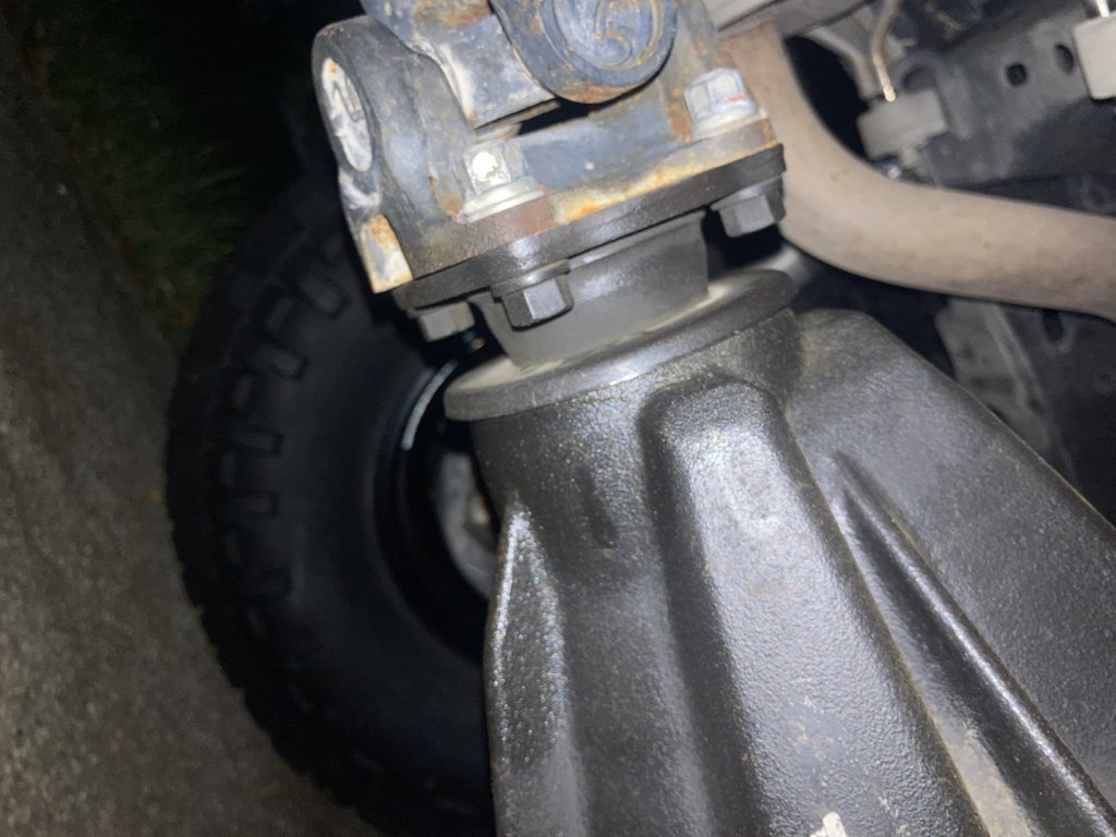

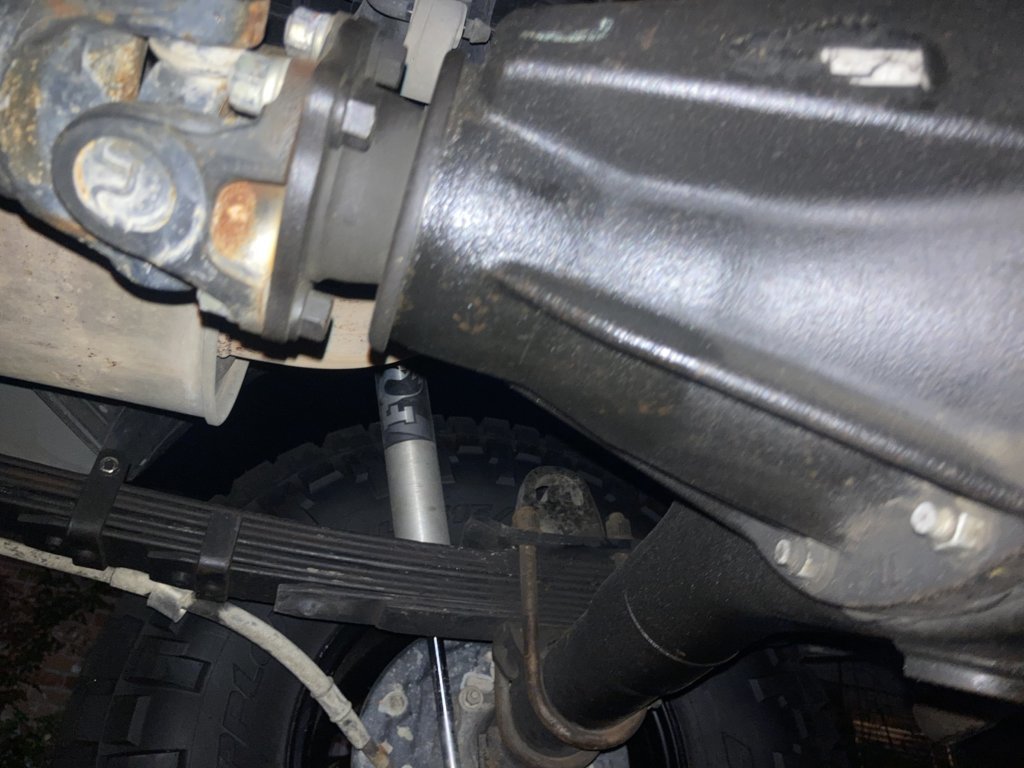

    Post 10k after 5.29 regear slight seepage from what looks to be from pinion seal took it back to installers couple of weeks ago, they say it’s normal to have seepage, but finding that hard to believe since the 2 year warranty is about to expire.. it’s hard to see in photo but it’s by no means a lot, but seems problematic. Also don’t know if it’s related but I get a low hum drone noise from 70-75mph only on throttle, but think it’s related to this issue. any advice would be appreciated

    Clean it off with some brake cleaner and see how long it takes to come back. A dripping leak might be worrisome, but a little seepage like that over 10k miles doesn't seem like a serious issue. And no, a little seepage isn't going to cause a drone. Mine makes more noise at those higher speeds as well, it's just a characteristic of this truck. Some make more noise, some make less.

    Mine doesn’t have gears yet and looks like this from factory. As long as there’s no dripping, IMO it’s not worth the hassle. Warranty or not.

    Thank y’all that gives me peace of mind

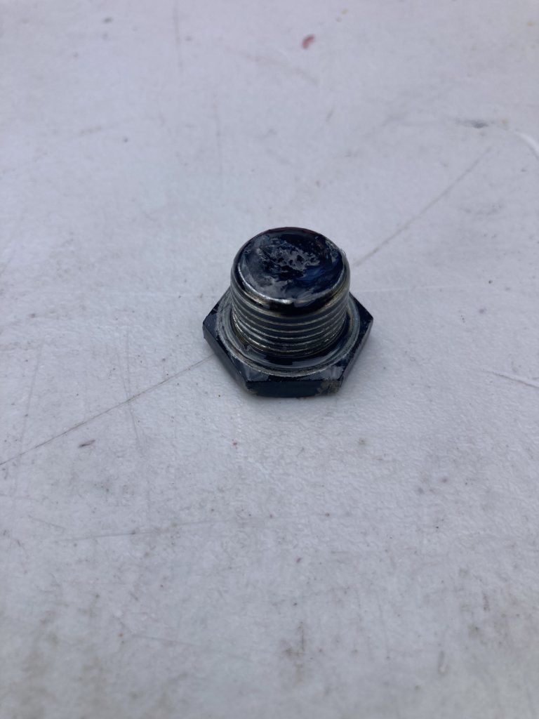

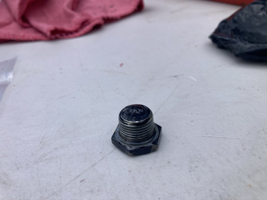

    Update on the gear whine at 70mph after taking it back to the shop that originally regeared they said everything was fine and was just tire noise.. took it to another trusted mechanic and he showed me this video this cannot be good I’m going to drain fluid to see if I can find metal shavings anyone have any insight?

    That is NOT normal. Especially under no load. They need to refund you or redo with a new ring and pinion. I went through the same debacle with an F150 that i had re-geared and a locker install. The shop setup the rear poorly it made noise and clunked. they redid it under warranty from Yukon for their ring and pinion and the shop covered the labor. After getting re-done, it was binding in reverse, and made worse sounding noises than before. I took it back to them. They "repaired" it again and wanted me to pay for the third repair (on top of the original $3,000) I put less than 500 miles on it in months and had to buy a second vehicle to get to work during this. I went had to "take" my truck back at night with a truck and a car hauler. I ate the loss and paid another shop $1000 to setup a new ring and pinion. Truck is sold, axles swapped to another truck and still going strong 8yrs later.
    Don't settle with them.

    Yeah for sure I just drained the fluid luckily doesn’t seem to have metal chunks just your average sludge but yes you are right paying all that money for it to do this is definitely unacceptable thanks for your input I’ll have to take it back to them hopefully they don’t just say it’s tire noise again
