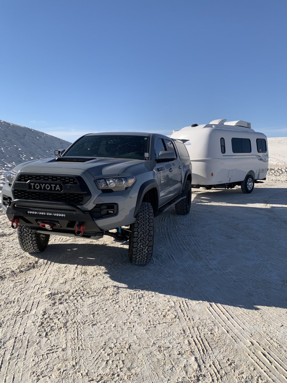

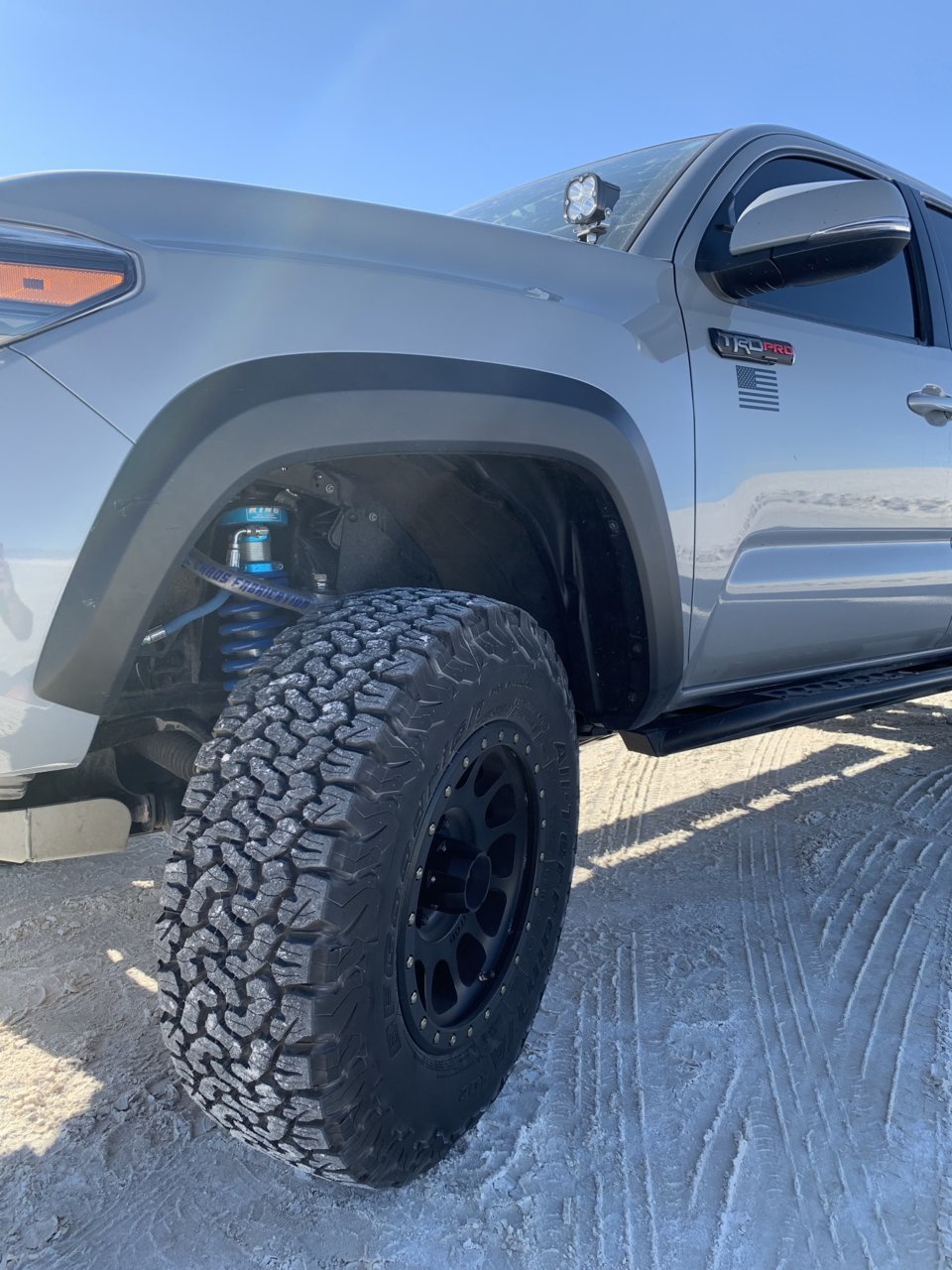

    Hello, I’m interested in regearing my 2017 Tacoma with a auto transmission. I’ve done some mods to the taco. I’ve installed a Lo-Pro Winch bumper with weights about 150 pounds or so. I’ve installed rock sliders with are about 75 pounds or so. I have a leer top that weighs 100 pounds. I installed a 3 inch kind suspension with 285/70/17 BFGoodrich K02 load range C. I pull my 17’ Casita travel trailer at times. It’s my daily driver I drive have city and have freeway 35 miles daily. What gears would be the best way to go 4.88 or 5.29? Thank you for your input!

    Disclaimer: I haven't regeared yet, but I have asked all the same questions and have done tons of research. Everything points to 5.29 for your situation.
    I am certainly going 5.29. worst case it is over geared I get even bigger tires.
    Also, I have read a few posts of users who have 4.88 and wish they got 5.29s, but I've never read the opposite.

    Thank you for the information. When I’m ready to pull the trigger I’m going to go 5.29 seems a little to low for my setup what people are telling me but This tread reinsurers about going with 5.29 gears. Ty!
