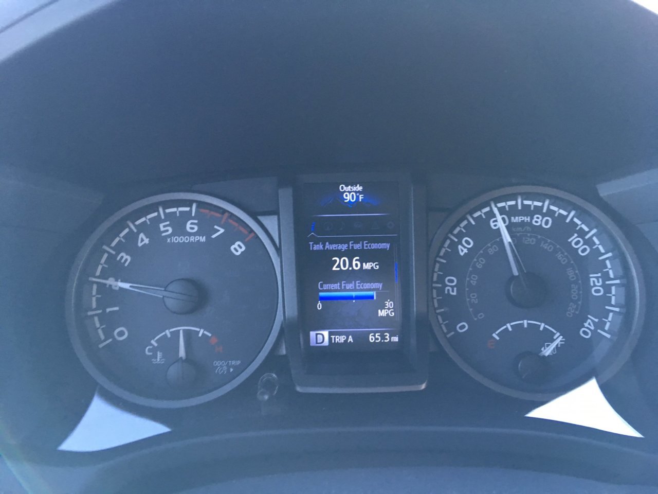

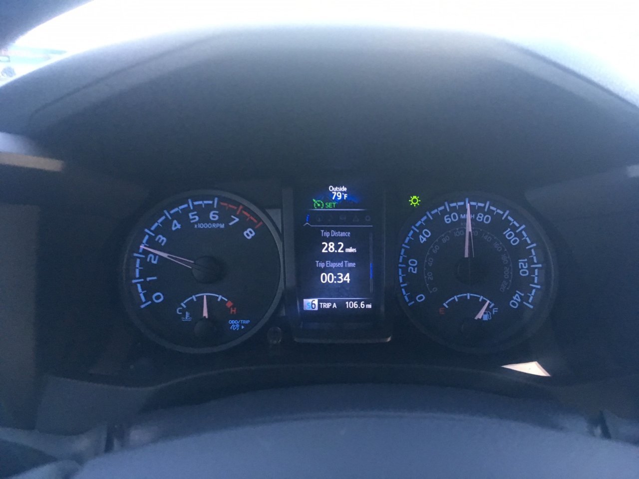

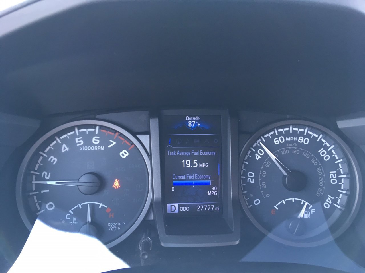

  20. Sep 17, 2018 at 12:35 PM
    #60
    JoeCOVA
    JoeCOVA [OP] Well-Known Member
    Nov 15, 2016
    #202463
    9,656
    Joe
    Colorado Springs
    Ford F350, Lexus RX450h, FZJ80, Jeep YJ, Jeep LJ
    here are some photos of the speed and rpms while driving. I took these this last night and one this morning. I was only at 70 for maybe a mile or so on I-25 to not overstress the gears/oil.
