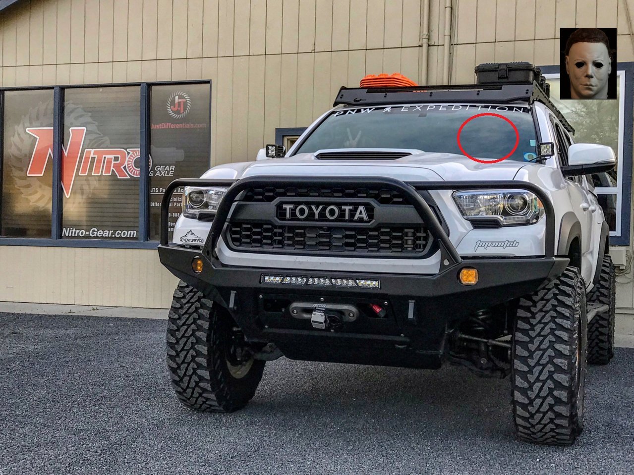

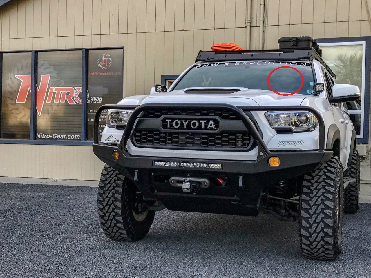

    Wow that’s a crazy formation of the clouds because I’m not in the truck. How else would I take a pix of my truck lol!

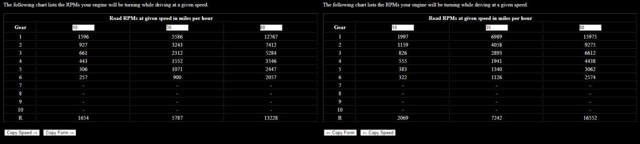

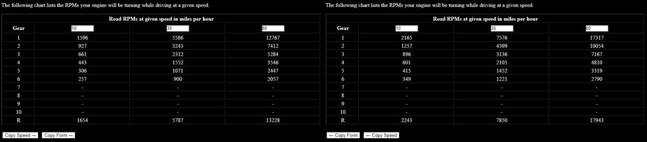

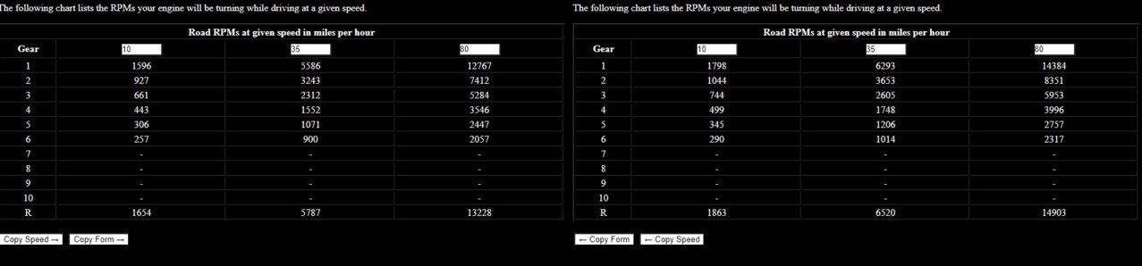

    look at the speed calcs... http://www.grimmjeeper.com/gears.html
    I use this one.. there are others out there too...
    stock vs 4.88
    stock vs 4.88's with 285/75/16's (33")
    stock vs 5.29 with stock tires 265/65/16 (29.6")
    stock vs 5.29 w 33's
    THIS ALL FOR AN AUTOMATIC TRANMISSION manual will be different torque converter changes these number a bit..

    You better save that passenger, because Michael Meyers just hopped in while your back was turned to take this photo!
