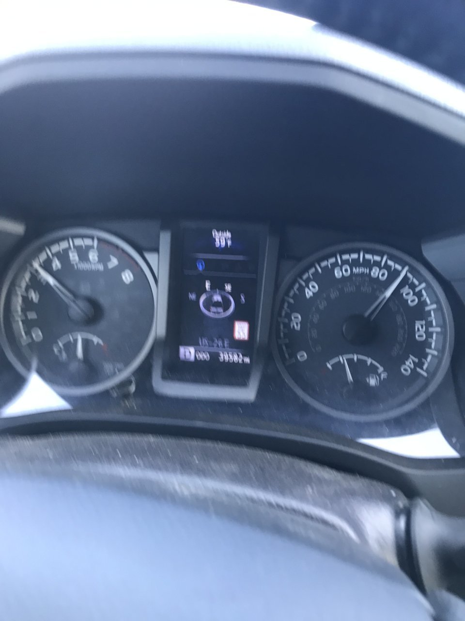

    Debunked the 85mph limiter myth with 5.29. My speedometer is calibrated if that means anything
