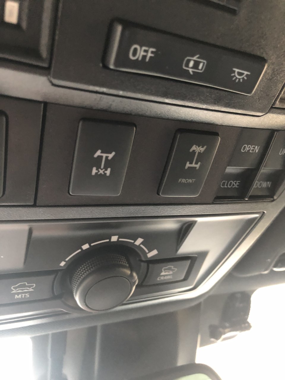

    Is that an aftermarket panel with the switch?

    Yep. It’s available in shapeways

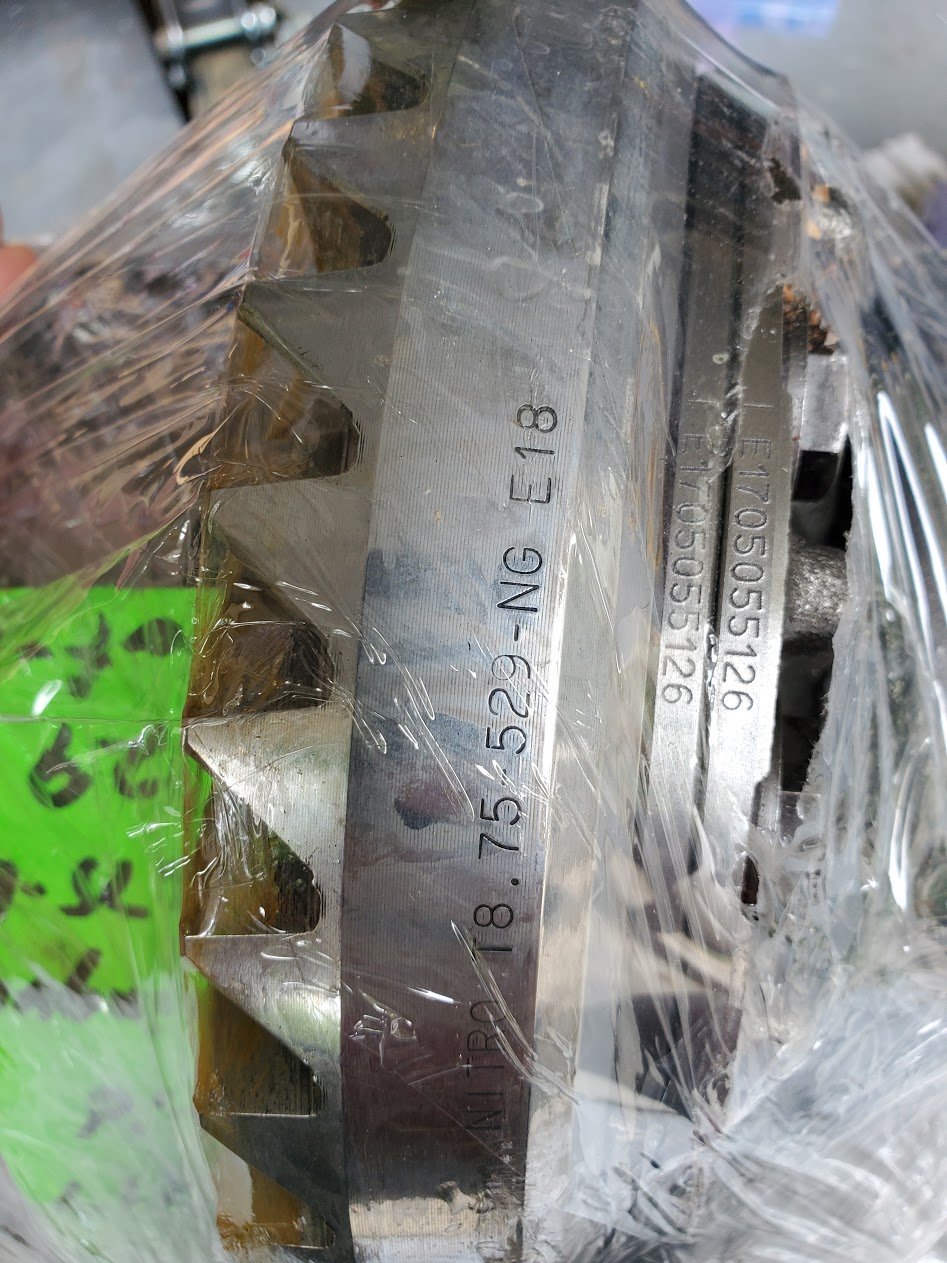

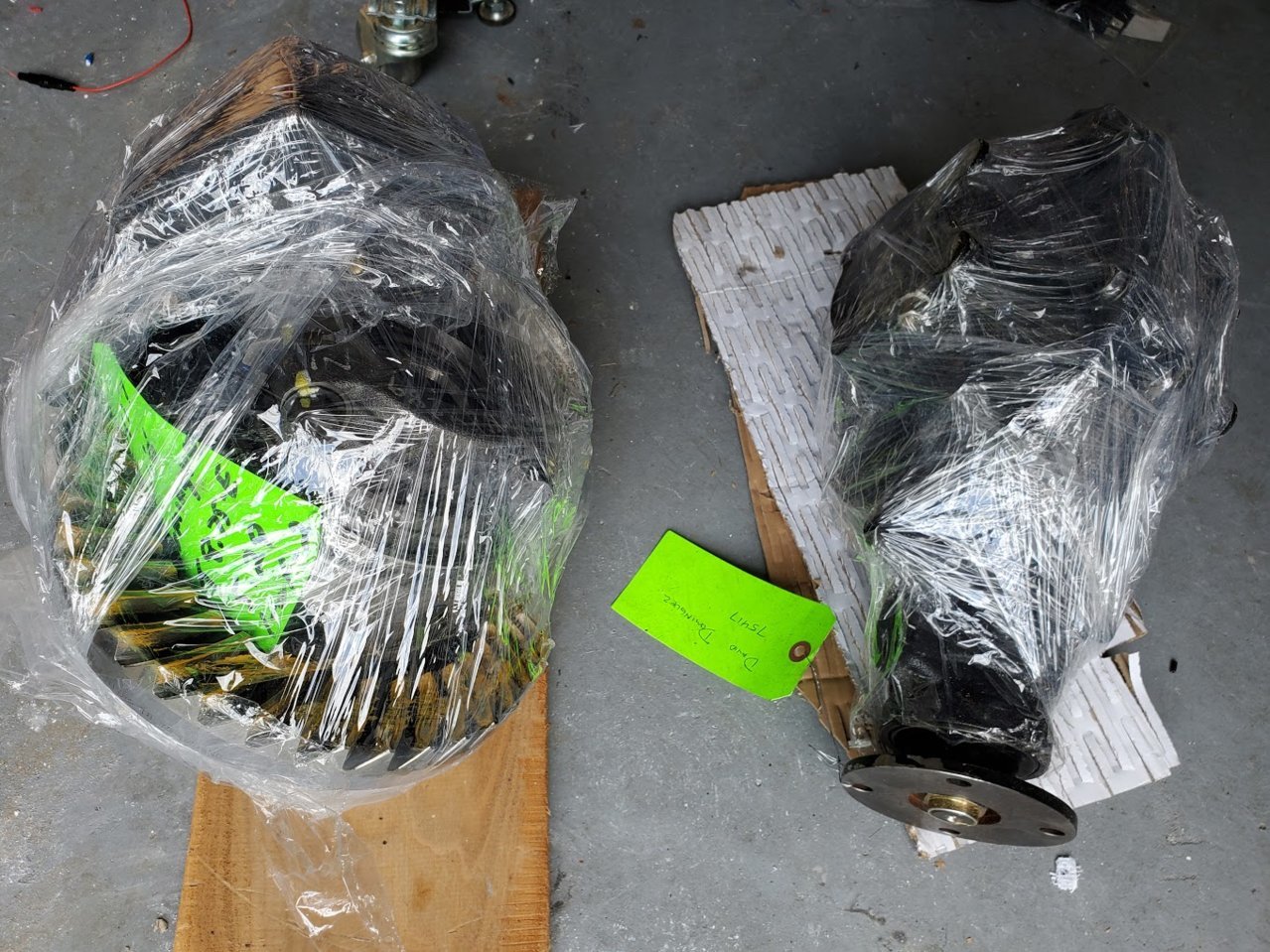

    Can't wait to get these installed next week. Glad that ECGS sells REM polished rears now.

    This one is a bit beyond me. Maybe I'd try if I didn't have a 4 month old, but I have to have the truck back up in a day or two so I'm having an ECGS- recommended installer do it next week.
