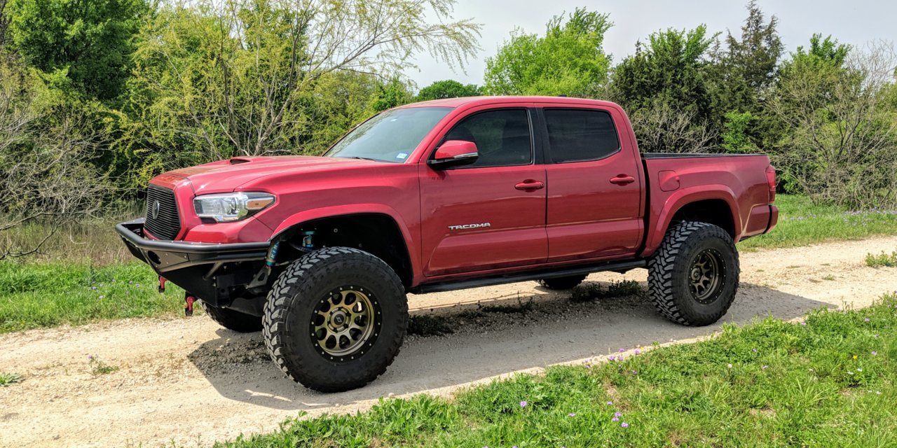

    dmo.jpg Like to throw my 2cents in. I have 2016 sport 4x had Icon lift cant give you a stage but i upgraded the rear to RXT omegas and bump stops front upgraded the s[prings to 700lb coils. I installed 4.88's as soon as they came available and then added OVtune . Recently added a Demello front bumper with a winch and a Pelfreybilt rear HC with a custom swing out. Prinsu rack, a bed rack with an RTT and i have a full set of steel Mobtown skids all running on 34" Cooper STT Maxx tires. So she is a heavy bitch! Recently went to New Mexico about a an 800 mile trip. I have to say the 4.88's dont work at all well for my setup. Back home with daily driving it has been fine even fun to drive. But the gear hunting ,loss of power on any incline was just stupid,having the trans downshift from 6th or 5th into 3rd gear is just ridiculous and i wasn't trying to go over 70 MPH ! So anyone with a rig setup something like mine may want to just go with 5.29's! I think i am going to be the guy who gets a second re gear to the 5.29's its really that bad with the 4.88's unless OVtune comes out with tire and gear tuning sooner then later!
