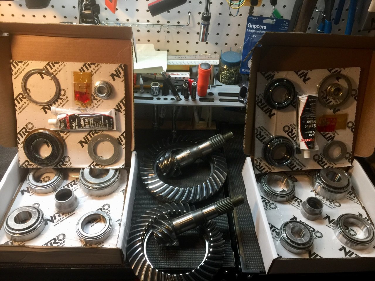

    I came into this thread late. I have read thru a shit ton. About to order my set of gears and wanted to ask you guys this one question.
    I got a ‘17 TRD Pro with the elocker.
    So my question, is the Master Rebuild Kit from Nitro all I am gonna need? I am
    Gonna order these they my buddies shop in AZ, and will have my friends shop ACC Garage down in Ga put them in.

    Should be all you need assuming you ordered the right stuff.

    @JoeCOVA My 5.29's were sitting by the front gate today. I still have a couple weeks before I haul my packages from Accutune and Archive to the installer. Cryo? How long does it take for turn around?

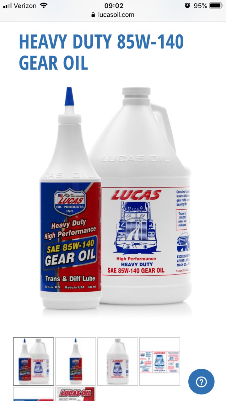

    I can’t see anywhere on the bottle where synthetic, or non-synthetic is mentioned

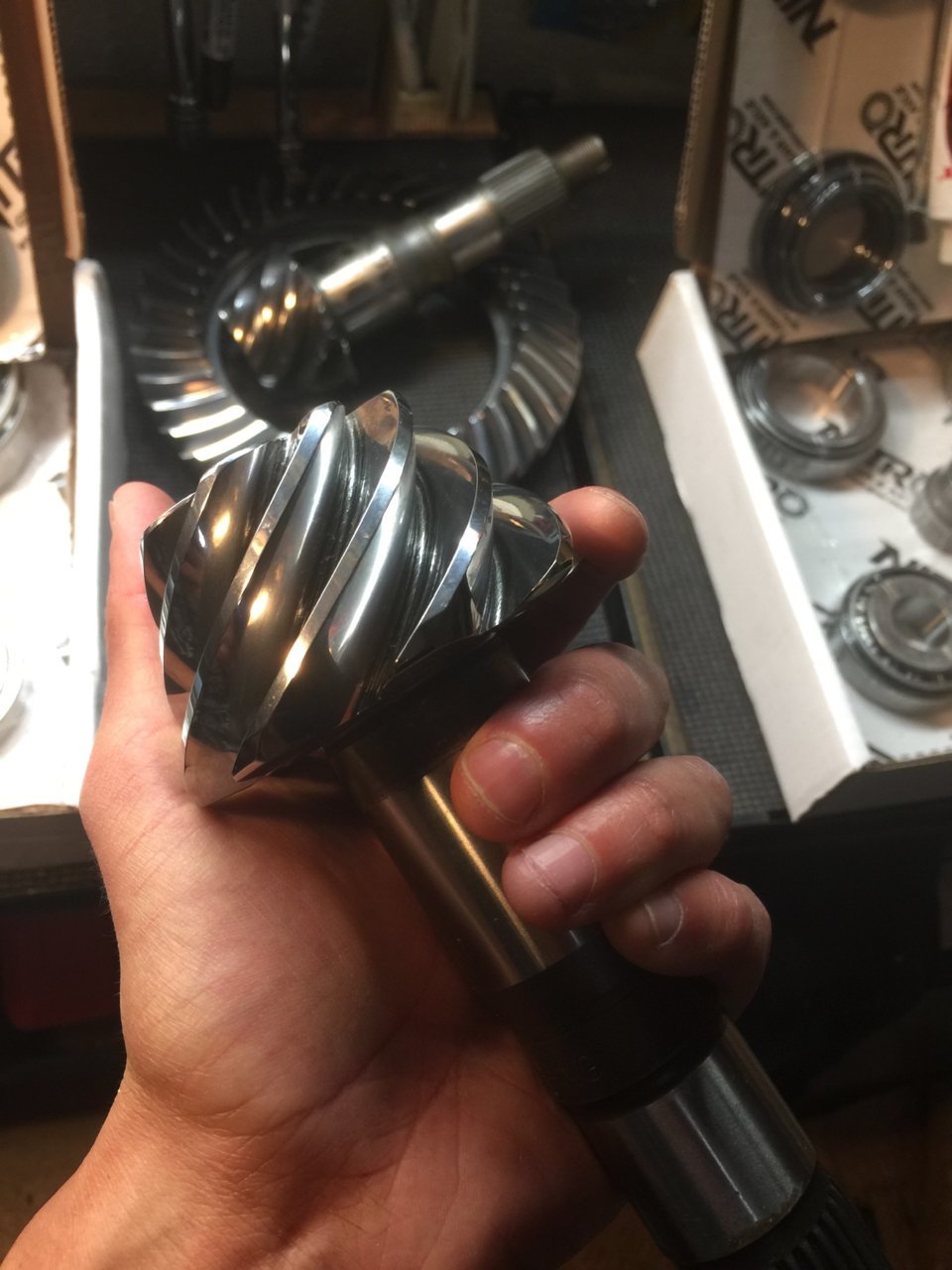

    Just got my 4.88’s (not running anything over 33” skinnies). Definitely recommend the REM
    Had to show off the shiny...now back to 5.29’s

    The synthetic bottle says synthetic on it and comes in 75-140, and not 85-140.
