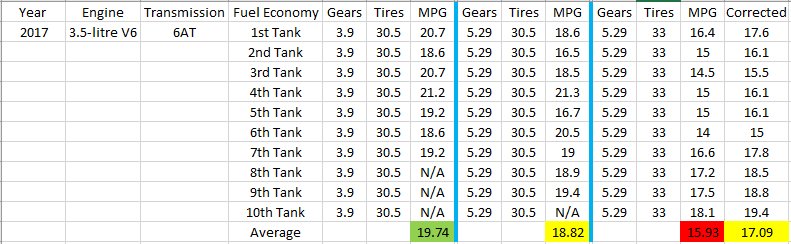

    Below is some fuel data. I will update the second post at the beginning of the thread but I do want to caveat what I learned about the tires and gear combo and fuel economy. As @In4aride mentioned above the truck just does not like certain speeds.
    I found anything over 65mph really began to tank the fuel economy. My numbers appear mildly misleading because I ran mostly 75-80 on the way up to Montana and you notice that I average about 16 mpgs during that time. I was learning how the truck performed during this time. Additionally I-25 north into Wyoming and MT is surprisingly very hilly with long steep grades which I think contributed to the mpg loss. Even at those speeds the truck was usually sitting in 5th and occasionally saw 4th and 6th. However on the return trip we set cruise control around 65-70 and took 191 most of the way to I-80 then I-25 and you can see that we averaged about 18.6 mpg.
    Conclusion:
    Gears alone will result in about 1-mpg loss. Moving to a 33" will result in an additional 1-2 mpg loss. I have no data for stock gears and 33" or 35" tire.
    I would expect someone to get anywhere between 15 - 18.5 mpgs with 5.29s and 33" tires depending on driving habits, load etc. Could be more or less.
    I'll also note that I did not fuel up at a specific point each time, I filled up depending on where we were an availability of service stations so some fillups were half a tank, 3/4 tank, etc. However all calculations were based on miles driven and gallons filled.
    The Corrected MPGs take into consideration a 7.27% change in tire diameter.

    The 33" tire you're running are the General Grabber atx load e I'm assuming, what size ?

    Yup, General grabber ATX, LT285/75R16 on SCS F5s at about 45 psi

    Ya I primarily run 35s but they are a very aggressive bias ply tire so I can't ever get any good data. They are pretty much primarily used for offroading and have a max speed of 65 mph. . I did drive them up to Moab for a trip but 1 tank got me just outside moab and the next 3 days or so was 100% offroading.
    I was able to drive from Colorado Springs to Fruita which is about 320 miles on a single tank so I was able to get about 17 mpgs on the 35s at 65 mph the whole way but dont have the raw metrics.
    I think the mpgs will be very similar, maybe 1 mpg loss but I'm just guessing.
    I may try a set of 35" Maxxis Razr radial tires and I can get more data then.

    Do you know how much your wheel/tire combo weighs? And do you have the tune I can’t remember.
    17mpg is very good. Waaaay better than mine with 37’s (which weren’t too far off mpg-wise to my 35’s). Granted mine aren’t pumped up like stones as yours are. ;)

    I didn’t see it mentioned did you correct the mileage for tire size?
