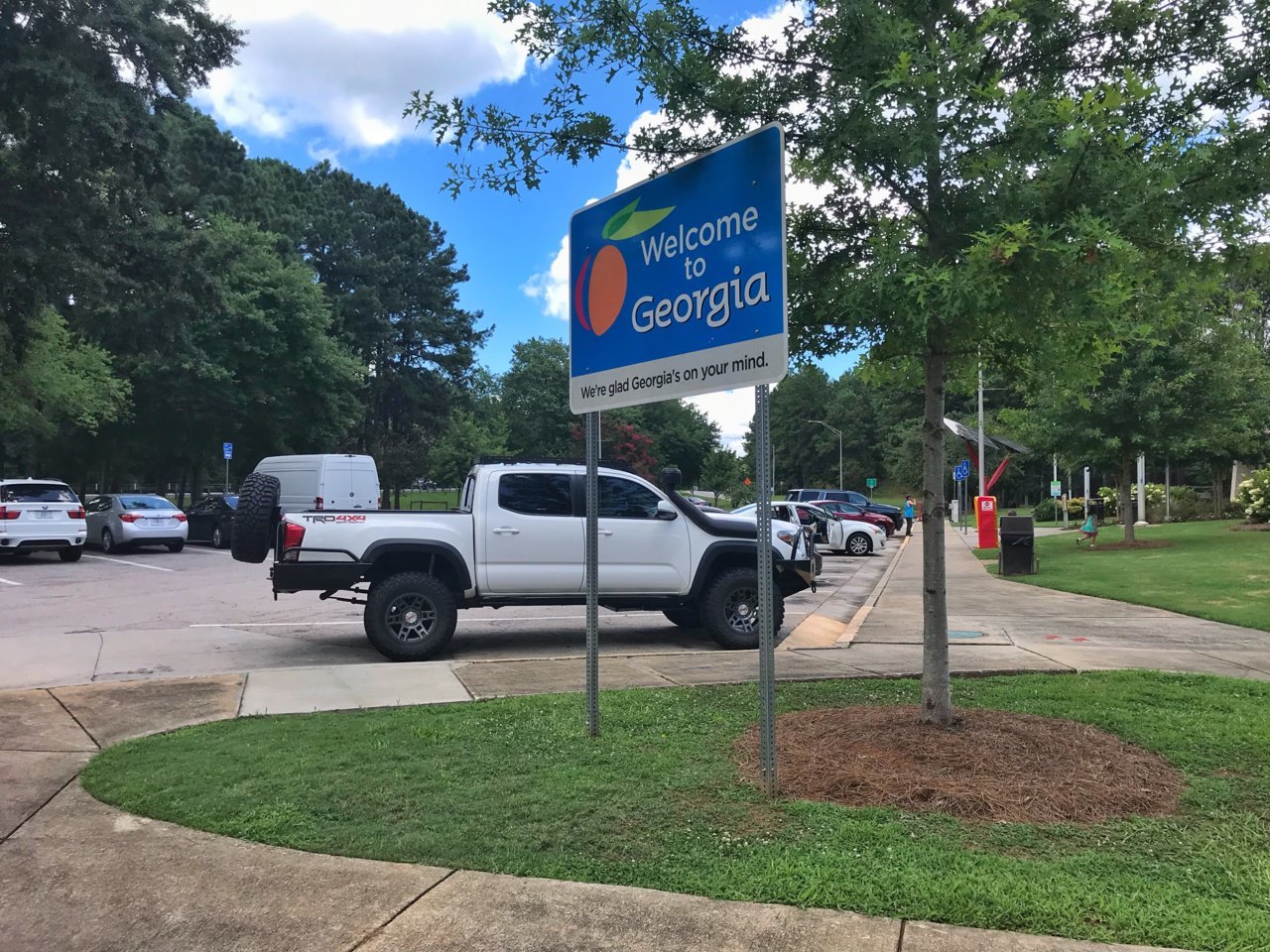

    Making the 920 mile drive to ECGS to get my swap on.
    ~600 down, ~300 to go.

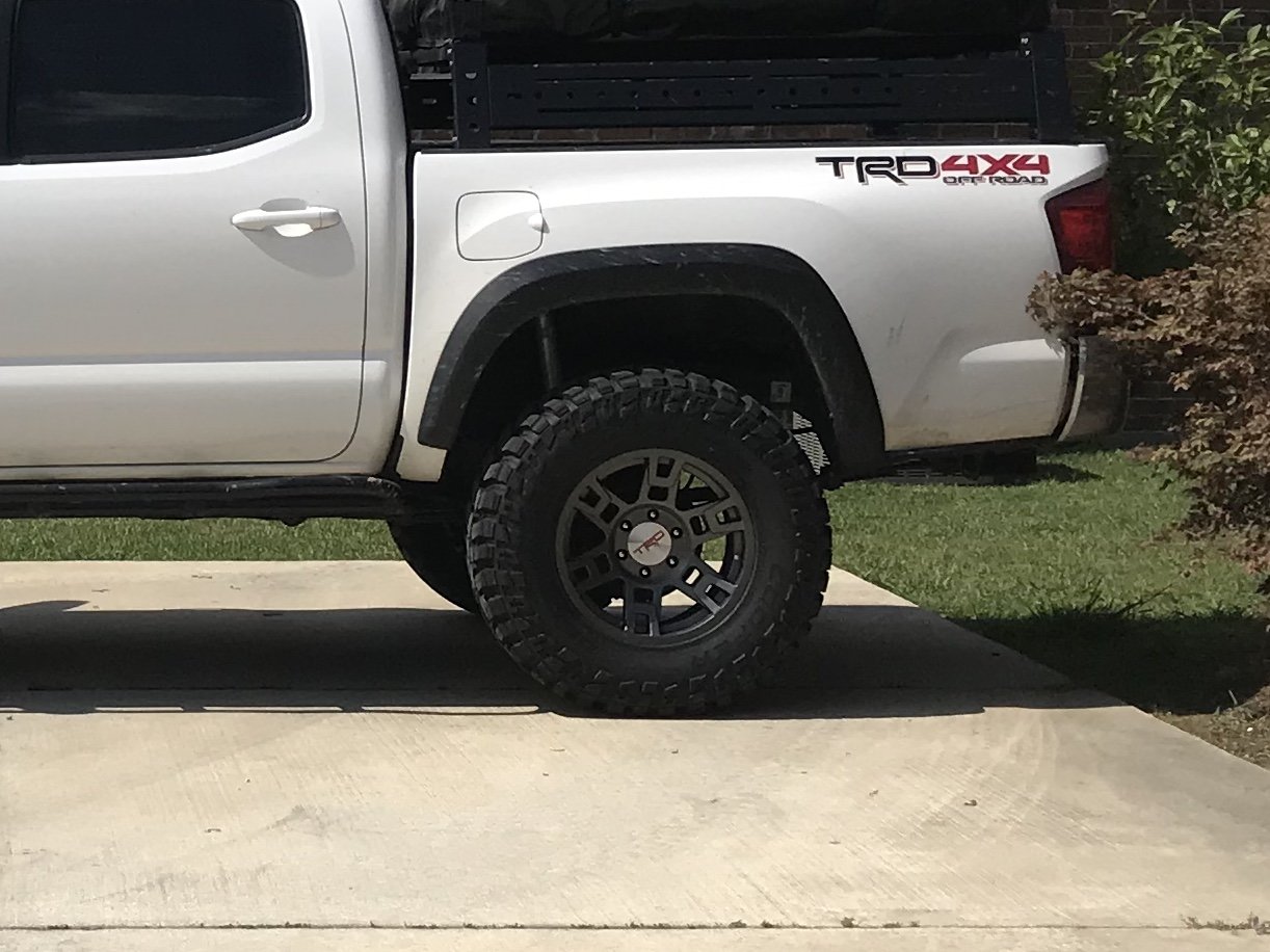

    Did you shorten your wheel base or is the hc that makes it look that way?

    Just the HC makes it look like that.
    As far as I know I put the axle in the exact same spot when I welded in my leaf brackets. I’ve been known to fuck up a time or two though. :rofl:
    Edit: You made me go back and look at some older pics.
    Looks like the HC makes it look like that. Here’s a pice from before the bumper.
