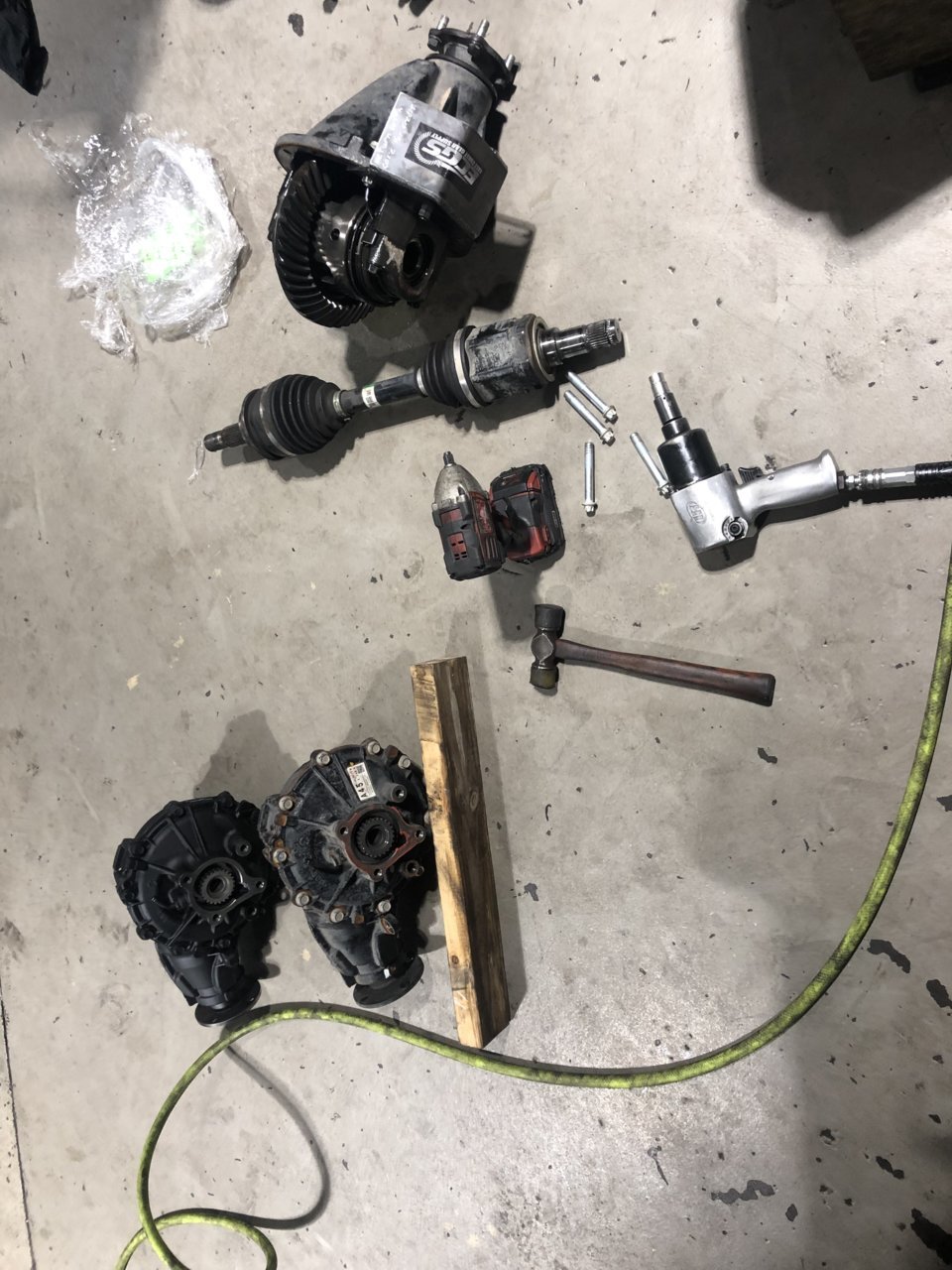

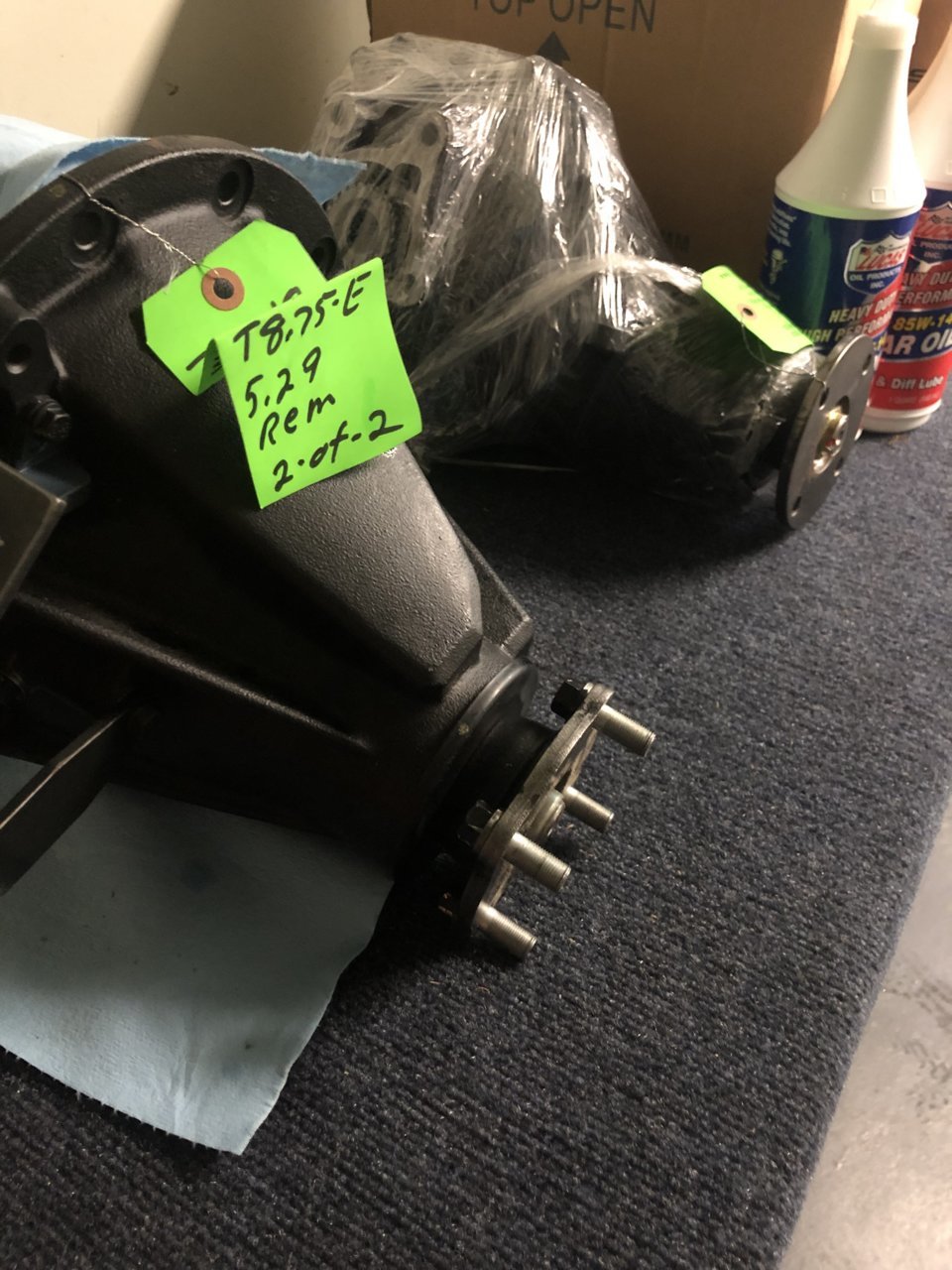

    I just received these two yesterday. Going to try and install them tomorrow. 33”s. Light highway driving but a lot of stop and go. I’ll report back after break-in is done. I’m excited.

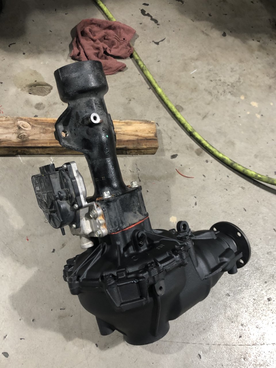

    Rear is done. Working on getting the front bolted up to go back in. Taking a breather then back to it.

    I drove home, let the diffs cool for a few hours. Then I went back out for another quick drive to get dinner. Another cool down for 45min- 1hr. Then drove back home. Even with the REM finish I rather take it easy on the diffs.
    Initial thoughts:
    *The truck feels so much lighter. 1/4 of the way in on the skinny pedal gets me up to speed with ease.
    *If my transmission could speak it would be asking me when did I add a 6th gear to it. Previous to 5.29's it was non existent.
    *There is a slight and I mean very slight hint of diff howl around 55-60mph. Not a surprise to me with this kind of ratio and I kind of expected it. On my second trip out I took the wife with me. She didn't notice it nor could hear it when I asked her to listen in. Perfect.
    *65mph is right around 1900-2000rpm in 6th. I can live with that. Not bad at all.
    *From 30-60mph, I can push the gas pedal and the truck actually accelerates in whatever gear its in and I can speed up without much effort.
    *No more hunting. Not once. Not even on the over passes and whatever slight uphill grades on the way back. No tow button. No pushing it over to S4.
    *I should have done this November 19th, 2017 (the following week after I bought the truck).
    I'll put more seat time and give more feedback later on but so far I'm giving this a 10/10.
    I enjoy driving this truck now. I feel so stupid for knowing what I know and not doing this sooner.
