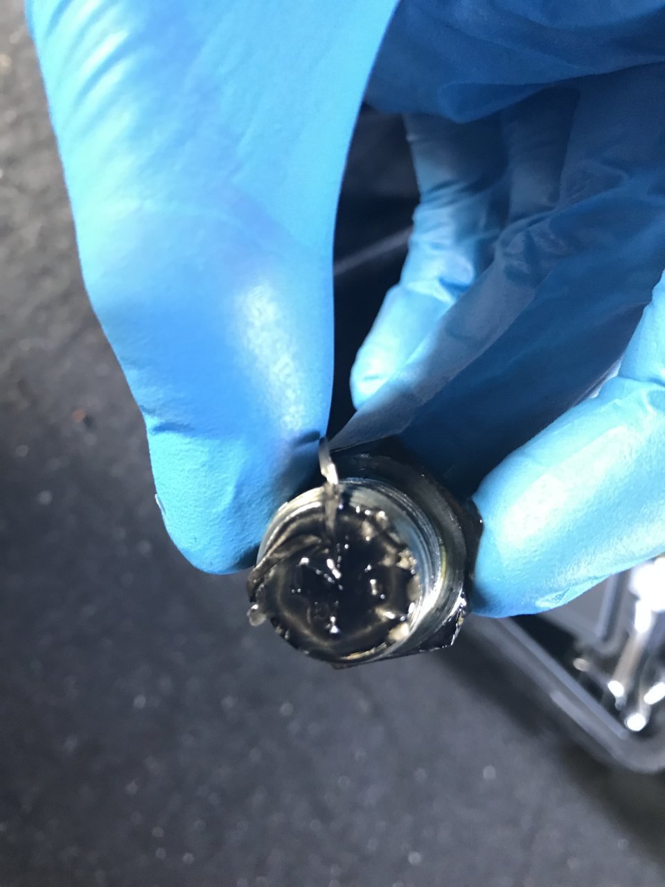

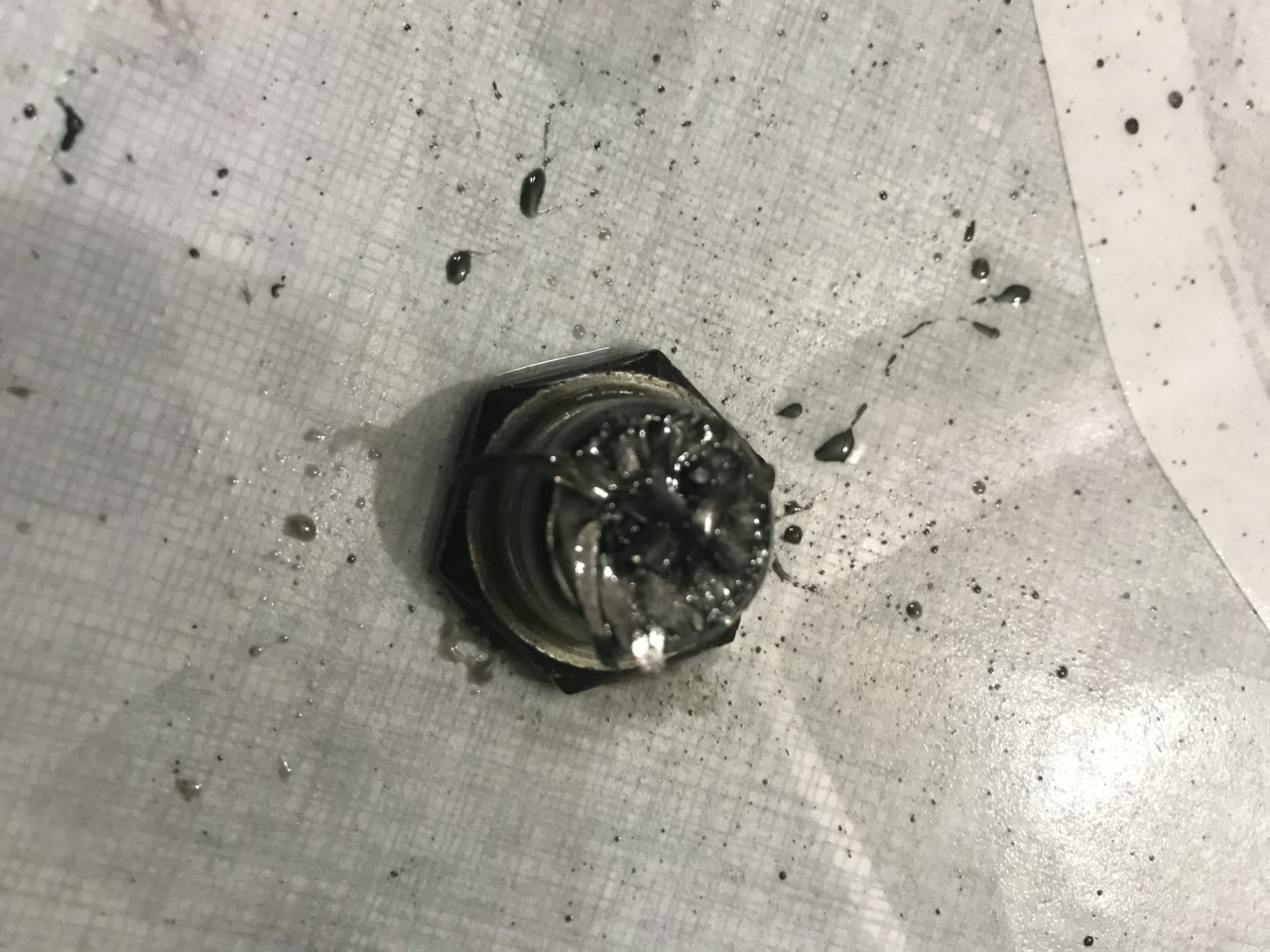

    Curious if they are quieter now? Maybe after getting new oil in and getting the crud out will help. I've heard it's normal to have some metal particles but that seems like a lot but what do I know. I would send that pic to Nitro or Rogue Off-road and see if they have any insight. Maybe gears are fine now.
