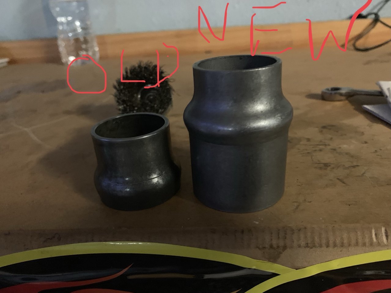

    Got tired of waiting so I decided to just put them in myself. Plus we figured out my front 4.30s would of Grenaded. Saved them in time tho. 4wp didn’t tighten the front crush sleeve down enough. :crazy: We saved it in time tho. Should finish up tomorrow.

    Rogue sent me the wrong crush sleeve for the front. Kit was open when I got it. Wasn’t too bad though. About three after work days. I’ll finish up tomorrow hopefully if I can get the right crush sleeve.
