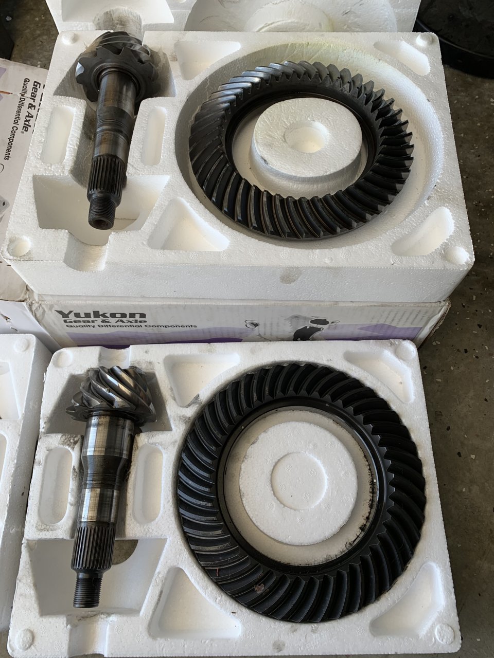

    Yeah. We pull the lower ball joint bolts, pull them out so we can pop the axles out and then drop the front. Usually a 2 hour process with pulling the rear. Done it a couple dozen times now.
    Also I’m not planning on going back to my 4.30s if anyone is interested in them. Ran them with my 33s cause it’s stock ratio. I would avg 17-19mpg depending on how much highway I’d do.
    Not sure how the turbo and super chargers are going to like the higher rpms but I’ll deal with that bridge when I cross it.
