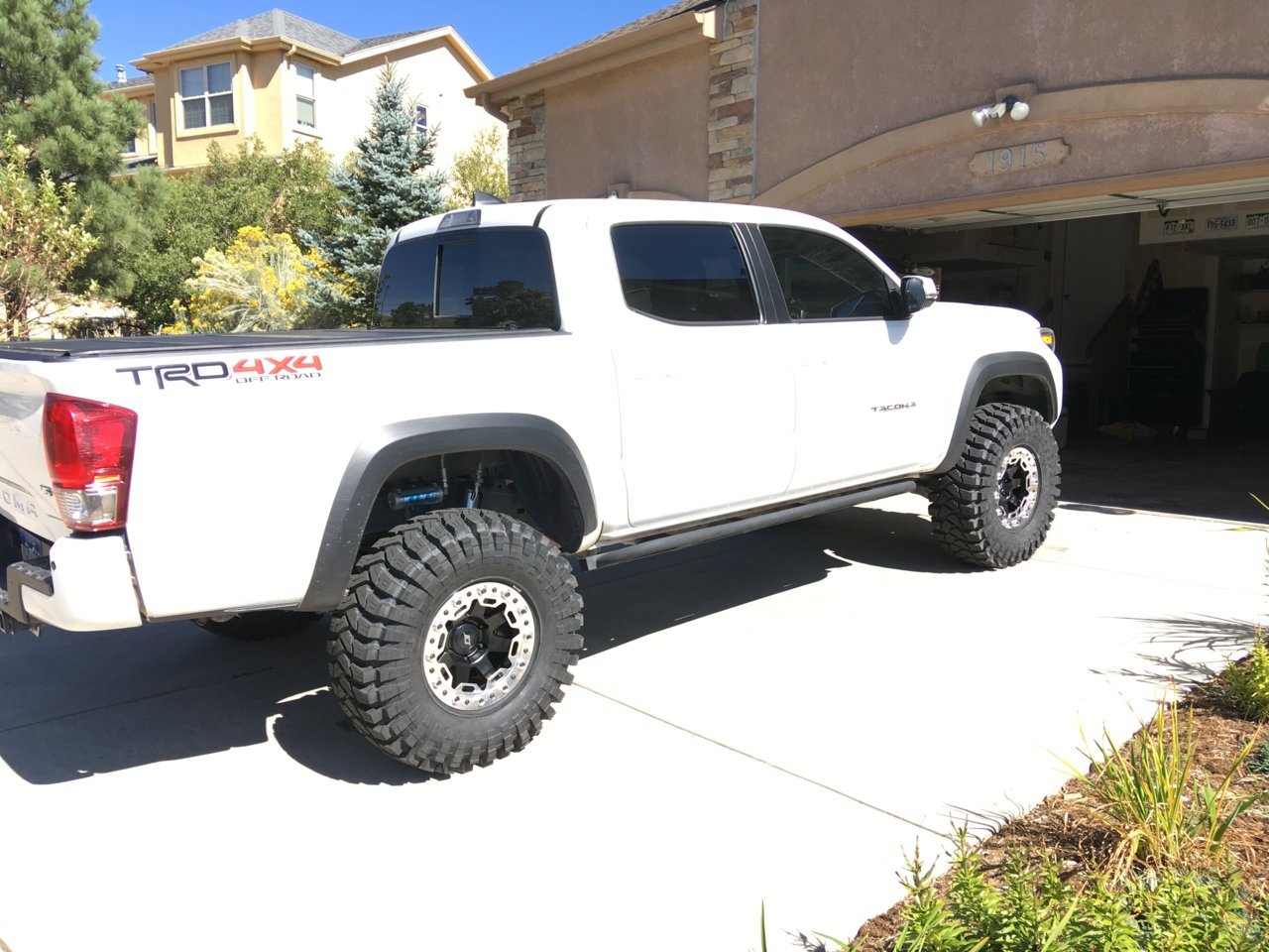

    Girthy! You sure there are SR8's underneath there? :D
    Looks good though!

    So much badassness

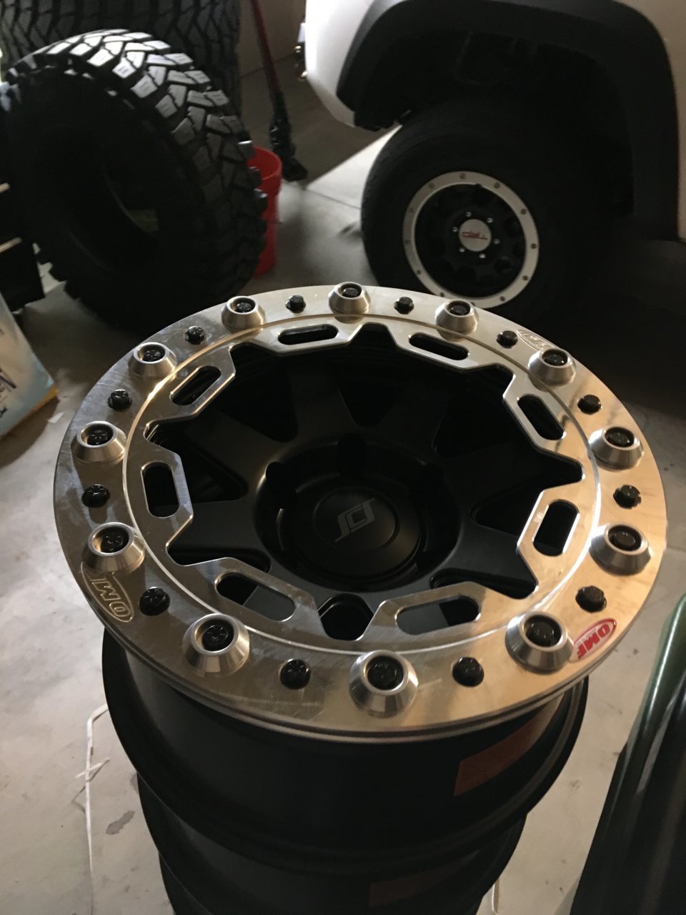

    Honestly if I was gonna go and seriously bash my truck I would love a set of OMF modded te37’s. But my bank account says dream on.

    She bad! :bowdown:

    Looks great, what are the specs on the rims? Backspace, wheelspacers?
    Edit and I’m seriously considering 5.29 with 35 with a 17 v6 auto, any update?

    Nothing so far but I need to trim the front bumper. Ultimately I’ll be getting a full replacement. It only rubs the front at the moment.

    SCS SR8s 16x8 4.0 BS and -12mm offset. No spacers but I’m running a 3” lift and currently set to +3 caster.

    Have you stuffed it? I feel like I'll need to trim the fender a lot so I can get full stuff without destroying the tires. I got a new plate bumper recently so I'm going to try to push my caster forward even more now for clearance from the pinch weld and CM.
