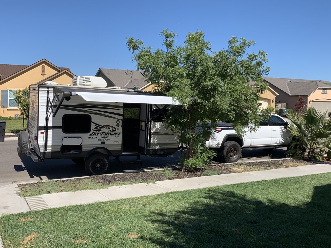

    Is there anyone at all on here that tows a travel trailer with 5.29's or 4.88's for that matter that I can ask a couple questions?

    I know a couple of the guys do. Mine is only like 3000 lbs

    Right on. I’m very curious how the truck behaves towing on flat to slight uphill around 55 mph if it’s got any pull in 5th around 2000rpm or having to downshift to 4th up to 2900rpm. My trailer is around 3400~3800lbs

    If I do 5th it doesn’t shift for me. I don’t hit 4th till I do the mountains. I’ve got one trip on the gears with the trailer tho and I took it easy.

    awesome to hear, how much does your trailer weigh and what tires are you running?

    3000’ish. I’d have to go look again. I’m on 285/75/16 33s with armor, half bumper and winch
    Wanna say @JoeCOVA did a long trek recently on 33s.

    Awesome info, and nice looking Jayflight I was looking at that trailer for a while actually. This is very comforting as I was worried about cruising down the highway for a long time in 4th at 2900 and wasn't sure after the re gear it would have the power to pull steady at 2k down the flat highway without wanting to hunt down or heat up the tranny. My rpod is actually 3k dry so prolly close to 3600 loaded depending on what we bring along. My completely stock truck cant hold it at 5th down the highway at 55 now I just use 4th at about 2500rpm and it's solid. Thanks for the info I think 5.29 will be the way to go for me once I lift and go with the 33's
