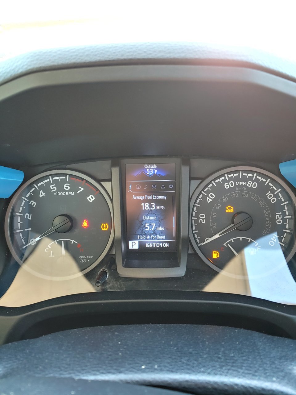

    Installed gears yesterday! Never made it over 14.5 mpg with stock gears (and 33" tires)20190914_075055_HDR.jpg . First little trip with economical driving and I'm supper happy. I'm going to wait 500 or 1000 miles before hard accelerating.

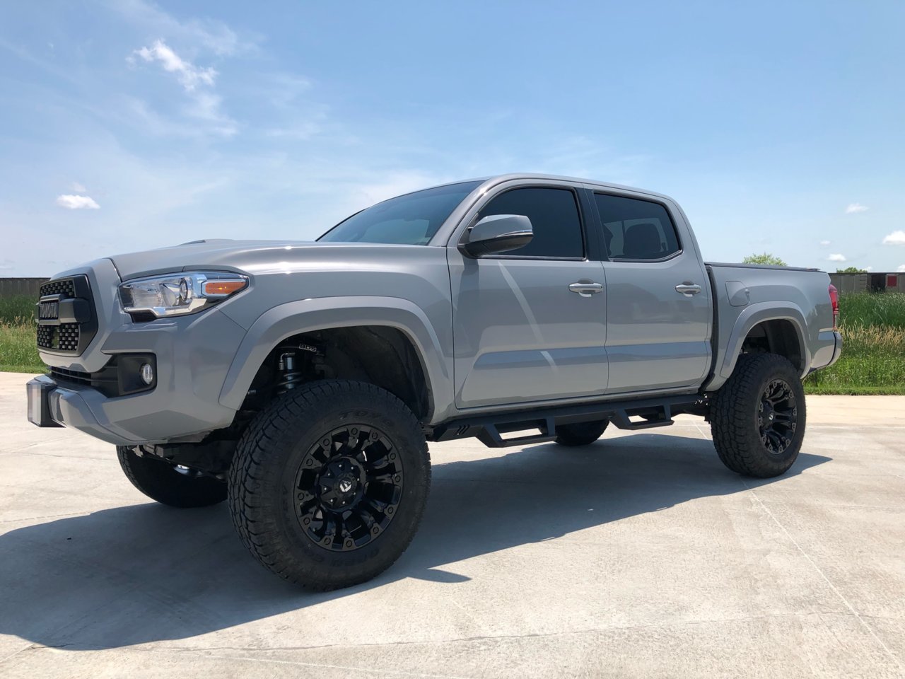

    New here,
    I have been trying to sift through this thread but am still new to all this Taco mod stuff. I have a 2018 TRD Sport with 275/70R18 tires and a 6” BDS lift. Currently trying to drive interstate consistently wants to downshift to 4th running 3000rpm constantly and will not stay in 5th. My MPG is pretty bad in my opinion at 14mpg now but cannot remember what it was before with stock. I’ve been told by the place who did my lift that a regear with 5.29 would really improve the gear hunting and MPG. From all the videos and posts discussing these gears I’m pretty convinced this will help me out tremendously as well. I also have an OVtuner ordered hopefully shipping next week that might also help. I am just looking for some opinions on all this with my set up and how regearing with 5.29 will hopefully improve the performance and MPG of my taco. Thanks for the help! DF4AF3CC-9250-439F-8C8D-25EC6D48AFD3.jpg

    OVTune will probably help you out a ton. You are not running a ton of weight or a significantly oversized/heavy tire, which is what the regear will MOSTLY help with. It will most likely help to some degree, but I am not sure how much. Your style of lift is not one I have much familiarity with, so I am not sure if you are facing some significantly decreased aerodynamics or not.
    I have 5.29s on 33s [originally] and 35s [now] as well as a ton of weight/armor/lack of aerodynamics. I found the gears to be helpful in maintaining my previously elusive 6th gear at highway speeds.

    5.29s will be a big help. Anything thats not stock will like 5.29s

    I think i will give the 5.29s a go! I appreciate both of your insights on this.
