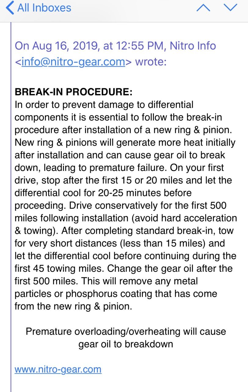

    Break in question:
    Had my gears in for 300ish miles now, likely to be around 450-475 by Saturday.
    I want to head up to the mountains for a 14er, its 128 miles one way.
    Should i do this? If so what precautions do i need to take? I will not have fresh gear oil by Saturday.

    I live up a mountain and traveled up and down it (10 miles each way) every day during break in. Once you hit 500, you should do the oil change per manufacturer guidelines. My gear fluid wasn't changed until around 800 miles tho, and my gears are fine. Its the first 3 heat cycles that are the MOST important. Id say you could go, just take it really easy. But remember, its your truck, and if you want to risk it its your call. I wouldnt wheel it until you change the fluid though.

    seems like nitros main concern is for people not to start towing right away... other than that don’t floor it and you’ll be good!

    Ive been gentle on them thus far. Whats a hard acceleration? Red lining it? 5k? 3k? I’m not dragging it but i did have to hop on the pedal today to avoid trouble.
    No wheeling this weekend, nothing more then a forest road. 2wd all day.
    I may be able to do a quick oil change, looks like it should only take 15-20 minutes.

    If your heat cycles are done you should be ok for normal driving. Just change the oil when you get back.
