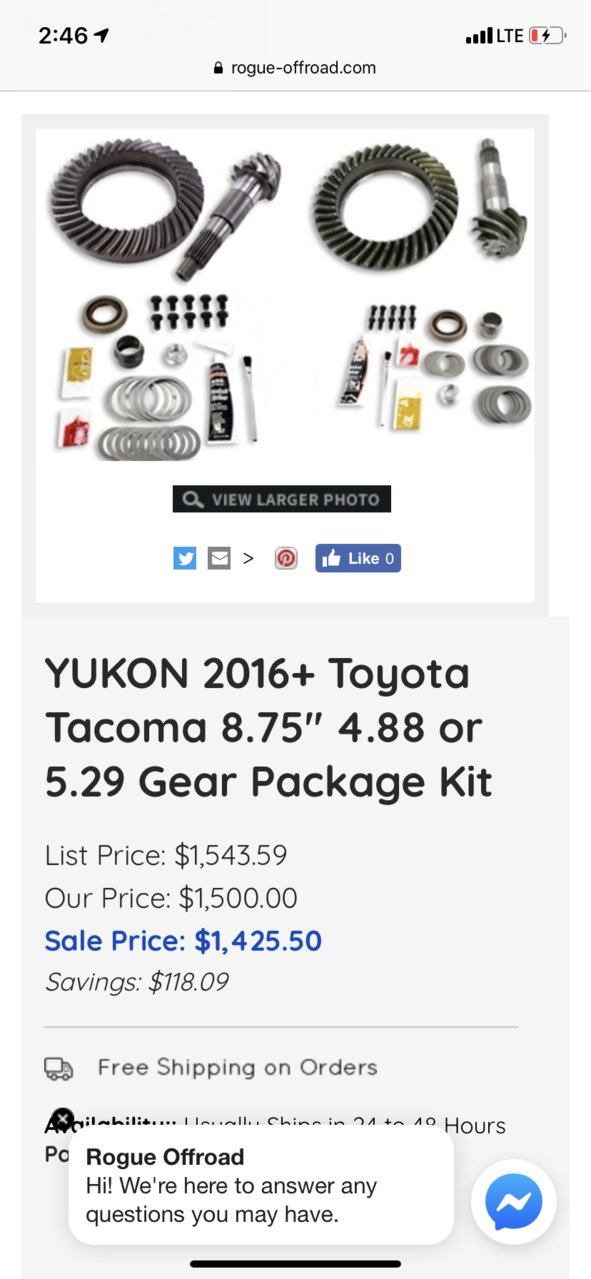

    I would get OEM Toyota pinion seal for both front and rear instead of the yukon seals.

    Do you happen to have the part numbers for those? Is it the same seal for both front and rear diff?

    Rear pinion seal is different than front. Your local Toyota dealer ought to be able to get you the correct part #'s.
