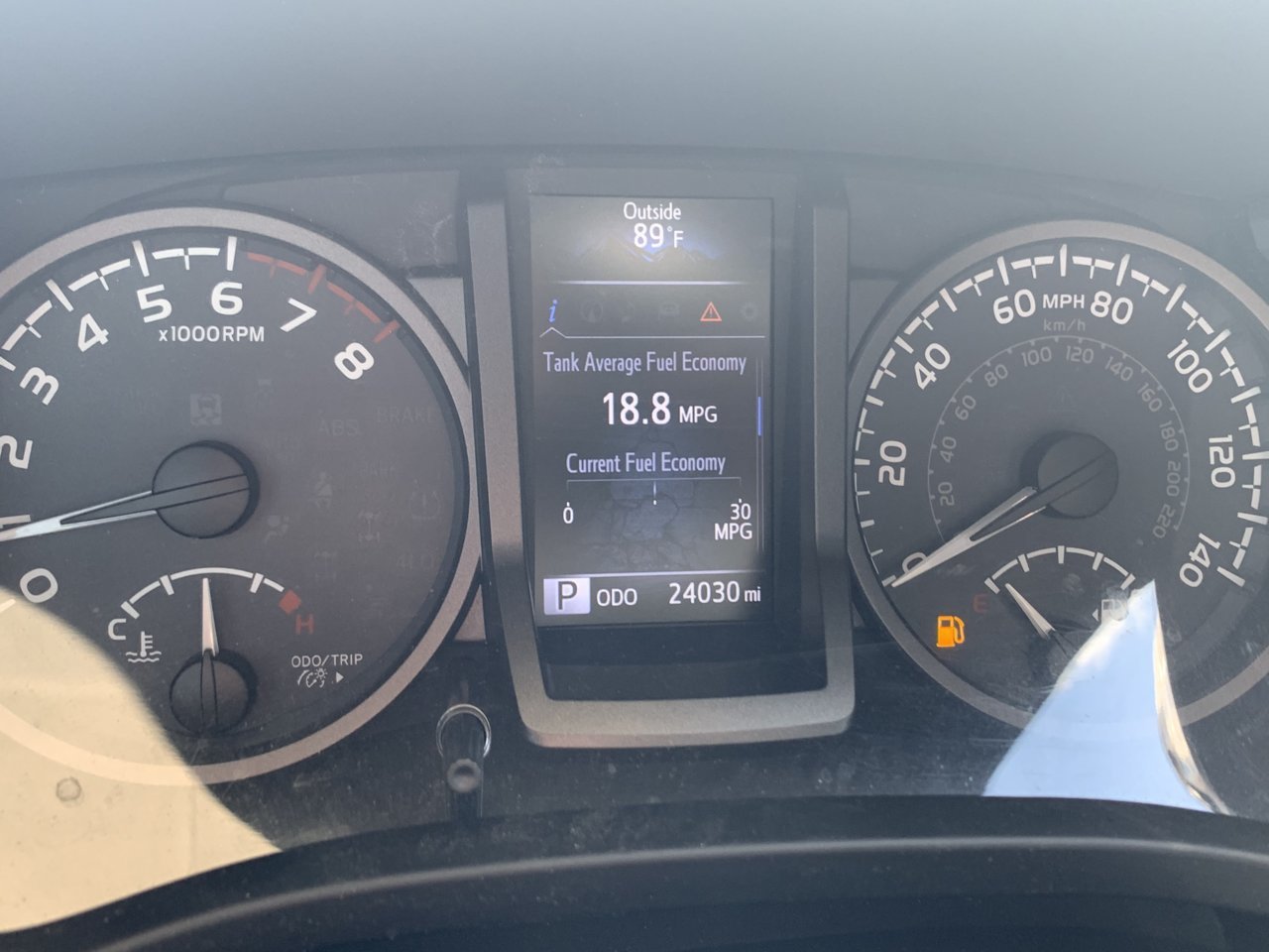

    Well I’m super happy with my truck now. I installed 5.29’s from ECGS. The drive is so much better and I don’t have the downshifting any more. My TRD PRO is stock plus 285/75/17’s this is my MPG driving in and around town with normal freeway driving
