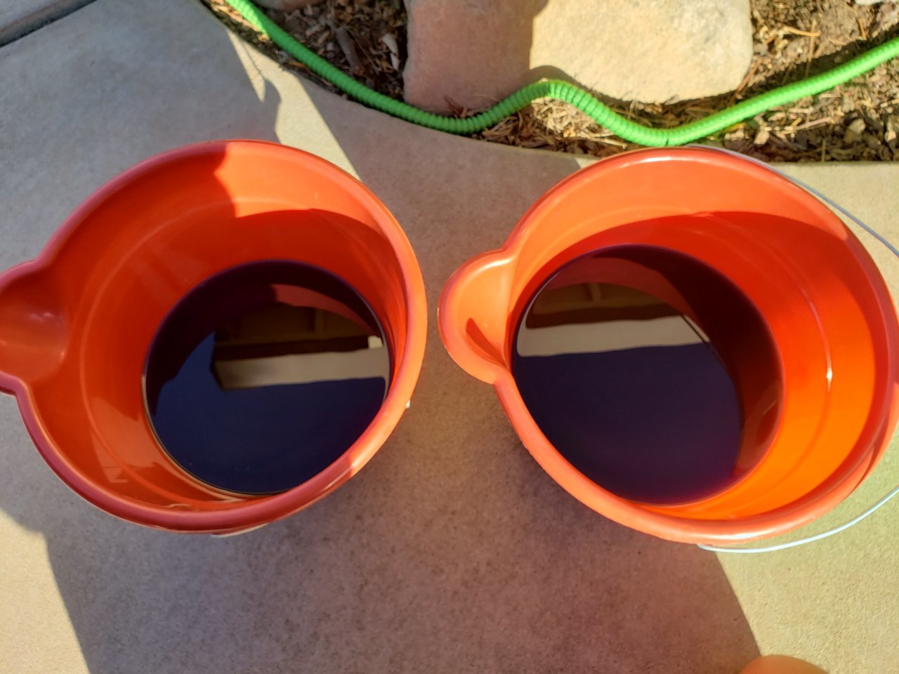

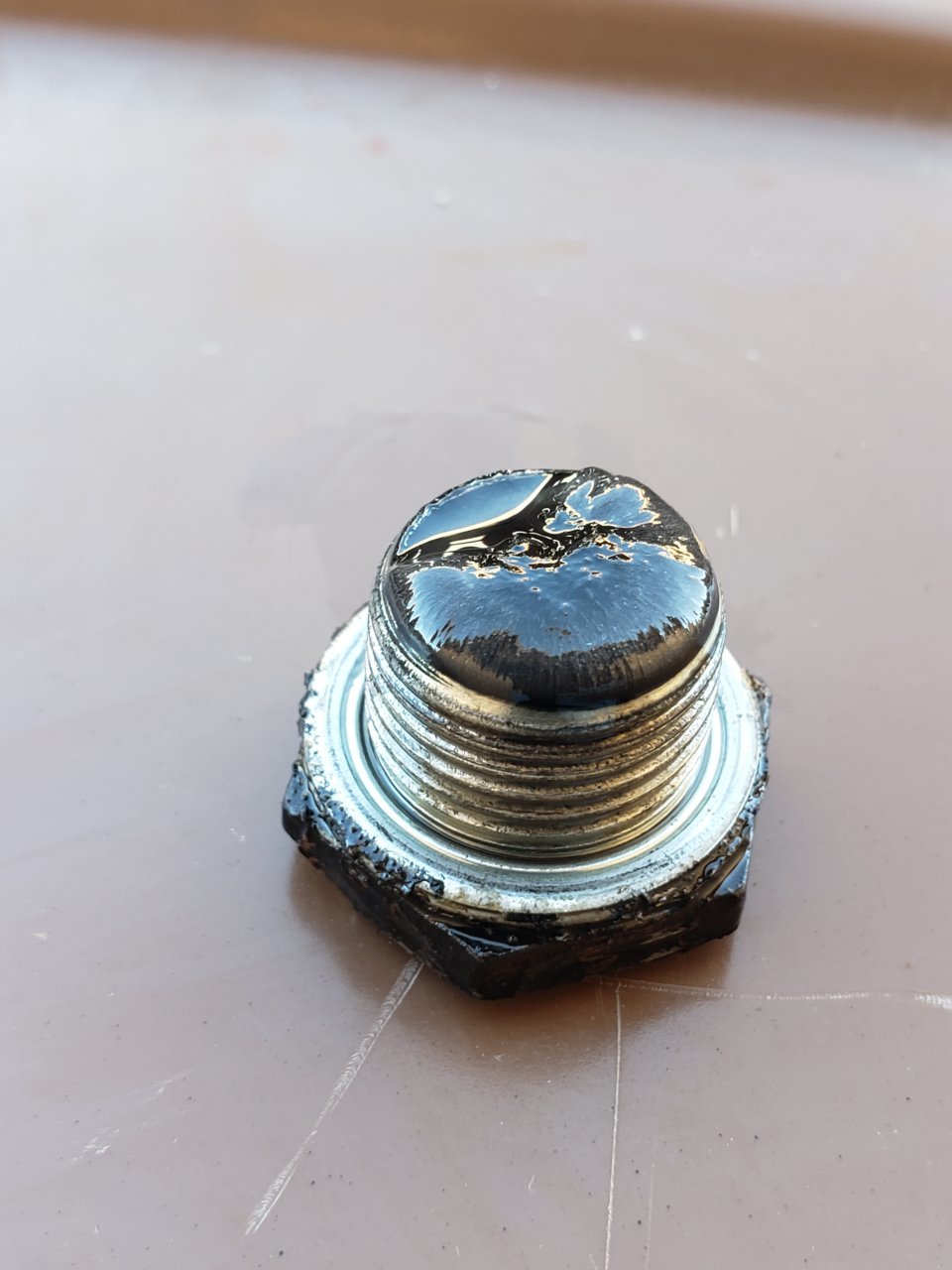

    Small clue maybe? I changed my factory differentials oil yesterday at 4K, was pretty black.
    Rear plug, I did smudge it.
    Left is MT oil, right is the rear differential oil
    The front differential oil was similar.

    The front shouldn’t be as bad if I’m not using 4wd right?

    No it shouldn’t since it’s not under load. How does the front look?
