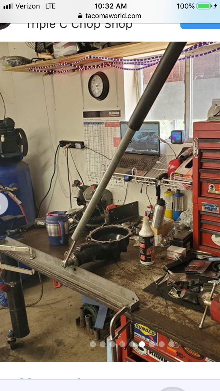

    For anyone regearing, I would highly suggest throwing the nitro pinion seals in the trash and using genuine toyota pinion seals.

    Takes close to 230ft#'s to begin crushing the pinion sleeve.

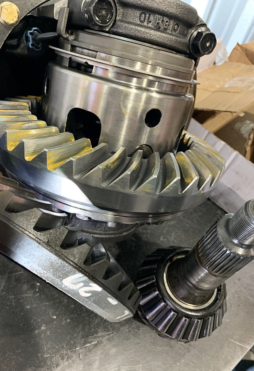

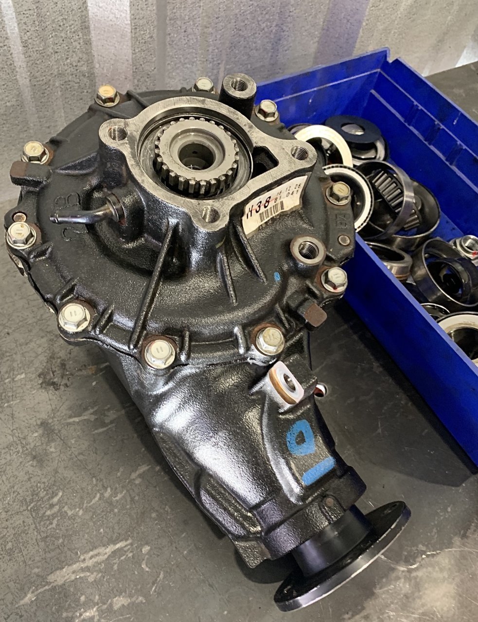

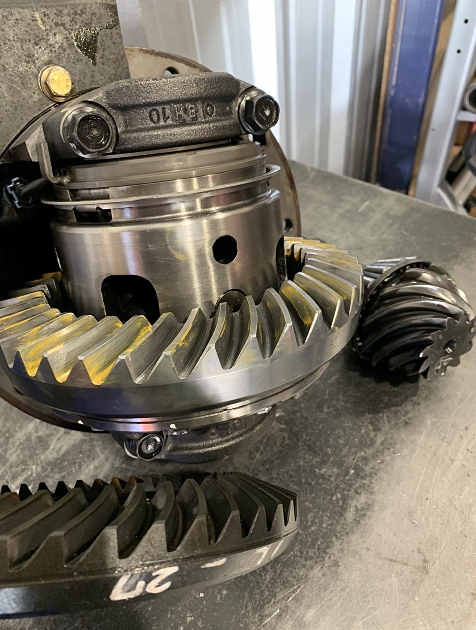

    Some pics from yesterday.
    Below: Factory rear Vs 5.29 REM
    Front

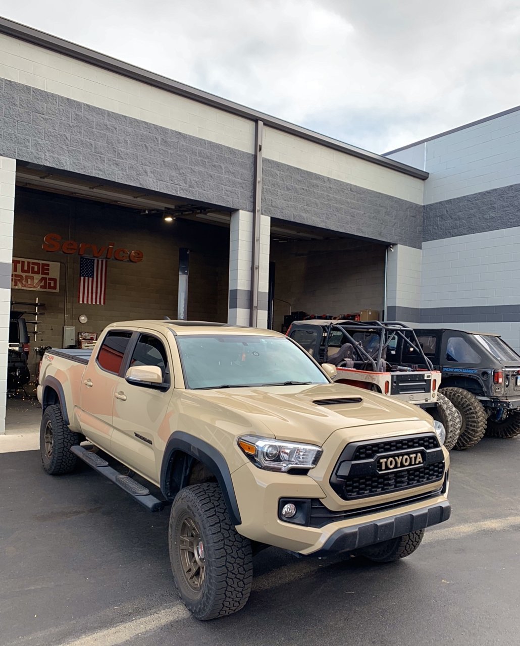

  13. Oct 14, 2019 at 4:58 PM
    #1473
    Tibetan Nomad
    Tibetan Nomad Well-Known Member
    Dec 9, 2016
    #204436
    905
    2016TRDOR:DCLB:JBL
    NitroGear5.29,B6112,.25"spcr,SPC:UCA,Diff-drop,ECGS
    B5160,Dakar-HD-leaf-pk+OL,UBolt-Flip,33s,Superbumps
    Done deal! Picked up the truck few hrs ago. The shop did the initial 1st break-in. I just completed the 2nd & 3rd break-in in BEAST/Grandma mode! Now at a local gas station letting it cool down for 30min.
