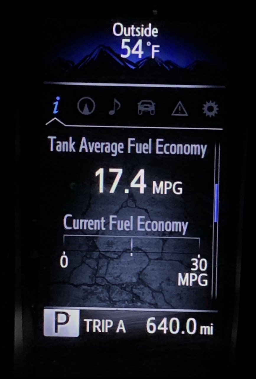

    I’m more than 100% happy with the 5.29 on my Auto/33”. No armors, just weight of a tonneau cover and about 40 lbs of stuff in the bed + a 33” tire/wheel under the bed. Just went outside to take pic of how many miles I’ve put on the new gear. 640 miles so far, just been taking it real easy, babysitting the new gear and even then the truck now drives so effortlessly. It’s so willing to go forward even when I’m just lightly stepping on the pedal. Can’t wait to feel how it drives when I really step on it and looking forward to a slight bump in MPG. Damn! I now really enjoy driving my truck. Will post more updates down the road.
