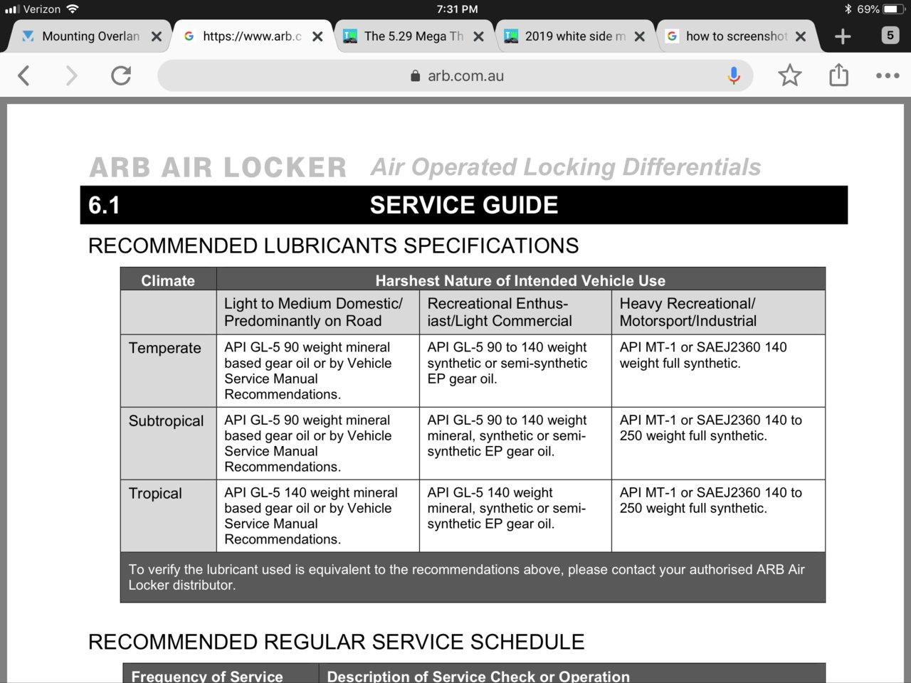

    Here's what I'll be using depending on where how hot the climate is:

    I probably will run Amsoil 75W-110 in both or 110 in back 90 in front. I could be convinced to go 75W-140 rear and 75W-110 in the front. TBD.

    Valvoline synthetic 75w90 in the front diff and transfer case, 75w140 in the rear for me. There’s more oil info in the 4.88 thread if you’re interested in reading more.
