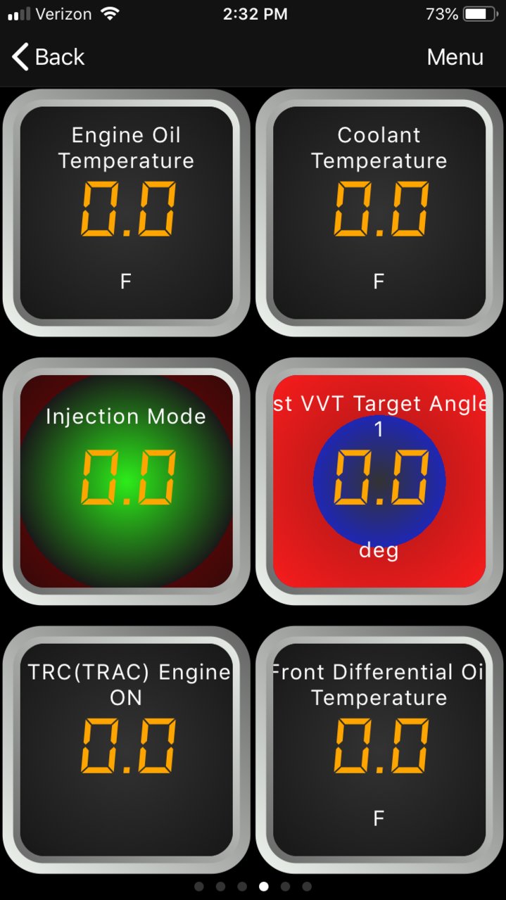

    Or you can monitor the front diff temp with OBD fusion or any other similar app and Bluetooth device. Temp goes up in 4wd.

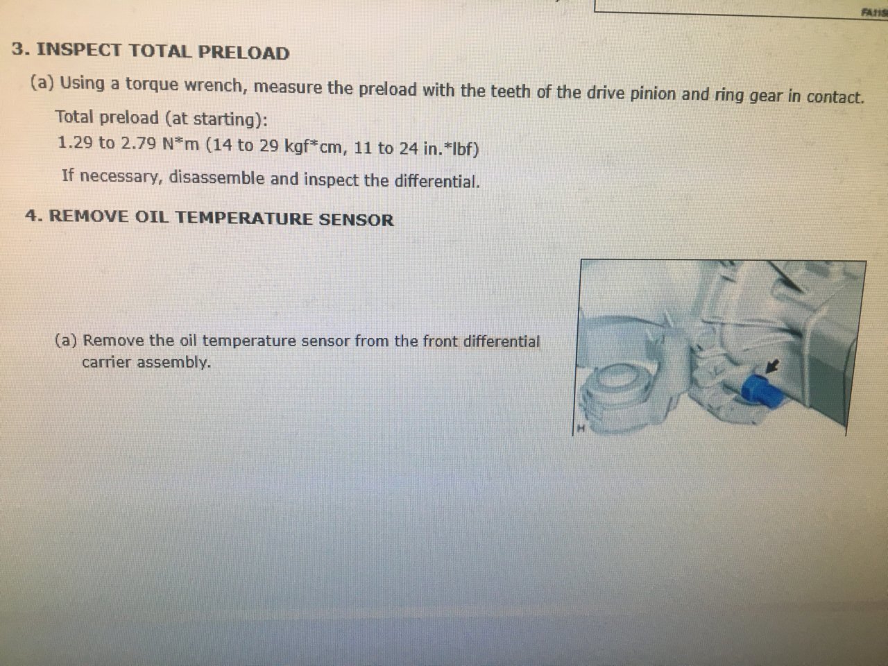

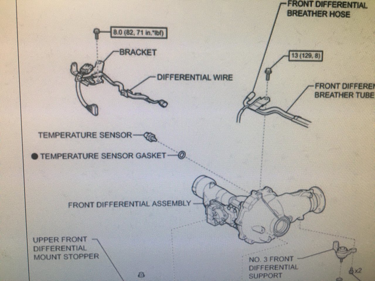

    I didnt know that there was a temp sensor in the front diff. Wheres it at?

    It measures oil temp, throws check engine light if temp gets too high.

    Bottom right is front diff oil temp.

    Is there one for the rear diff and t-case? :anonymous:

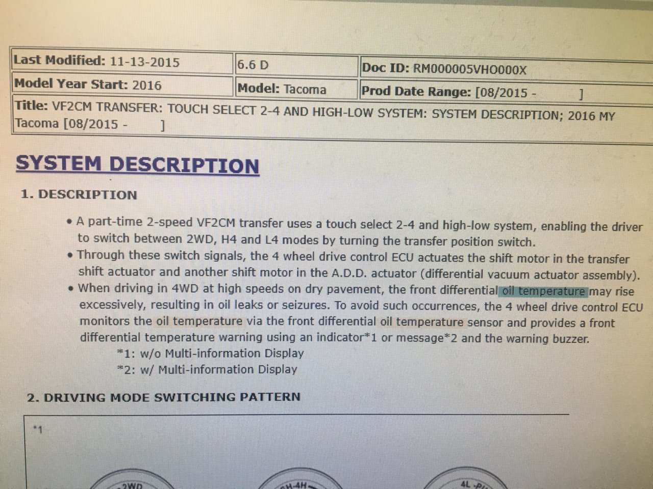

    I don’t think so. Here is the reason for front diff sensor, to protect front differential from damage from high temps from use at high speed on dry pavement.

    Ah yes, new to 3rd gens. 2nd gen didnt have that. I wondered what that little sensor was. Thank you.
