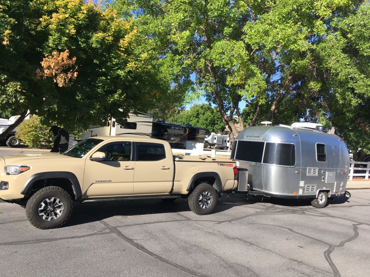

    Mine too. I towed a 16 Airstream (3700lb trailer 450 lb in bed)) to Yellowstone from SLC then to Grand Teton and back to SLC over a week. Did really well.IMG_3172.jpg IMG_2830.jpg IMG_3067.jpg
