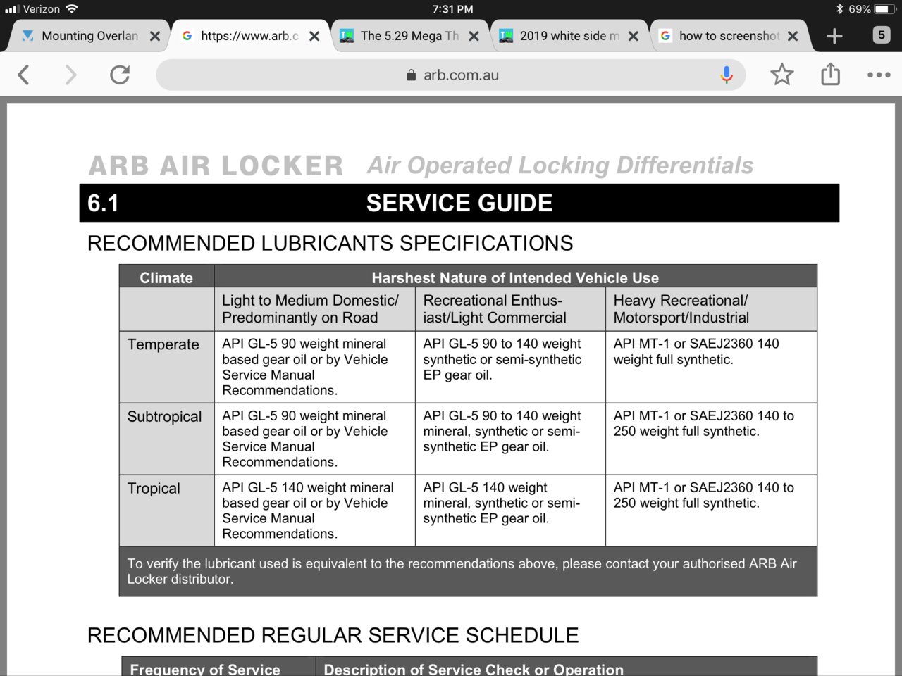

    I have posted this before but since the topic has come up again here is what ARB recommends for their locking diffs

    Heat kills oil. Higher viscous oils such as 85-140 have a wider operating range when it comes to temperatures and thus more forgiving to premature breakdown.
    This is why we see oil change intervals for 0w-20 at 10k and 10w-40 at 25k and so on and so forth.
