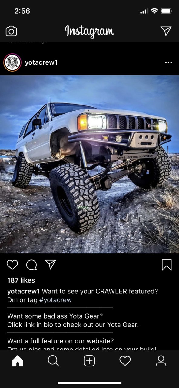

    It was your bumper on IG that led me to paint it the way I did. This pic is from today but it’s been on yotacrew before maybe?? I’m 3.go_t8y8ta on IG.

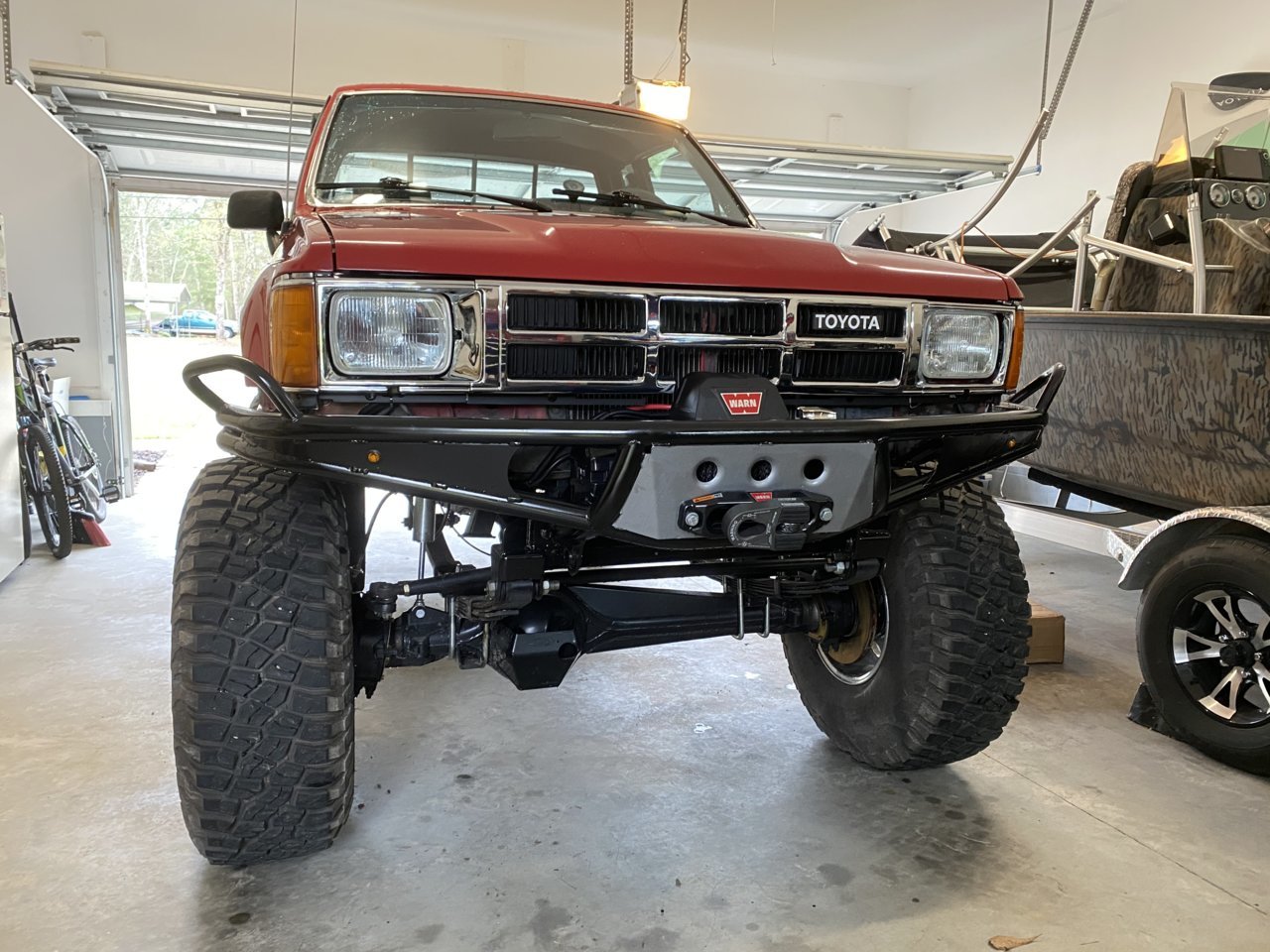

    Got the winch in there by using an 84-86 style grille from rock auto.

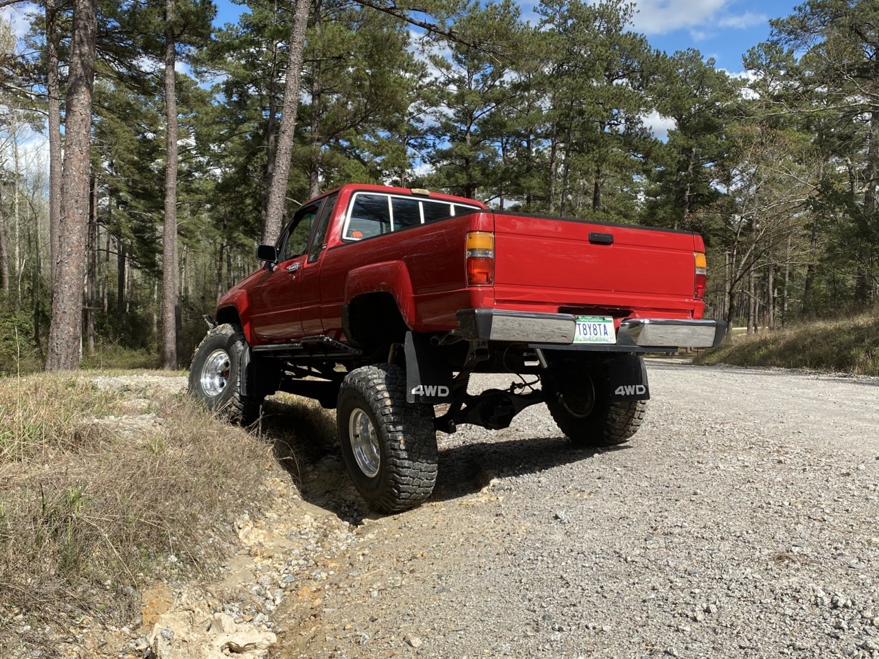

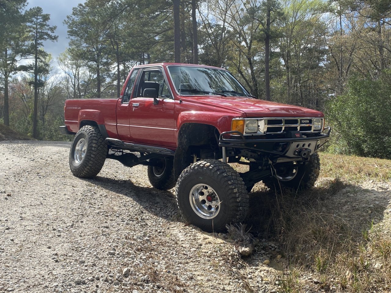

    Boredom therapy driving dirt roads and pine stands.

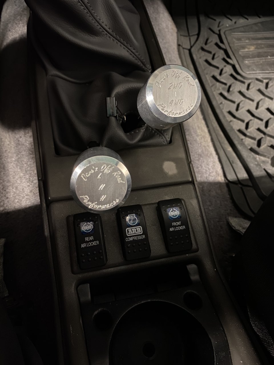

    :turtleride::taco:
    Marlin 4.7 gears. Dave’z twin stick.

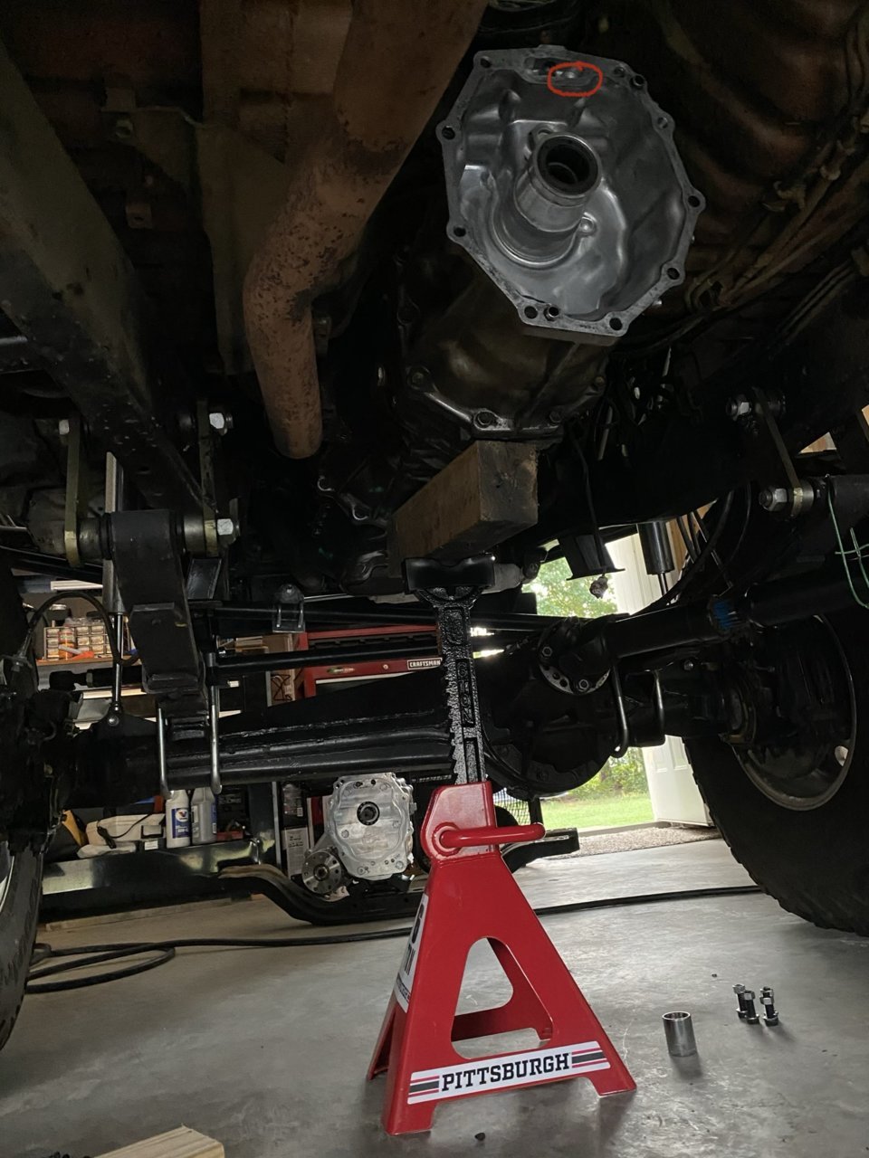

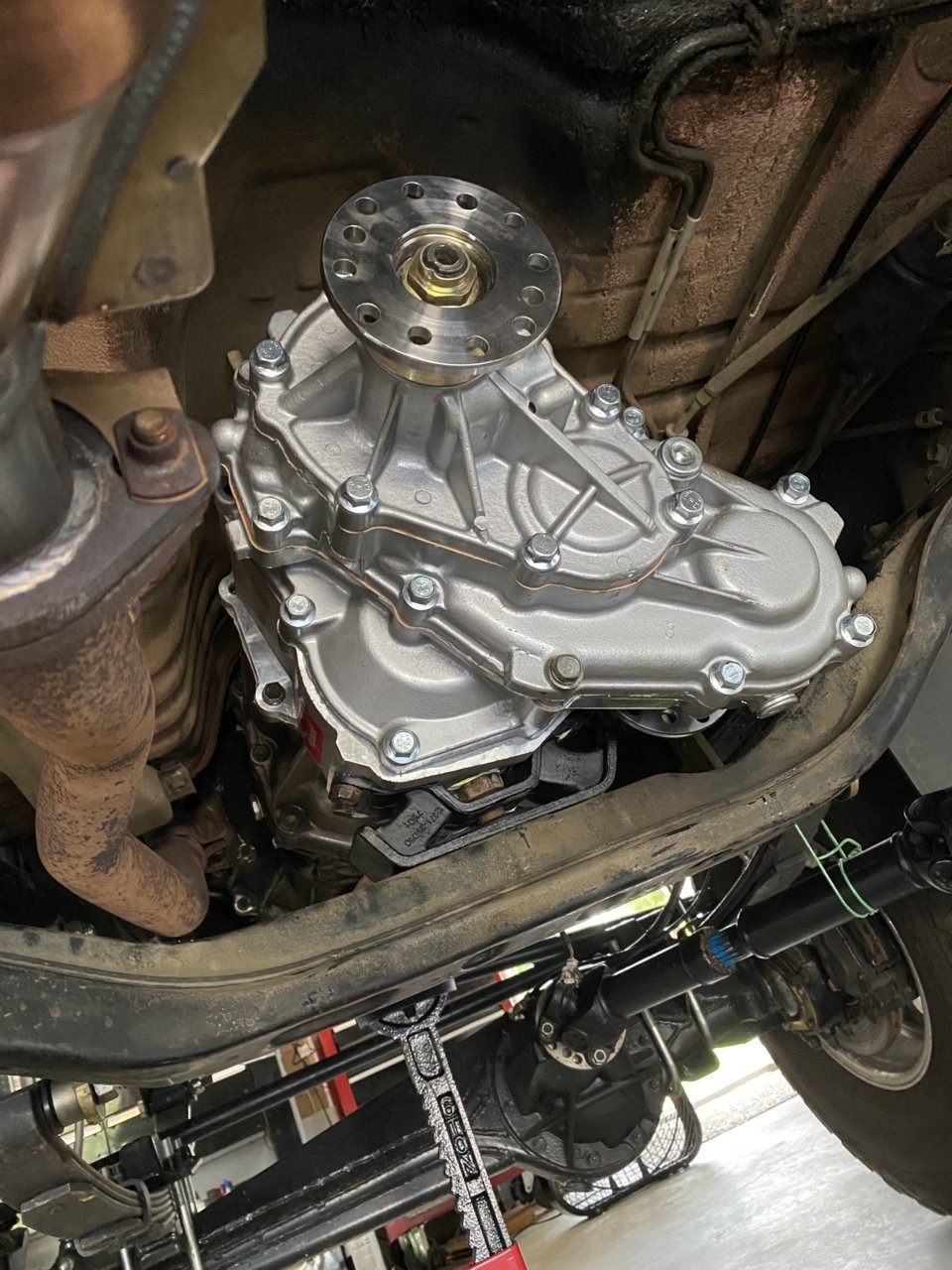

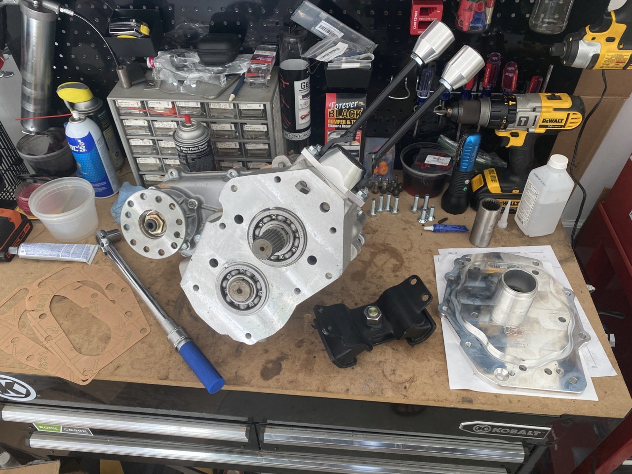

    Pain in the ass! But it’s stabbed.
    I put a red circle on the picture of the tail housing because if you don’t notch that and trim 1/4” from the 2wd/4wd shift rail, you’re going to have a bad time. Hoping by posting this anyone trying to do a single 4.7 Tcase behind a 3.0L will search and land here to ask questions. It was a bitch test fitting so many times to get it right.
    If you don’t trim the shift fork and notch the tail housing it will not shift into 4wd.
    15A0817B-592F-4E20-A0D1-172825672540.jpg 00605FB1-C2A4-409C-94EF-F3537AB9BCCF.jpg

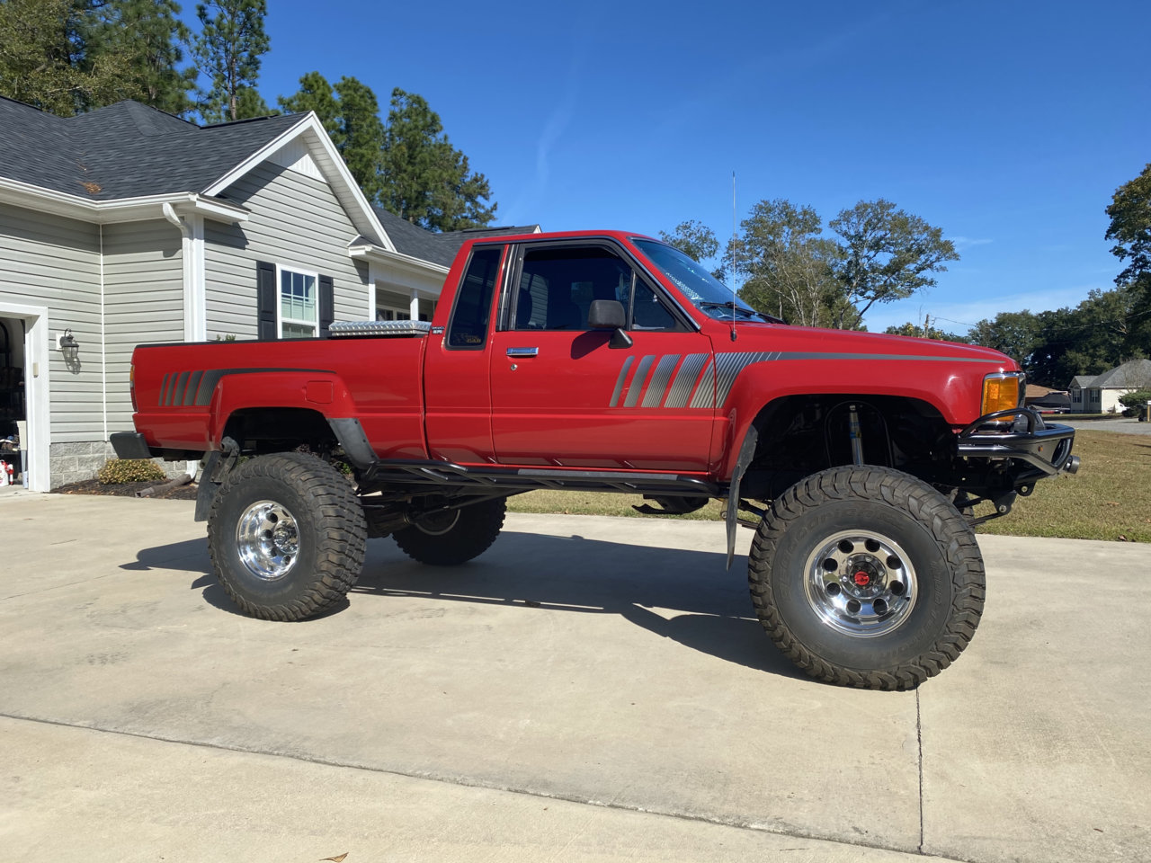

    80’s decals are the best. Model/year correct.

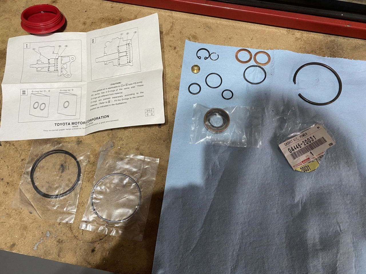

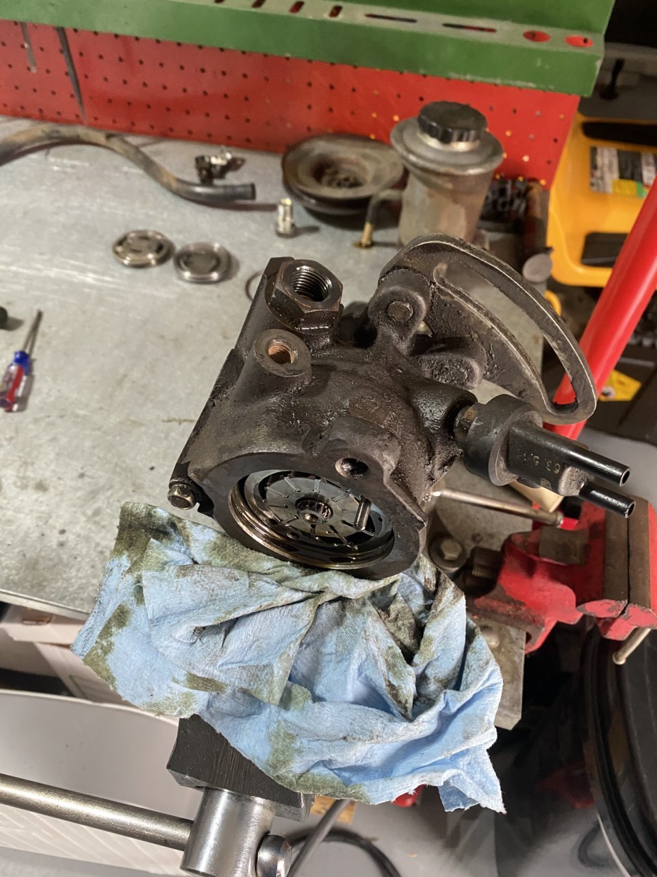

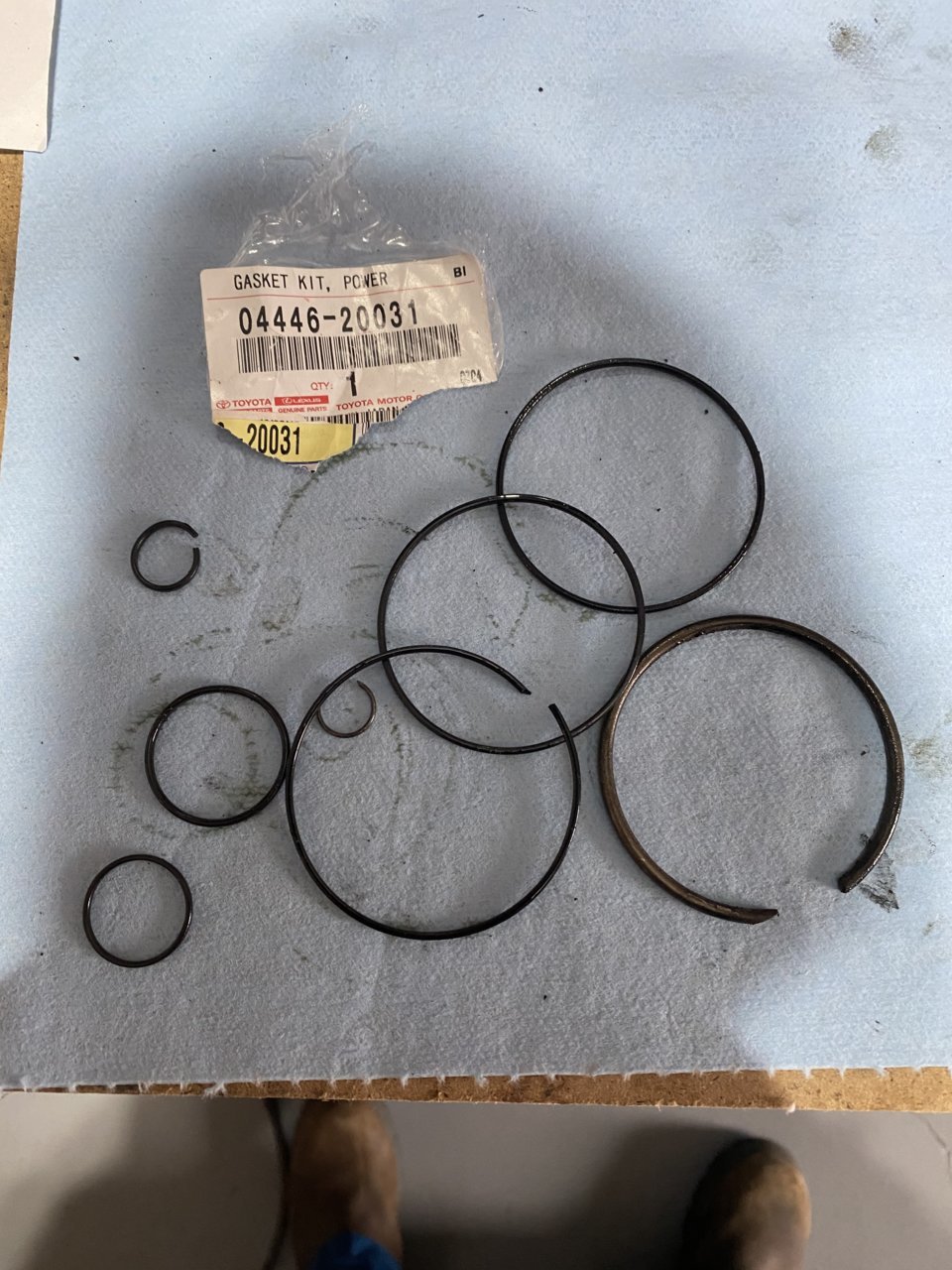

    Power steering pump rebuild. The old seals were not in good shape. This should fix the leak that it had.
