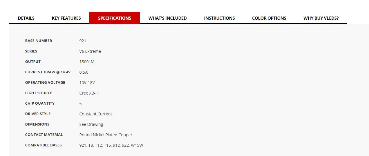

    So I've had the HIR's in my Tacoma for quite some time and love them! I've put the HIR's in 2 other vehicles over the years now too with great results!
    I noticed these came out a little while ago so I just ordered a pair of the 5k, I plan on putting them in our Subaru Ascent. I'll take some photos to compare when they come in. I don't have a lux meter unfortunatly to get any numbers, but you'll get an idea of how they look. My buddy has them on his 2020 Legacy and they are quite amazing!!!
    They are rated at 1500 lumens per bulb. I know VLEDS doesn't specify that on their page, but LightWerkz and a couple other retailers show that it's rated 1500 lumens per bulb and not combined. This note is in the details tab - WARNING For reverse lights only. Installing this product in a constant on application like daytime running lights or parking lights will void your warranty. So clearly they are running on limit and likely will dim as it is ran longer for heat management. Obviously I don't know the rate of dimming and there are far too many conditional variables to make that concrete anyways.
    https://www.vleds.com/shop-products/v6-triton/v6-triton-extreme-kit-w-921.html

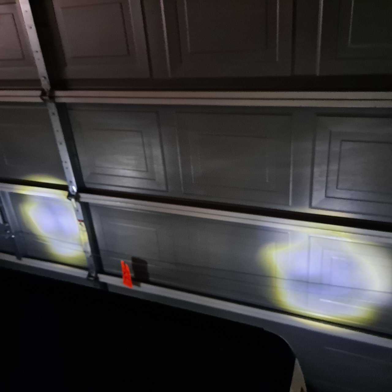

    The 35w Gy6.35bulbs were a total fail for my truck and melted the lens from the added heat.
    Now my lens is distorted
    The X-VF are so bright they are almost like a mini projector flood light

    Wow, how long did you leave it in reverse? I have the same bulbs and no damage that I can see but then again I’m in reverse for 10-20 seconds max
    1997tacomav6[QUOTED] likes this.

    Not very long, I bought those adapters for the sockets and thats probably why,
    The new bulbs have very little heat coming odd them

    Man sorry to hear that. I had tested them for something like 30 minutes of continuous use in reverse without issue. But if the adapters put the bulbs too close to the lens I could see that potentially being a problem for extended run time.
    I have no doubt those X-VF are bright, though they don't look to do a very good job of uniform light distribution.

    Well I have get new lens to get a correct footprint because the plastic is all warped and deformed now.
    The way it is now the New bulb in more light a headlight And 3 times brighter or so it seems
